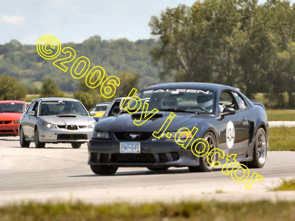

As I'm going thru my 2001 Saleen for the start of some winter projects Transmission, Clutch, Intercooler I noted the front suspension bushings have some significant wear. So now I see the need to replace them. Can anyone make some suggestions as to upgrading the front end. I do like being on the open track road courses.
Thanks
Tas
2001 #434
Series IV S/C +++, JBA ceramic headers, 3:73's, BBK subframe connecters,
Pro 5, plus, plus
