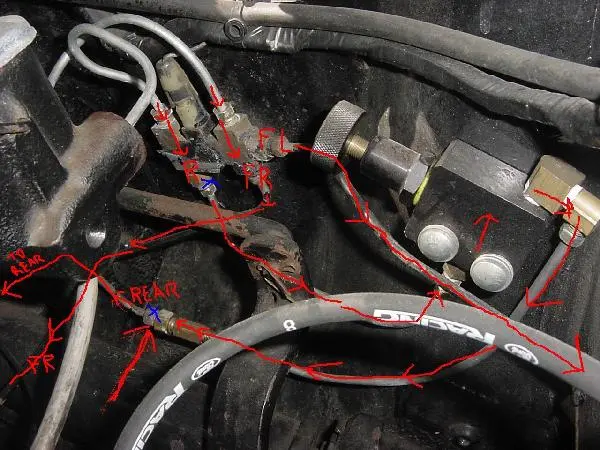

mfp4073 said:
I have a bigger version of it too if needed. Thats not a line lock though, its an adjustable proportioning valve from wilwood! :nice:
Quick question for you. If you are running the Wilwood proportioning valve you don't need the non adjustable one that you have pictured right. I was planning on running a Granada setup with just the Wilwood proportioning valve.
monk302....you are correct. If you run the Wilwood proportioning valve you will not need any kind of factory proportioning/distribution block. Go to a trailer supply store and get a simple T-block used for trailer brakes and use it to split the line to the front brakes. Doing it this way results in a very clean and uncluttered install.

Thanks Ronstang, thats exactly the way I had put it together. I was beginning to worry that I would have to take my setup apart. It does provide a really nice uncluttered setup though. For some reason, people were amazed with the Wilwood proportioning valve when I had brought into the store. Everyone that saw it wanted one installed on their car and examined it thoroughly. I guess we Blue Oval guys are just that much more advanced over the Mopar and Chevy guys.
