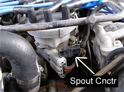

3. Do I have to disconnect anything before adjusting the timing

3. yes you need to pull the spout connector.
