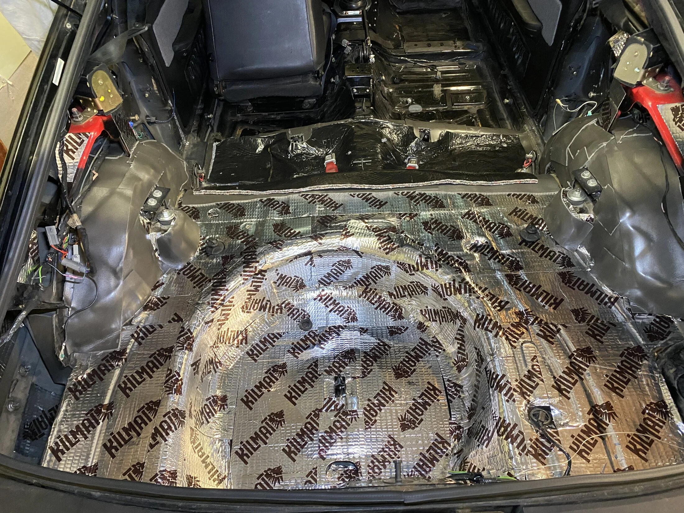

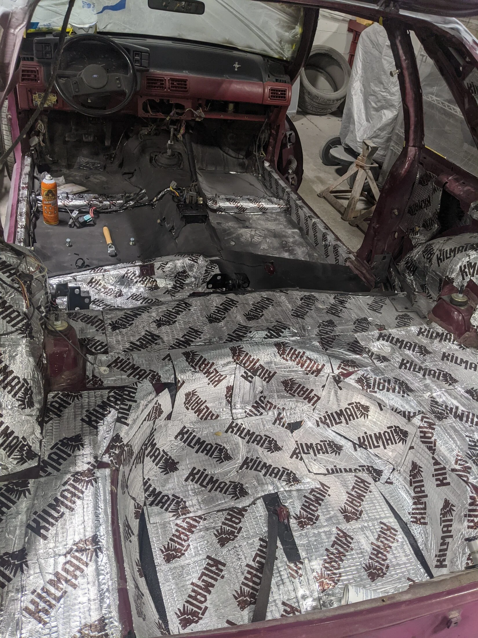

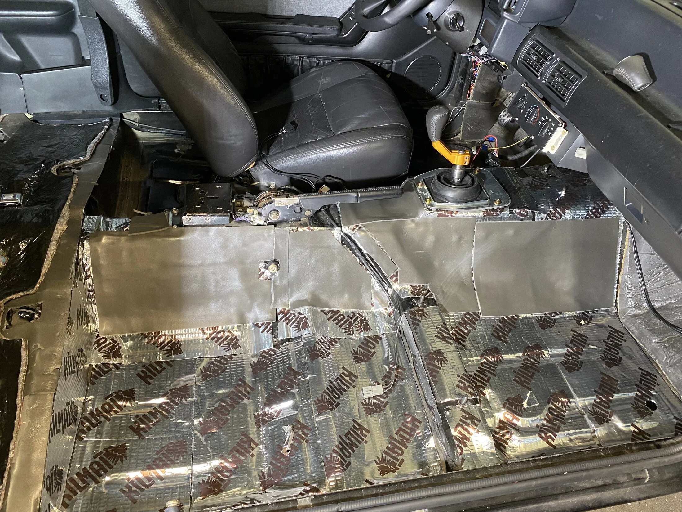

Kilmat all over the floor, hatch, roof, doors and quarters. Also installed noico foam on the trans tunnel, more for heat than sound.
Made a huge difference especially with the windows up. It sounds like the exhaust note it outside the car, and not inside.
You don’t need 100% coverage, but that’s how I installed mine.

I bought mine pre-Ukraine, but looking on Amazon it seems prices are up on that stuff. Also seems to be less selection. I bought both the 50mil and 80mil kilmat, and some noico 150mil red foam. I only see 80mil kilmat and don’t see the noico red foam at all.
I used the 80mil kilmat, then a layer of 1/8" dense closed cell foam on top.
It makes a big difference in addition to just the kilmat. I've done the same on a few trucks, one being a 1999 7.3 power stroke and that was quieter inside than my 2016 6.7 power stroke(until you opened the windows)
The fox got full floor, doors, rear quarters and roof (closed cell just on the floor and hatch floor)

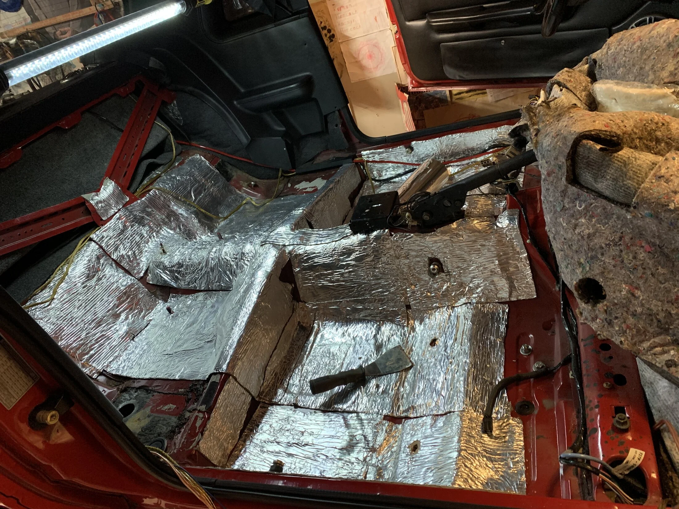

I used noico 80mm and loosely copied the Quiet Ride Solution's kit (offered by LMR) installation instructions. I then added mass backed carpet. It is certainly quieter. I didn't take decibel measurements or anything so that's the only info I can offer lol.
I wish I did DB readings. It was certainly noticeable. Heat radiation from the tran tunnel was cut way down, but I attribute that to the foam.
Also, it’s been mentioned a few times but you do not need 100% coverage. However, I did find myself defaulting to that during my install.
