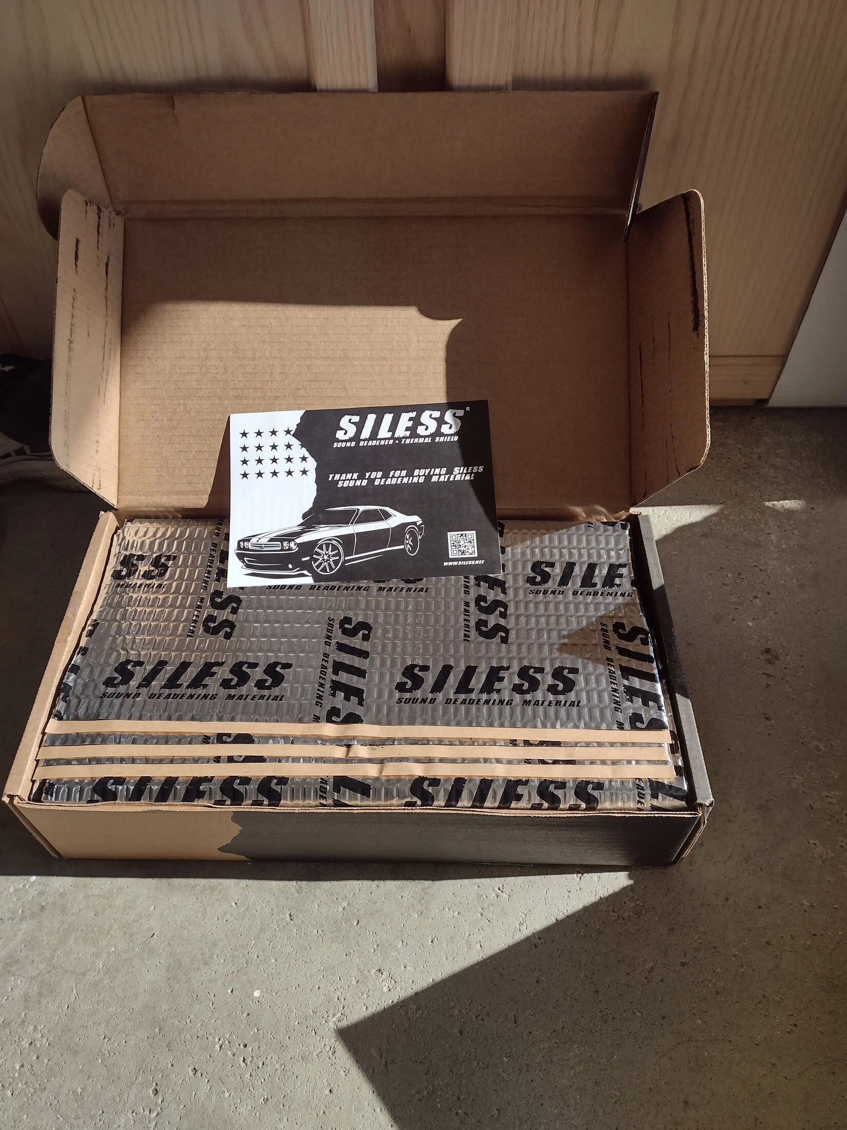

Went with the Siless 80 mil at 36sq ft. My car has no tailpipes,so gonna put turndowns and install this mainly behind front seats back.

Well that was fast.
