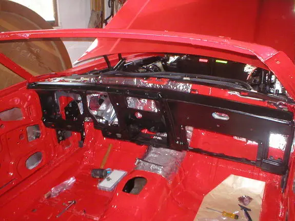

I've started doing the inside of my 73 with a product from Summit called Hush-a-mat. I went with this only because of the price. The Dyamat product seemed a little expense. If I had known about Lizard Skin while the car was still in the paint shop (still taped and papered) I would have spent the money. It's about 200 for a five gallon bucket and they suggest 2 for a car. They also want to sell you a spray gun for about 189 (Has a larger nozzel) This Hush-a-mat is not bad to work with. I leave 3 or 4 sheets in the sun for 15 minutes and it's soft and eazy to work with. I'm about 1/2 done and will cost me about 300. This is from the firewall to the trunk. In the pict I attached you can see a little of it on the tunnel. Hope this helps.
