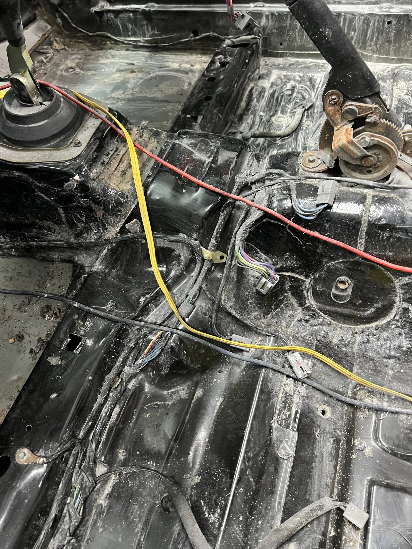

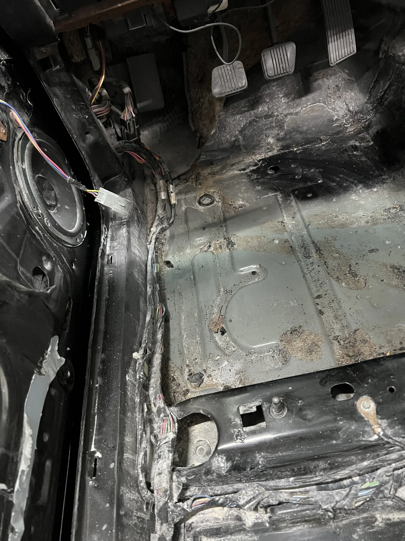

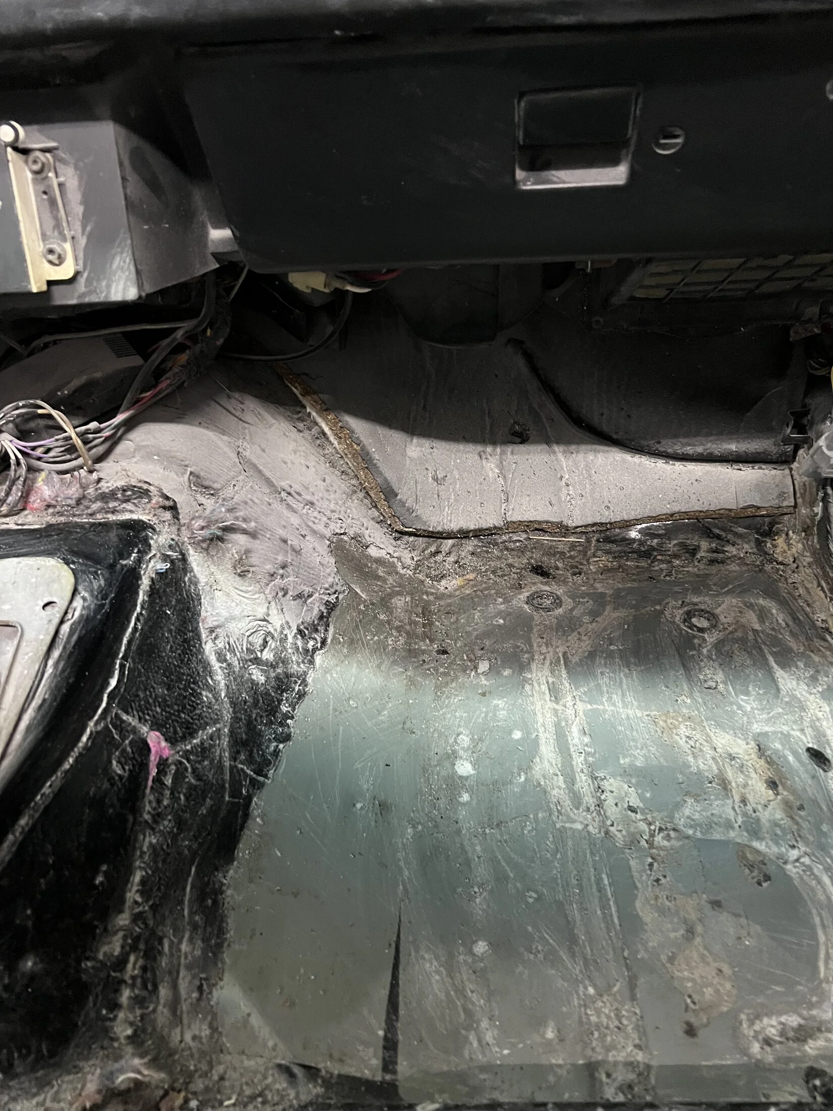

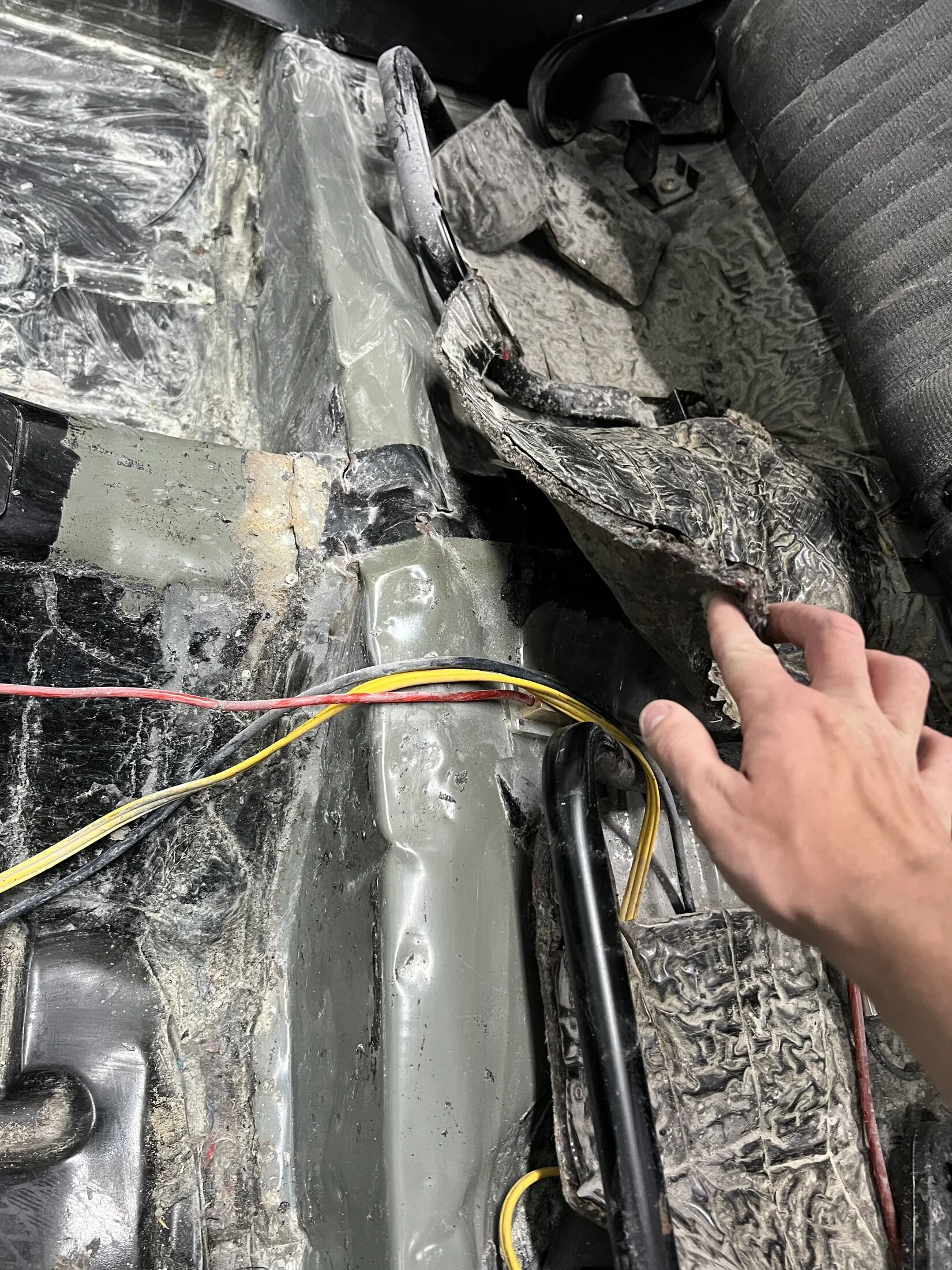

Going to order some Kilmat to apply throughout my fox interior. I had a couple questions I wanted to ask you guys.
First off, what did you guys do regarding all of the wires above the floor board in the car? How do you work around that? See pics below.
Secondly, I already removed most of the stuck on factory deadning already but I still have that foam deadner that just sits on top. Once I put the kilmat can I throw that away? Or should I leave it?

I used a panel popping tool and got the wiring off the floor board. Laid the dynomat down then located the holes and cut the dynomat away and reinstalled the wiring harnesses.
I reinstalled the pieces of automotive carpet jute padding which is what I believe you are calling “foam”. This is also glued to the back of the carpet.

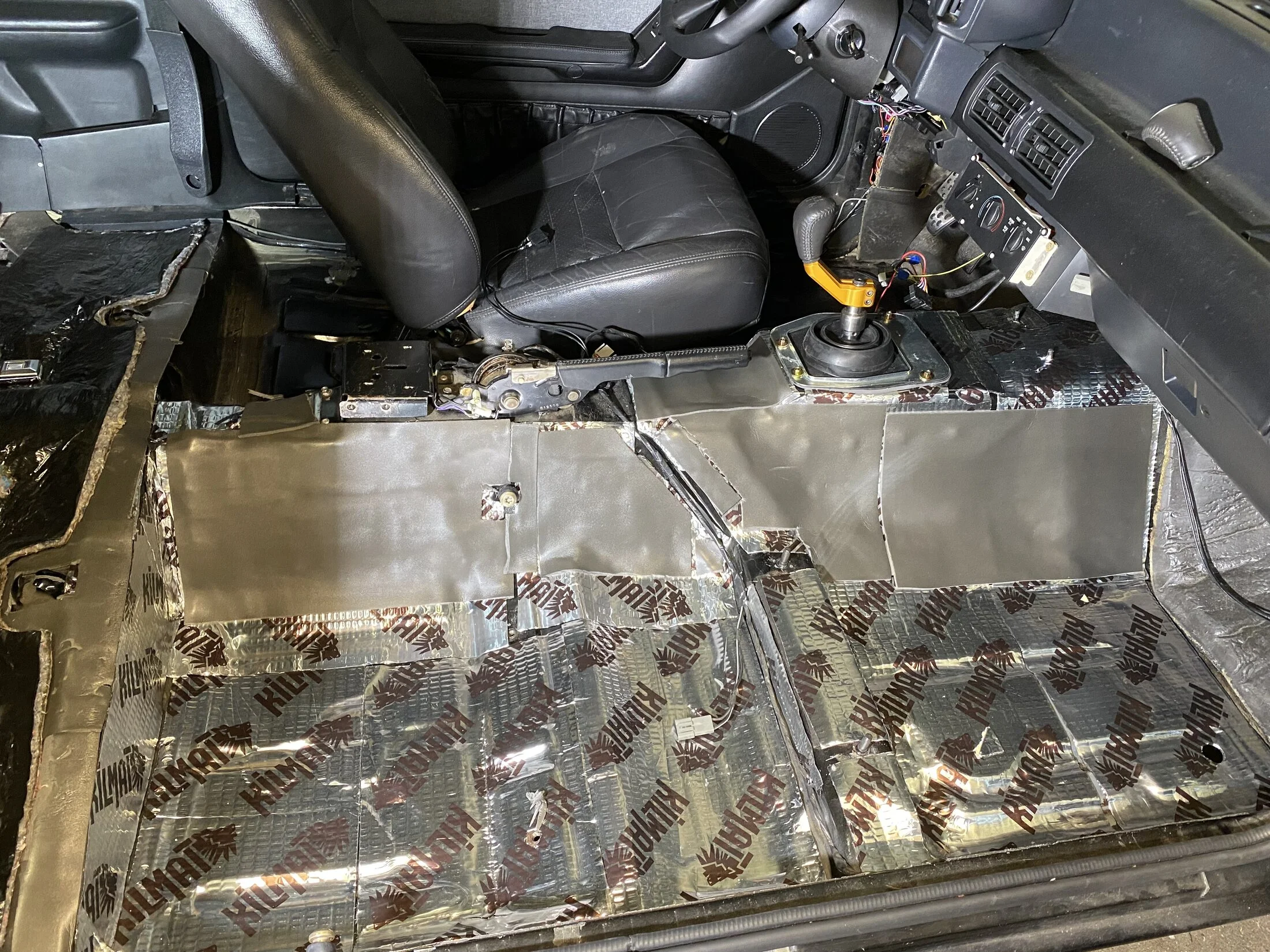

I did the same as Aerocoupe, popped the wiring up, laid the mat down and popped the clip back into place.

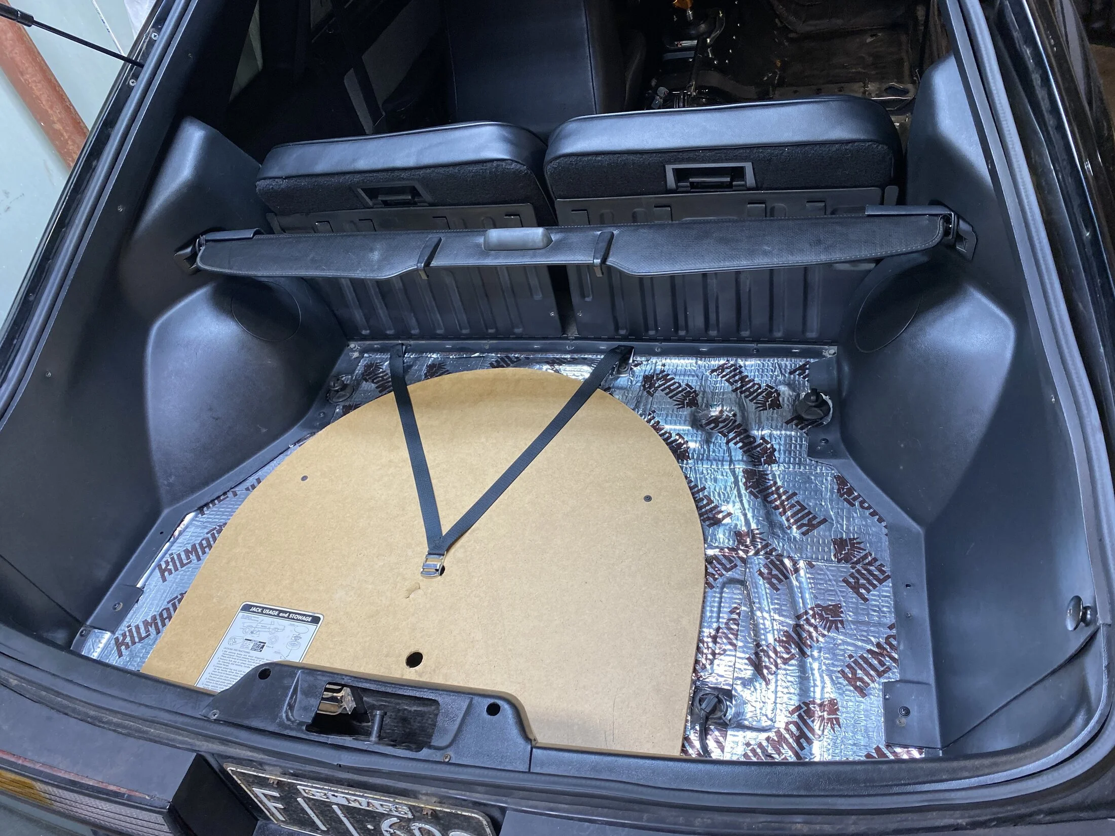

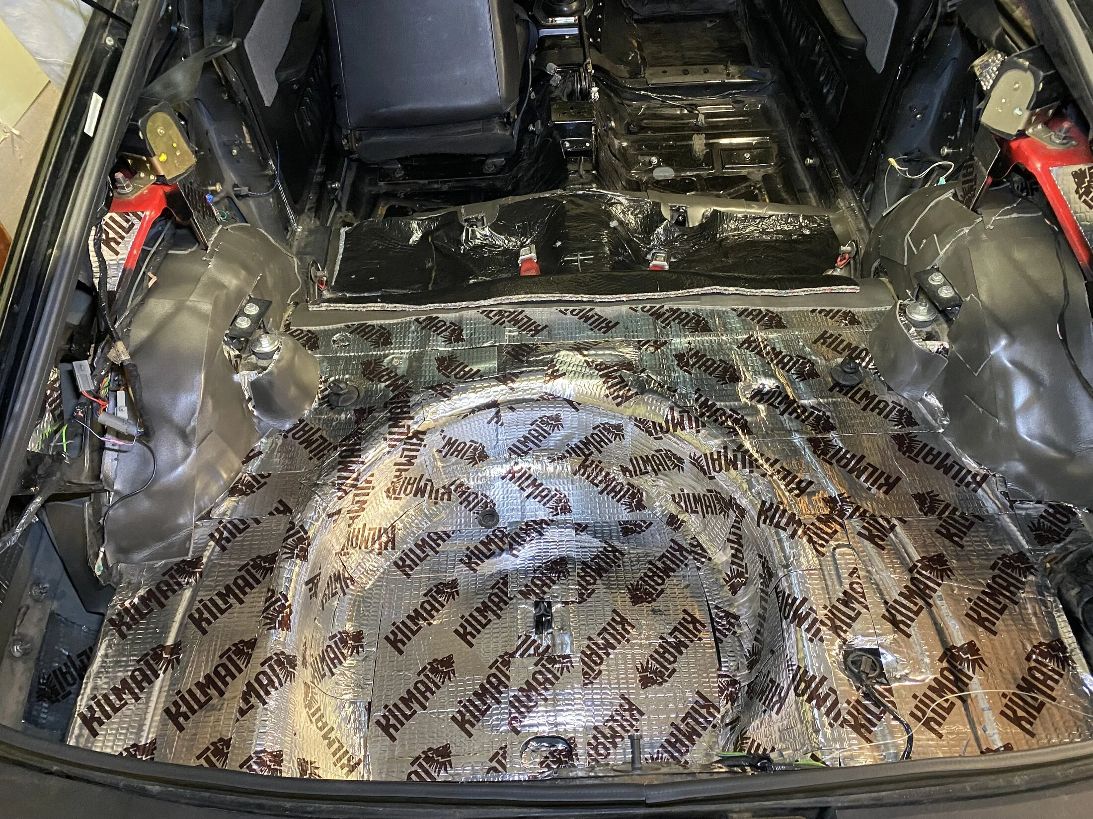

Only the main tub was done in my car, from the firewall to the rear seat. Butyl mat covered in CCF. Some butyl mat was placed on the outer/inner door skins and CCF was applied directly to the door panels. Tremendous difference in road noise.

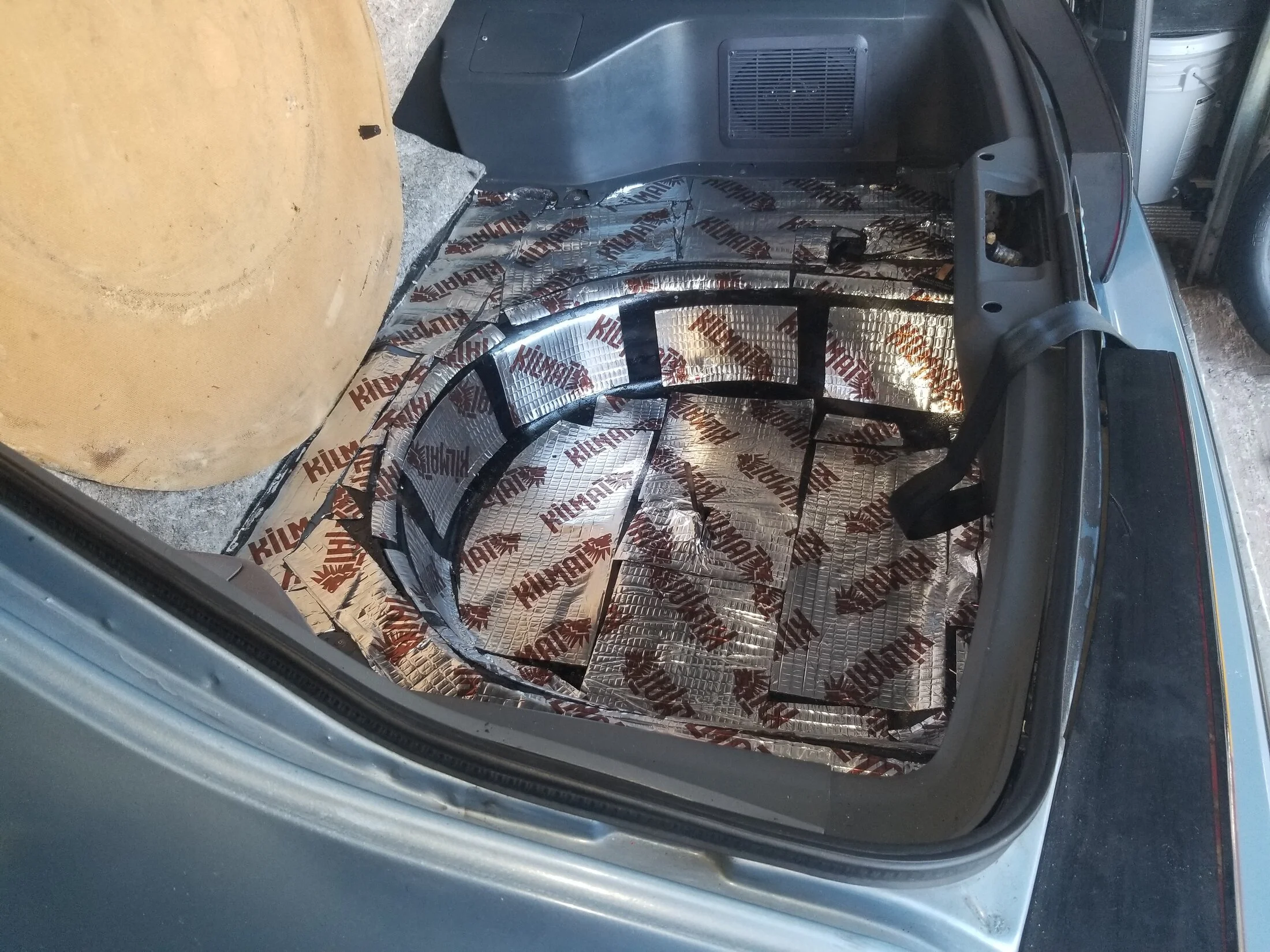

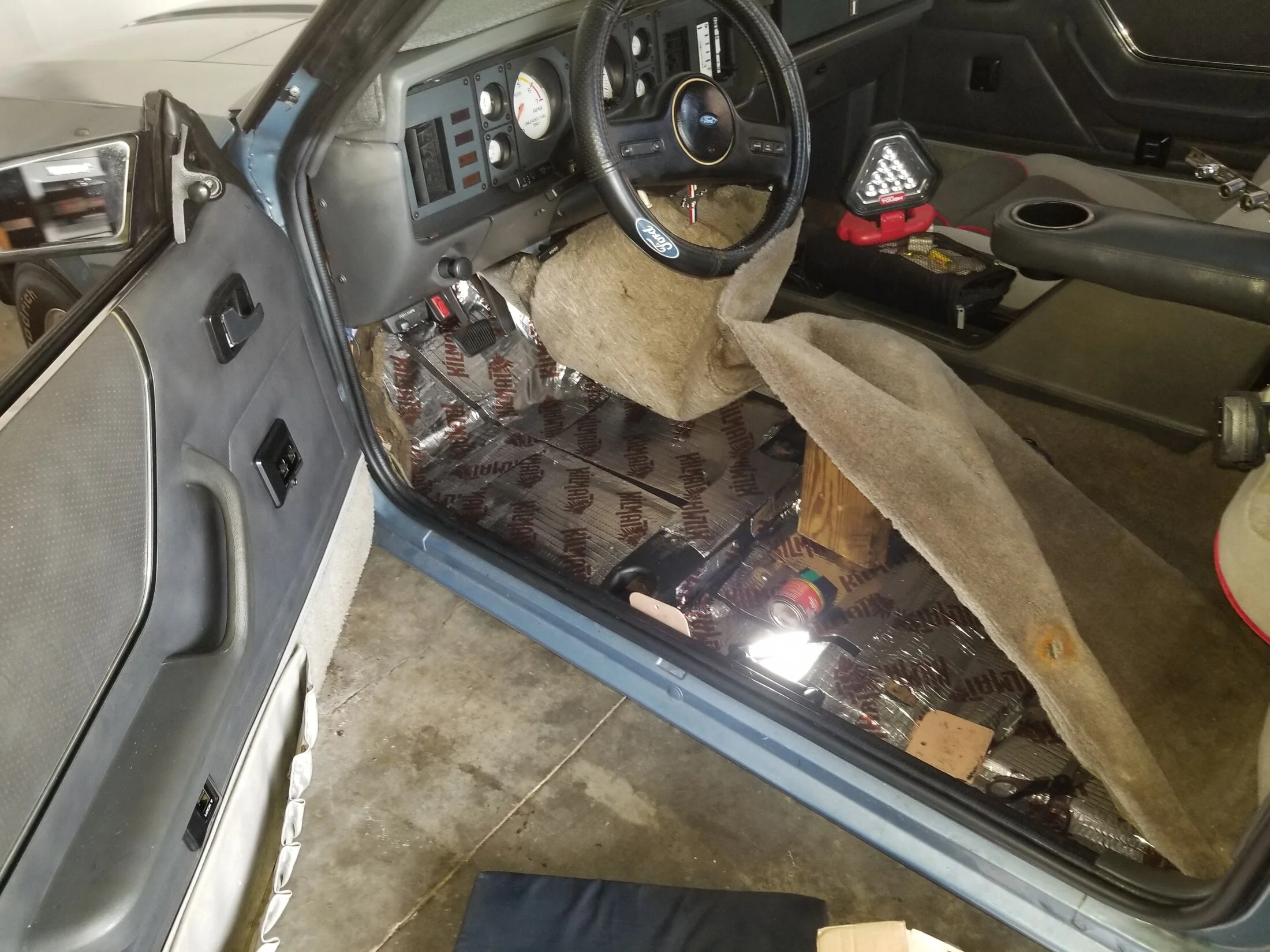

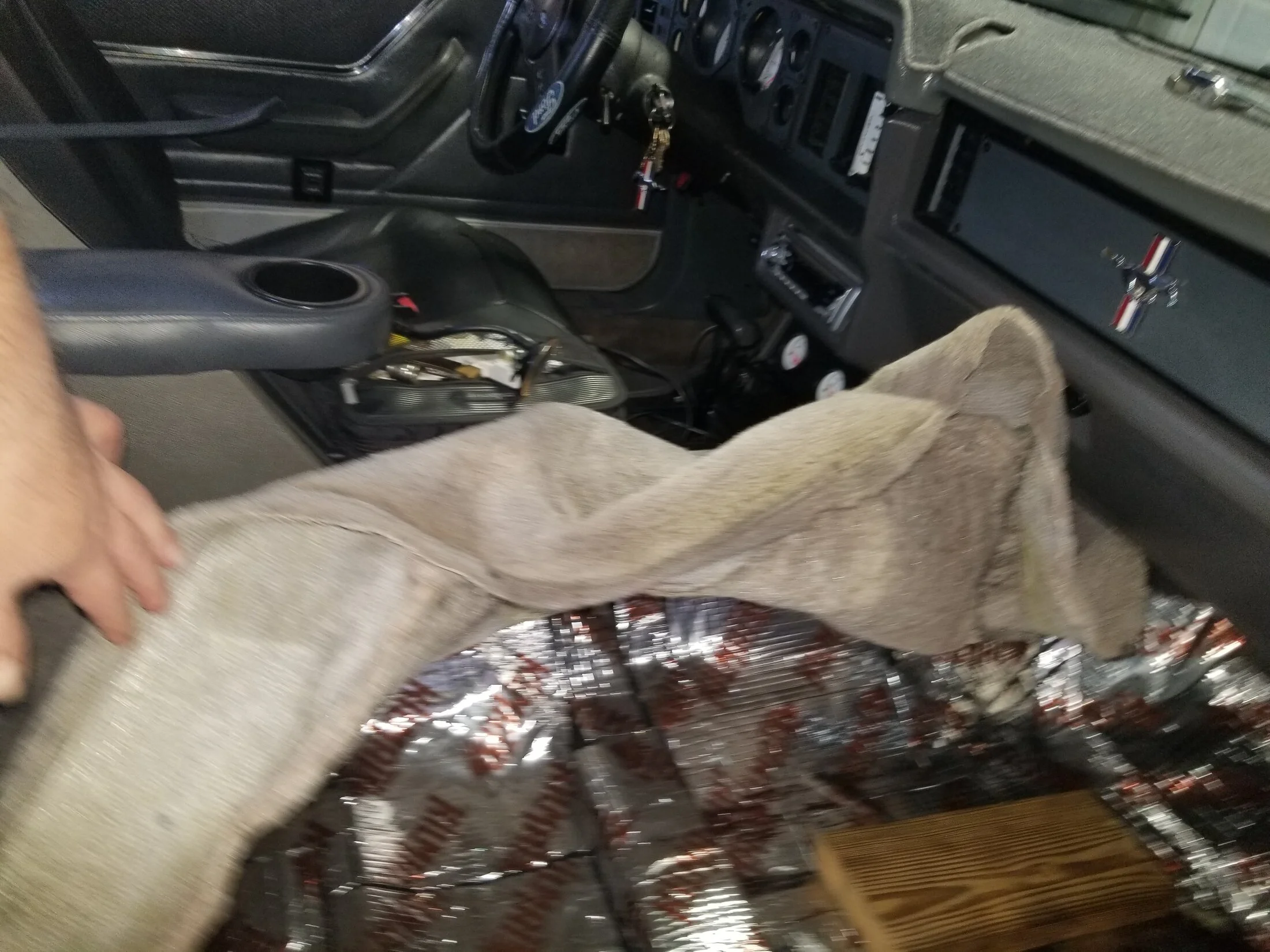

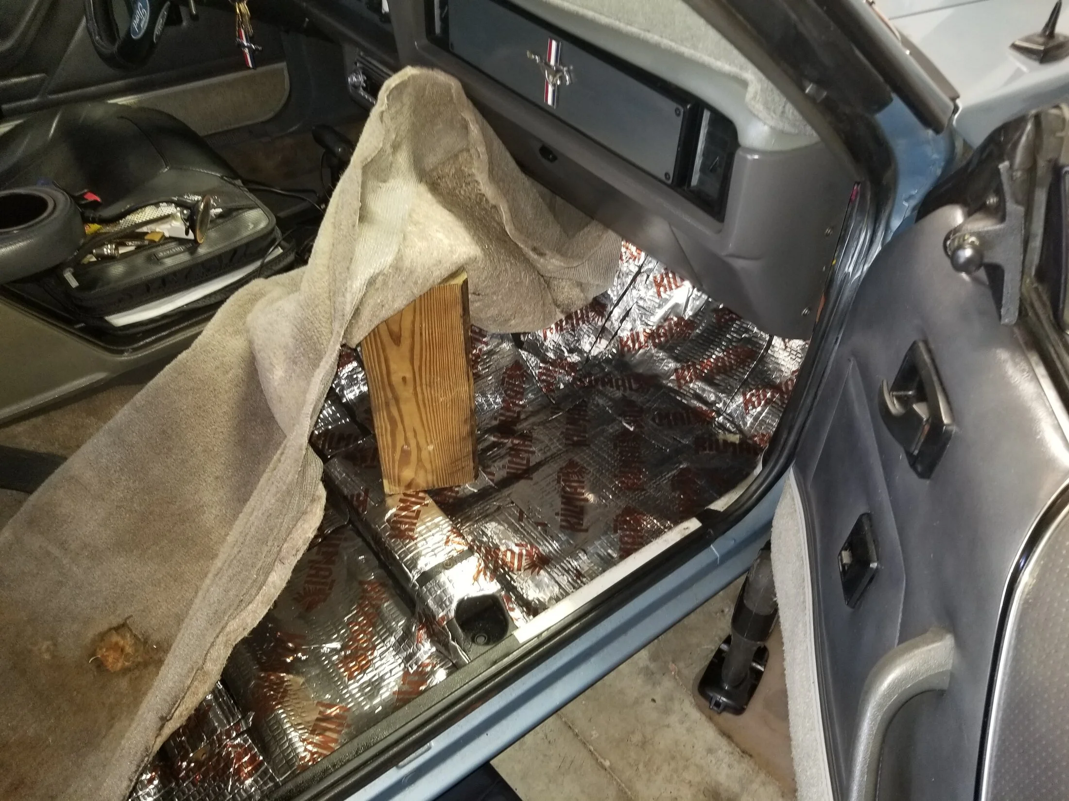

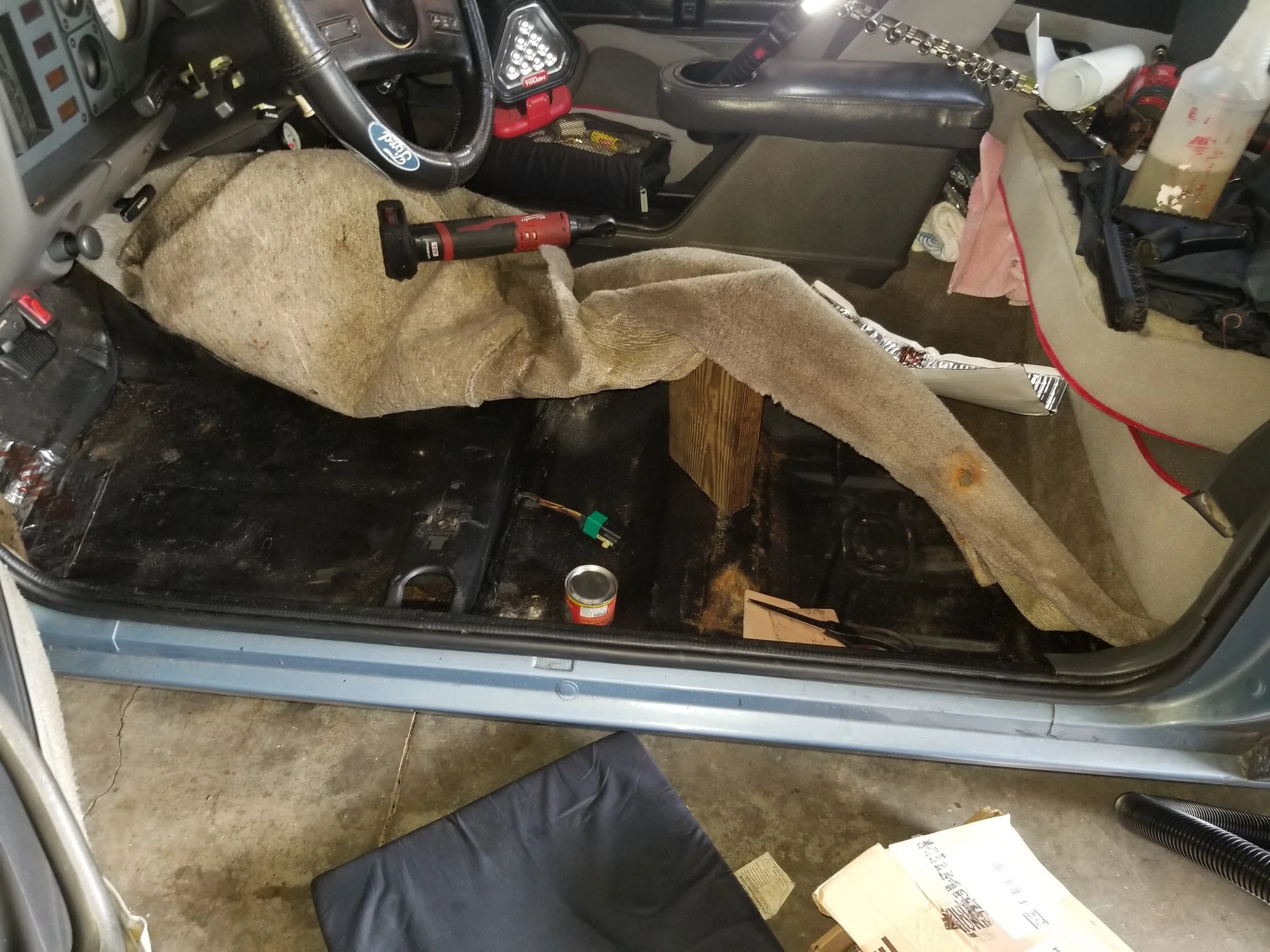

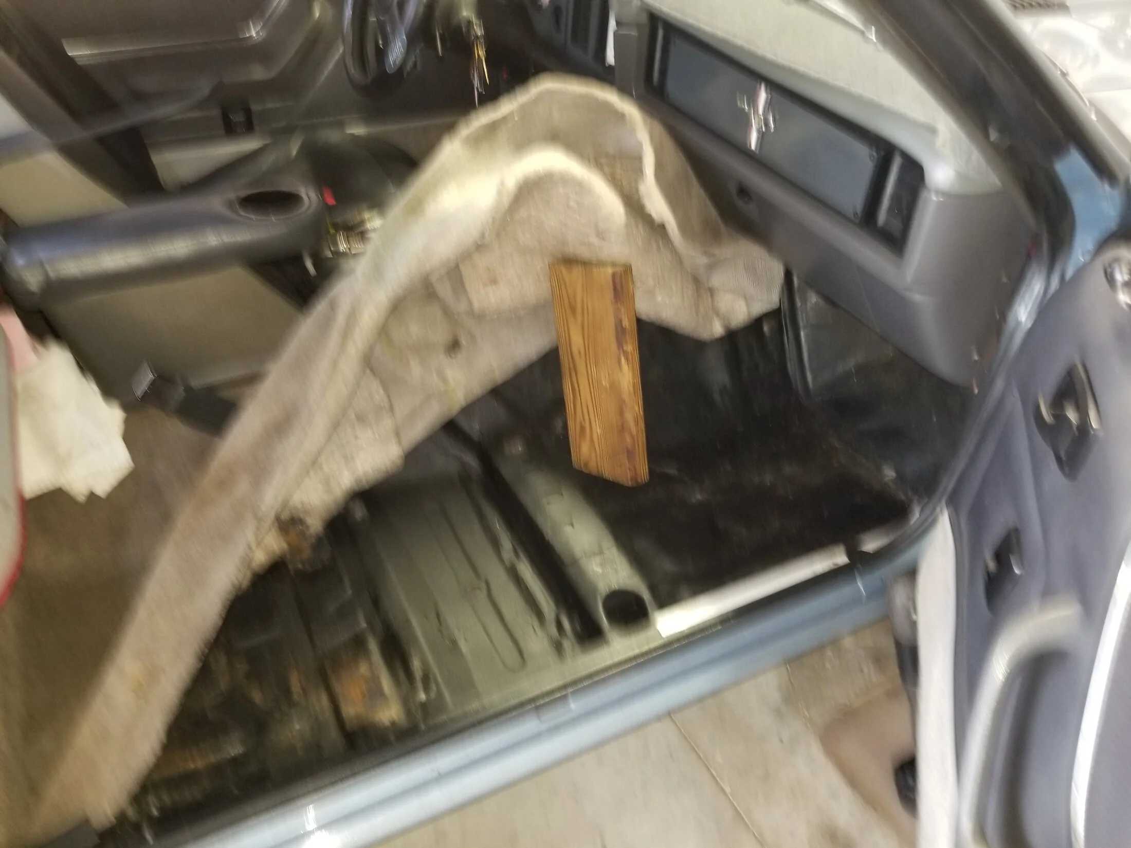

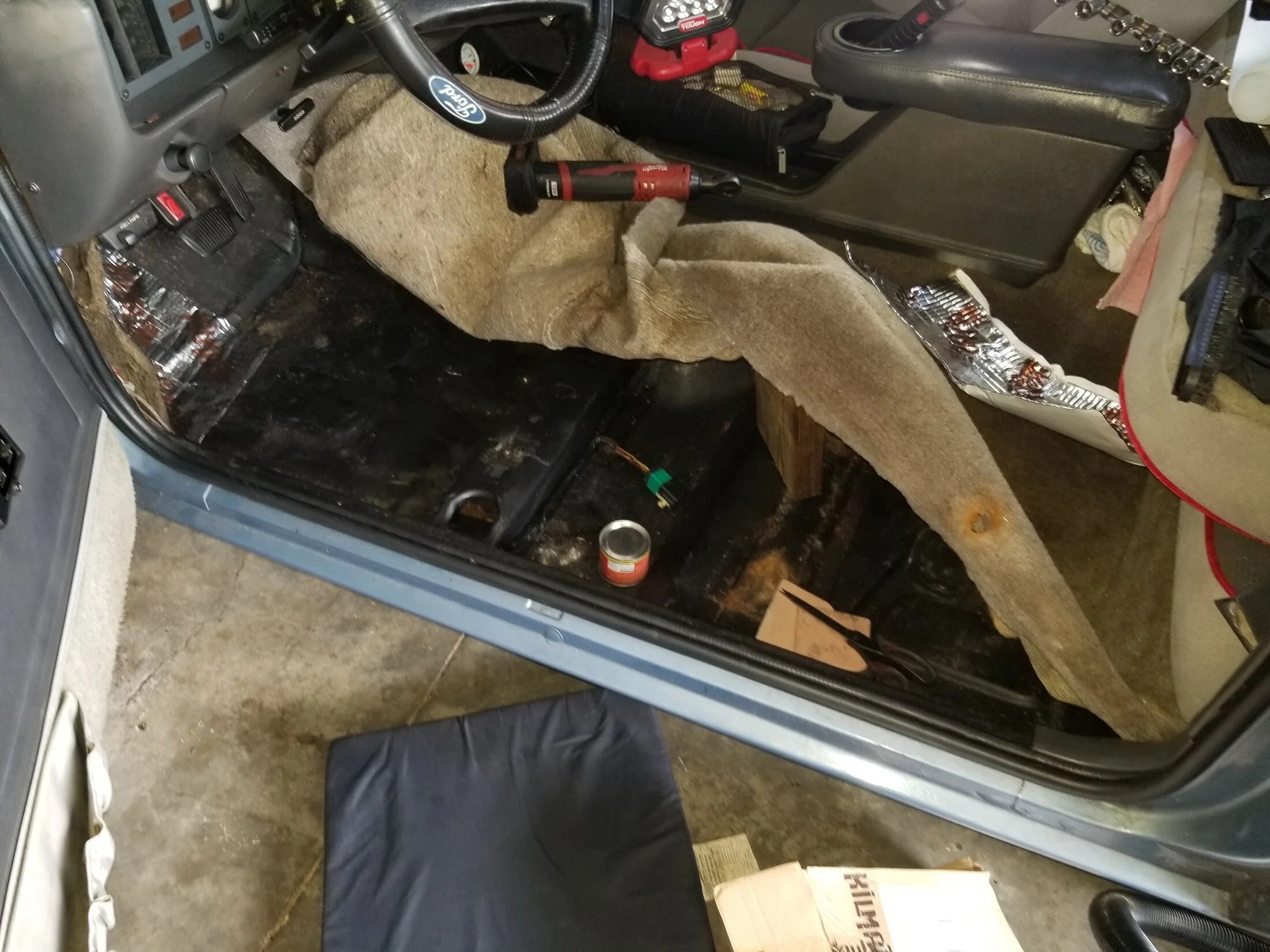

did the dynomat on the 86 T Top and it made a world of difference. Used dry ice to remove the factory sound deadener and a wire wheel to clean the floors, then I POR15 everything, then installed the Kilmat. Half way through the install on my 90 vert. Bought 2 boxes on Amazon for like $60 and still have plenty left

I went around the wires. I trimmed the sound deadener to just go up to the wires and then cut a piece to go on the opposite side. I also used some Noico 150mil foam around the trans tunnel to cut down on heat. I put as much of the OE sound insulator back as I could, and I'm running an OEM carpet.
