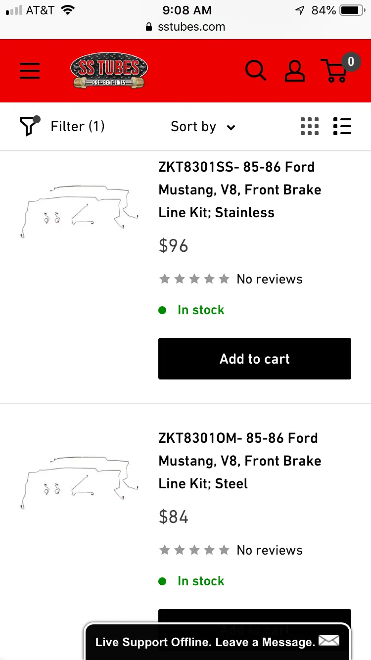

Was investigating a leak I noticed, thought It was proportioning valve, turns out there’s a hole in my master cylinder line that decided to shear itself in half when I tried to remove the line and check it out. Seeing as I am swapping to a town car master cylinder anyways, is there somewhere that sells stock style lines or do I need to bend them myself?
You may be able to get one of the short lines around the master cylinder off a wreck without damaging it. But I've not seen any new lines already bent. Match the nuts/ends well when you buy the new line and start with one a little longer than what you took out. Cheers!
Haven’t seen those two lines only for sale, but saw them as part of a kit
Don’t recall what year you had but reference to town car Mc makes me think 85-86
At least then you can replace all your engine bay brake lines
