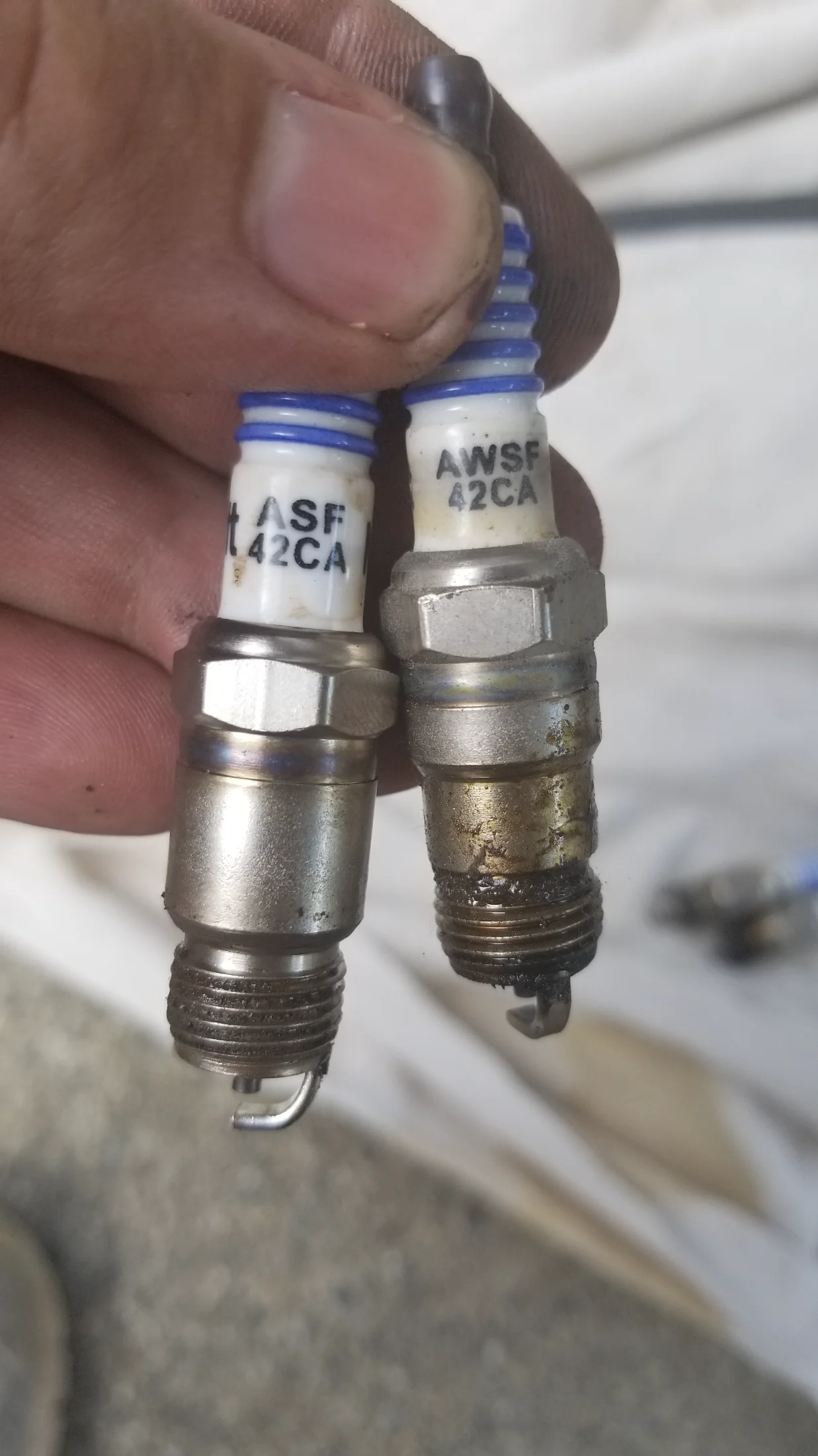

Pulled awsf42ca out of my 89 fox and the OEs are won't fit because of the diameter of the plug above the threads.
I bought the car as is and here these are used in GT40S. No clue what the prior owner may have done. All plugs the same.
Any ideas or thoughts and similar situations?

The difference between the two plugs is the "W" in the part number, which refers to the threading length in the head below the seat. As you can see the AWSF is designed to reach deeper threads and the ASF.
Original plug for the GT40 iron head is the AWSF-32C (SP-447X).
You can use 42Cs but you need to get the AWSF-42C. The 42C's are a hotter spark plug

I just bought some plugs for my GT40-X303 heads.
The recommended plug for my heads in Motorcraft is AGSF32C. (SP-447-X, SP447, AGSF-32-X)
Autolite plug would be #104

What heads do you have on your engine. The plugs you need are determined by the type of heads.
I have GT40 3 bar heads, the Motorcraft plugs I use are SP447. I recommend using copper core plugs
You can also use:
Autolite Spark Plug 104
NGK-TR55
None of these will fit GT40P 4bar heads.
