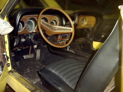

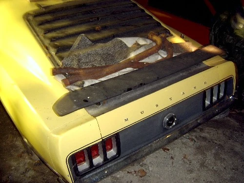

yea, that rear panel (the black panel around the gas cap) should be molded honeycomb, and the cap is a screw on, but the machs had pop offs, further, the thick black stripe with the chrome mach I lettering in the center is missing from the backside (vertical part) of the trunk lid. also... the hood latches (twist type) which were standard on machs in 1970 are missing. also not the deluxe 3 spoke rim blow steering wheel that came with 1970 mach
The steering wheel had been stolen ! This is the same as one of my 73 had. The twist type hood latches has been there, but they have been dissable.. Some guys has welded the hole in the hood. That job i saw with my own eyes

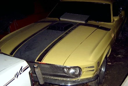

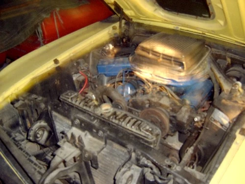

Um... correct me if I'm wrong, but isn't that the Boss 302 Stripe kit with the stripes on the sides removed rather than the Mach 1 paint job? And a 302 with Ram Air?
I think you might want to do a bit more research on that car.... I'm not sure if the VIN may have already disproved this, but I'd almost think it's a Boss 302 rather than a Mach.

It looks like the side stripes are reflecting the camera flash.

It has crossed my mine. I dident write the Vin, a guy witch collects all info on Mustangs in Norway did a few years ago. It has never been registered in norway. and im begining to think that maybe that vin is for another car.
The info witch says it could be a Boss: 302, standard grille, shaker. Info from Illustrated Mustang buyers guide: "Occasionally, you may see a Boss 302 without the front spoiler, and this is because it never was installed. These cars were shipped to the dealers without the spoiler installed. It was up to the dealers to install it, and apparently, didn`t always do so. It says that it also dident got the honeycomb on the rear deck." And it dosent got the frontspoiler or the honeycomb

68darkhorse - See, that's what's bugging me. He had posted the VIN earlier, and it checked out like a Mach, but the car itself I think looks like a Boss...
Got the 302, the Ram Air, the Stripe Kit.....

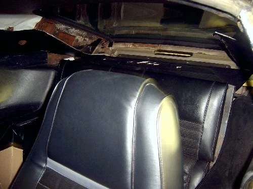

Here`s a picture of the back. I dident get all the way in the car and i dident see the trunk. But is this fold down back seat ???
Actually the car can be stolen.. it was like a trend in europe in the eightees.. I have heard many storys on it. Like a 70 Shelby Cab that was stolen in 83, was found in a wood chooped in norway a few years back. But to find out that exact without the door tag would most likely be hard... maybe the doors got changed also... I think it would be a mystery... Im going to check the car more within the week

pabear89 said:
The Mach 1 was nothing more than stickers in '69 and '70 as well. Any engine that came in a Mach 1 was available in all body styles.
Not true, 69 was a side stripe iding it as a Mach1, 70 had lower body moldings that say Mach1.
the interiors on the Mach's are upgraded with center console and fold down rear seats, nicer door panels and clock.
a/c was an option.
PB
I only said stickers as I was addressing another post that mentioned stickers. He was suggesting that Mach 1 was a performance package for '69-'70 and not '71-'73.
The Mach 1 is still an appearance package. The interior you described is the same as the Grande coupe.

I suppose it could be an attempted Boss 302 clone (or hey, maybe still a real one), but I'm thinking with some confidence that it's not a Mach.
