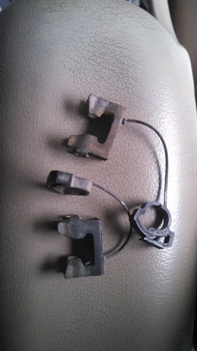

Are these the clips you are looking for?
If so, then we are in business as I mailed them out today! Unfortunately, due to the holiday you won't prolly see them until mid-week next week.
Best of Luck!
