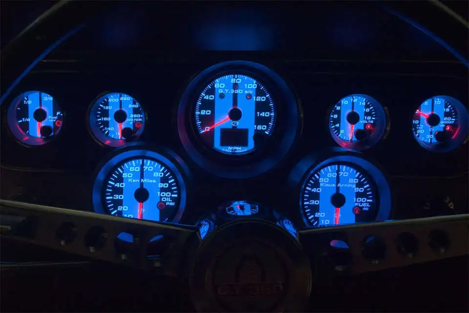

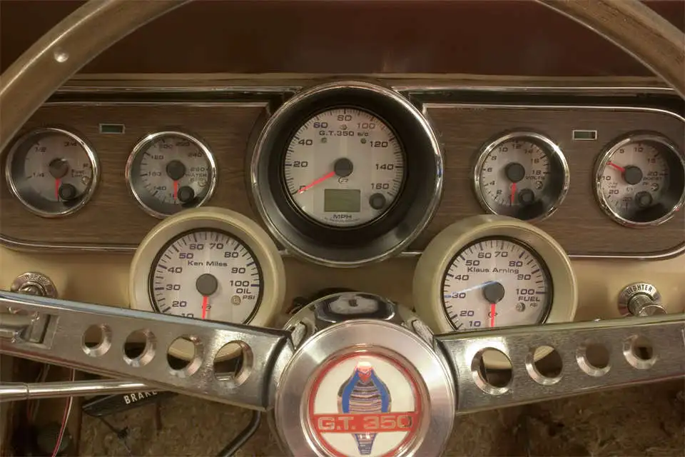

I am very happy with the set they did for the '66
Pros:
Vastly customizable
great quality
dimming gauge face (using the headlight dimmer)
Cons:
more wiring than standard gauges due to the hall effect sensors, and dimming LEDs
Before ordering a set, I'd suggest sitting down with the stock gauges, and a catalog of after-market gauges and really think about the details... Do you want a High beam indicator in the speedo? Do you want remote or face mounted switches (some gauges like the 2-5/16" and 4" and larger speedo have remote switches). What details do you want on the faces? They can do a lot more than what is on their website. In fact some of the stuff they can do, I found out when looking through some kit car magazines. They make gauges for different kit car companies too.
They added the LED package that comes on the FFR gauges (high beam, and turn signals).
I'm using the turn signal LEDs for the Roll Lock indicator, and the CEL for the EEC-IV.
The pressure transducers are all hall effect, and come with shielded cables.
They sent an email with proofs of the gauge faces so I could see how the "Lemans" stripes would look before ordering.
(BTW: there is no tach in this set, because I have the Shelby dash mounted version).
Hope this helps,

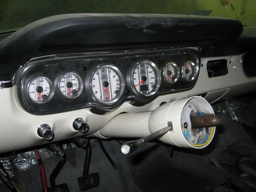

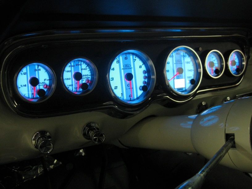

Here are my Speedhut gauges. Don't mind the dust as the car isn't complete yet ;)
I got the bezel from Mustangs Unlimited. I believe it was around $90 or so. The quality of the bezel is pretty cheap and I was a bit surprised it cost $90. However, it does the job and doesn't look too bad once it is installed.
I searched around for a long time trying to find a 6-gauge bezel that I liked and looked stock. There are that that many choices to pick from. You either spend $75-$100 for one of these cheap aftermarket bezels or you fork over $500 for one of the billet aluminum ones from JME or a similar company.
