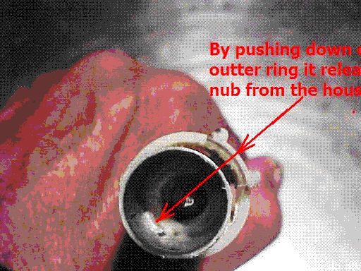

ok, i need to replace som bulbs in my guage cluster, how do i disconnect the speedo cable from the back? is there a certian way to twist or do you just pull....i dont feel like breaking it so any help is appretiated
thanks

The cable has a white plastic connector on it where it plugs into the speedo head. Press down on it and pull the cable out of the speedo head.

press down as in squeeze it, push it into the guage cluster or.... ?????

Push down on the flat part of the white plastic and pull the cable out.
Photos courtsey of ALMOST STOCK

awesome! thanks
