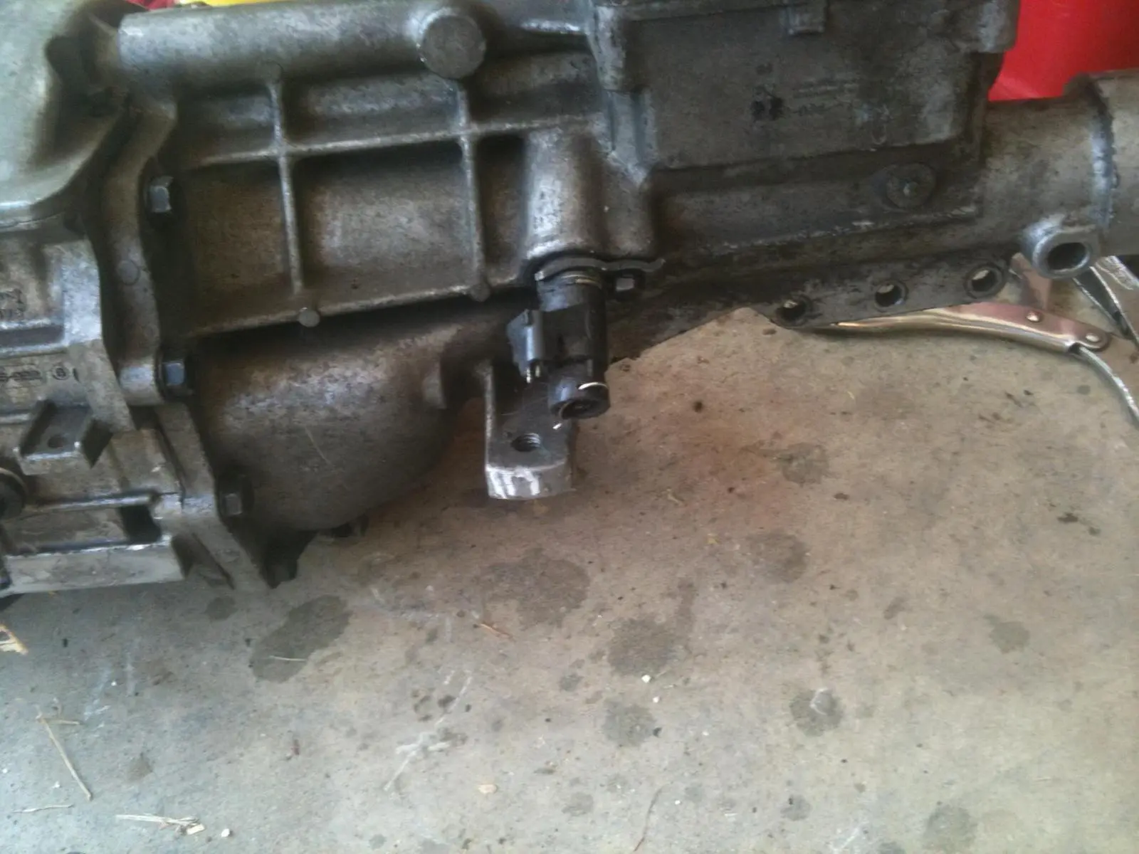

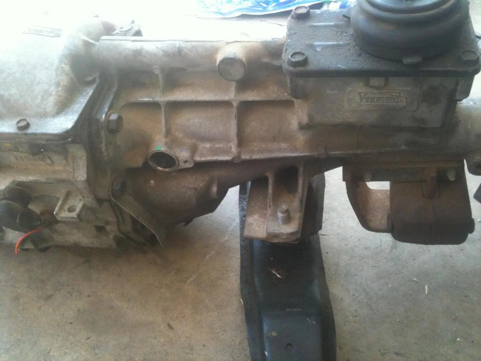

here is the difference in trannys
one is a borg and warner and the other is a tremic
