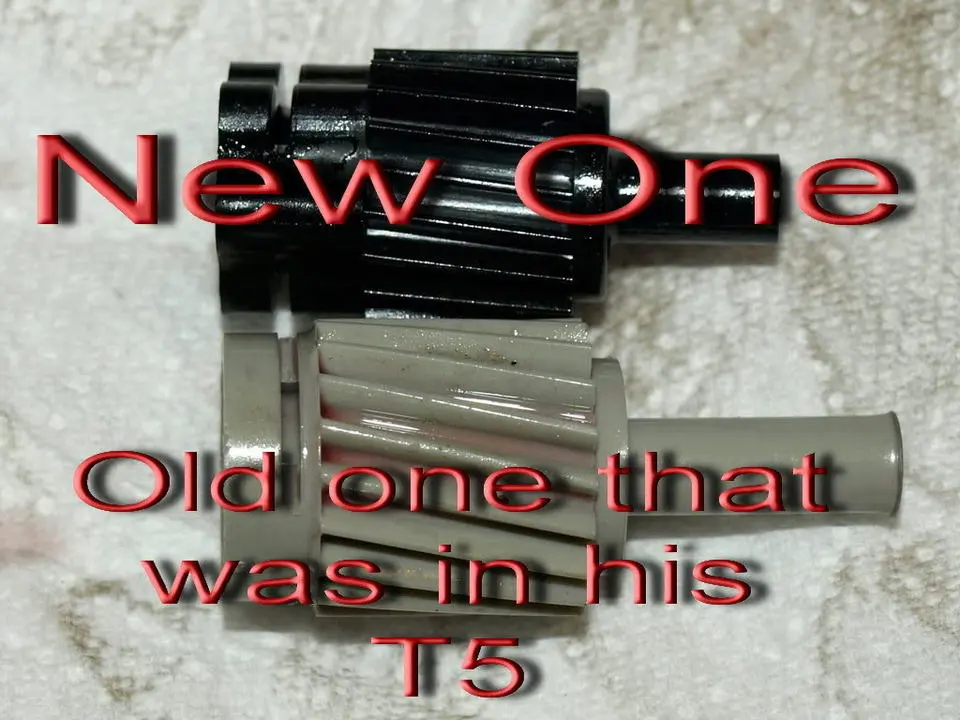

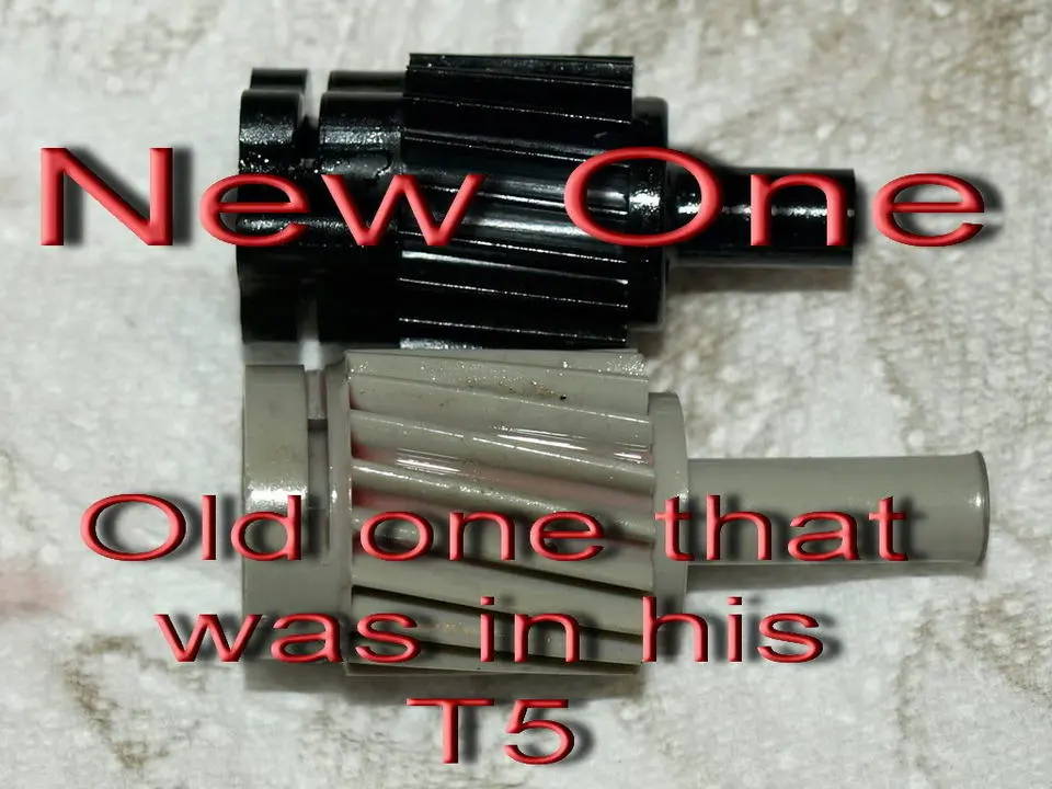

Here is what I noticed on a friends car and I still have to get back there to replace it but....
When you put the speedo gear on the cable, did it seat down easily or did you have to push it on and compress the cable a bit to get the clip on?
On my buddies car I think we need to trim 1/8th to 1/4 inch off the squared cable end so it will seat nicely in the gear. There is too much tension with it not cut.
Don't know if that is it, but that is what I am trying next on his car.
The other odd thing is that the gear he has in his tranny now is one from an AOD with the longer snout....which accepts the longer cable end.
The black one is what he needs and its too tight on the cable. The speedo cable is the correct one for his car too.
