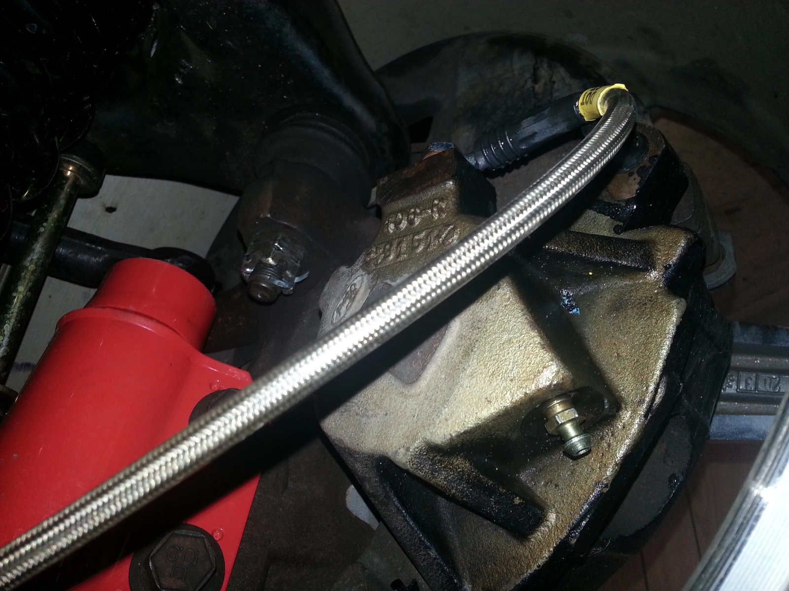

Let me know if the caliper looks like its on the wrong side. Nothing I can do. I have had the MC replaced turned out it was failing. Then had issues with the rear brake cylinders had both replaced still spongy pedal.
