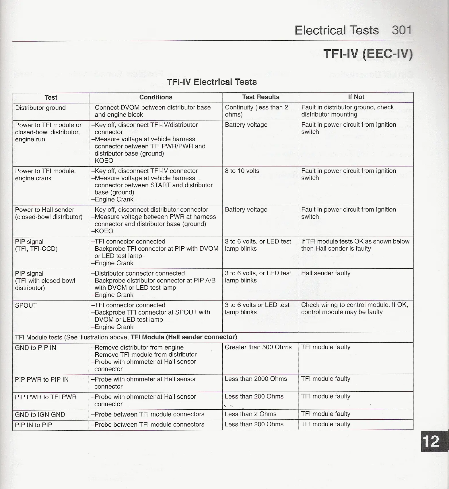

Sorry, I'm confused. The range for what?Now, the range is [high] though I don't consider it crazy. It may be enough to cause trouble?![]()

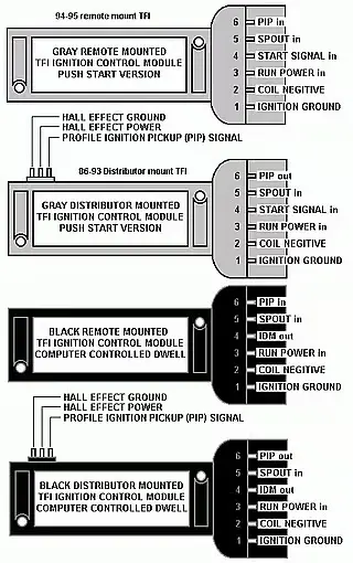

Removing it didn't change the issue. I think it looks somewhat like this?![]()
None of that looks burned but I have no idea what it is.![]()
