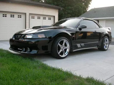

I attached a pic just for fun. Thanks in advance for any help / advice.
