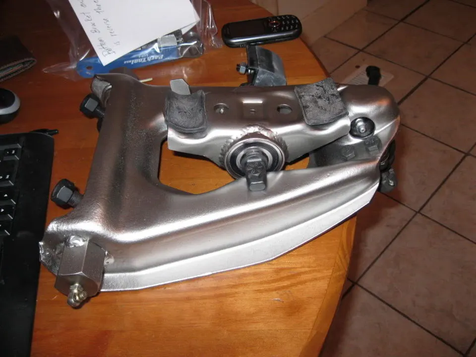

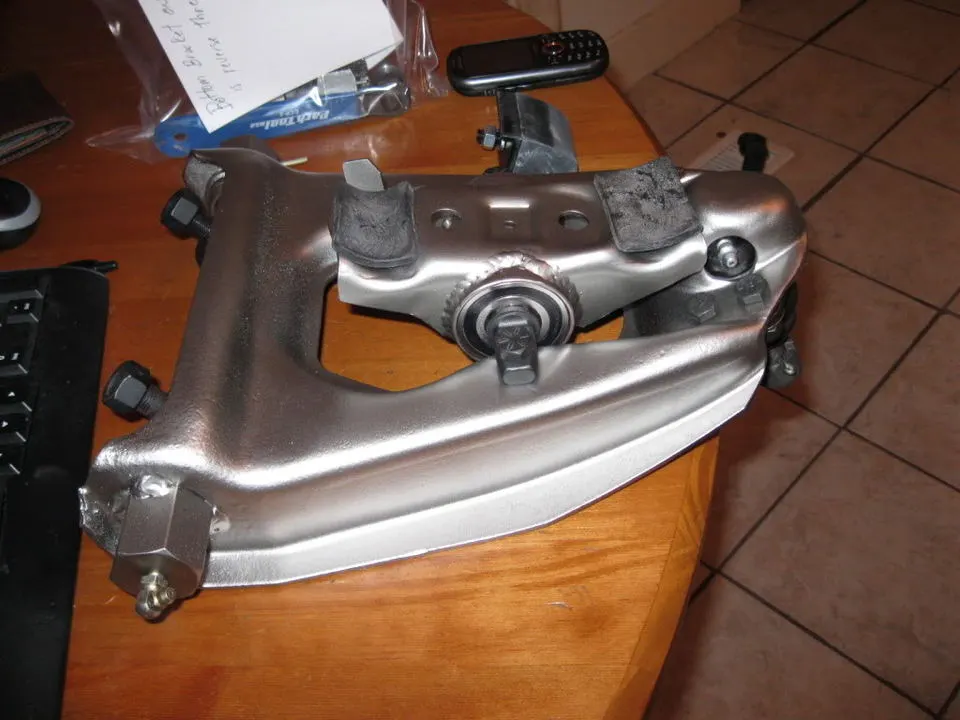

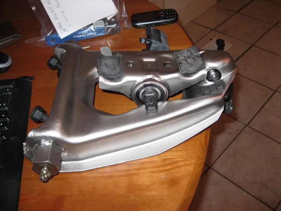

what able to move? the nuts aren't going to move because i welded them. but i welded them in a position where there wasn't any binding in the shaft when moving the arm up and down. i believe this is a common modification.
you can see the welds in this picture. same thing on the nut on the other side.

Ford not only specifies that the shaft must be centered in the arm, but also specifies a dimension between the ends to assure that the caps have not been over or under tightened. I typically put a couple of welds on them too, I have seen what happens when they come loose. Rare, but scary.

I see that... So the shaft is free and centerd in the Caps... I also see what looks to be the spring seats have bearings. is this an good up grade have you found? I thought taking the springs out with the car on the ground. First take out out the shocks and top mount put in the inturnal spring comp and tighten up the compressor then jack up the car some of the work will be done do you agree?
i made those using a bearing kit. i personally struggle with believing they will make a noticeable improvement in performance. i'll never know if they make a performance difference either since i've never driven the car before or after the change.
many swear they work, but i sometimes wonder if it's because they paid $200 for them (or whatever they cost).

I wonder about the usefulness of the rollers on a device that only rotates a few degrees from fully compressed to fully extended. Perhaps the lack of the rubber insulator changes the "road feel" of the suspension.
A small trick that many use is to justify the control arm on the shaft to the rear 1/16"-1/8" by threading the shaft forward 1/2-1 full turn. What this accomplishes is to give you a bit more positive caster while minimizing the difference of shimming on the front and rear mounting bolts. One rule of thumb indication of whether you should justify 1/2 turn or full turn would be the current difference in the thickness of shimming between the front and rear mounting bolts. IE: If the front is shimmed only a tiny bit more than the rear, go with 1/2 turn and if there is a big difference, go with a full turn. Of course if your car currently drives/handles poorly, you wouldn't want to use the current settings as a reference and it will be more of a trial/error type of thing. You still want to make sure you have the factory spec for end to end dimension. Here are 3 write ups you should read:
