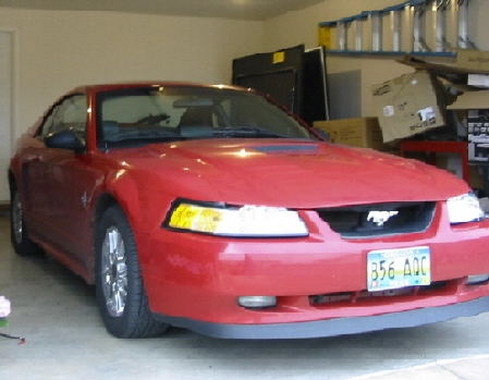

Here is a pic of mine with the Bullitt springs on my '98 body style. Took away the 4x4 look, added some handling and reduced the brake dive big time. I would like it just a little lower though, maybe the Steeda springs.........
