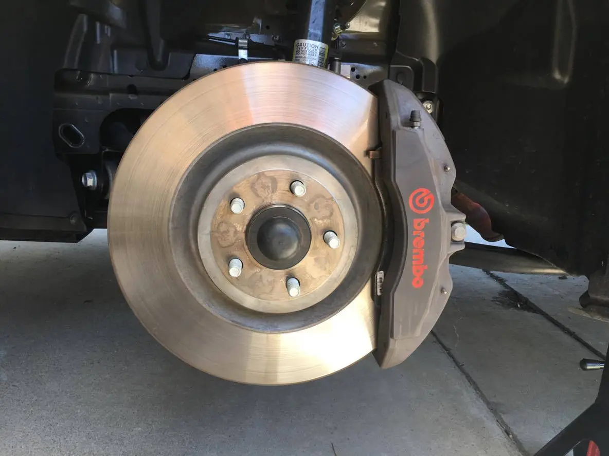

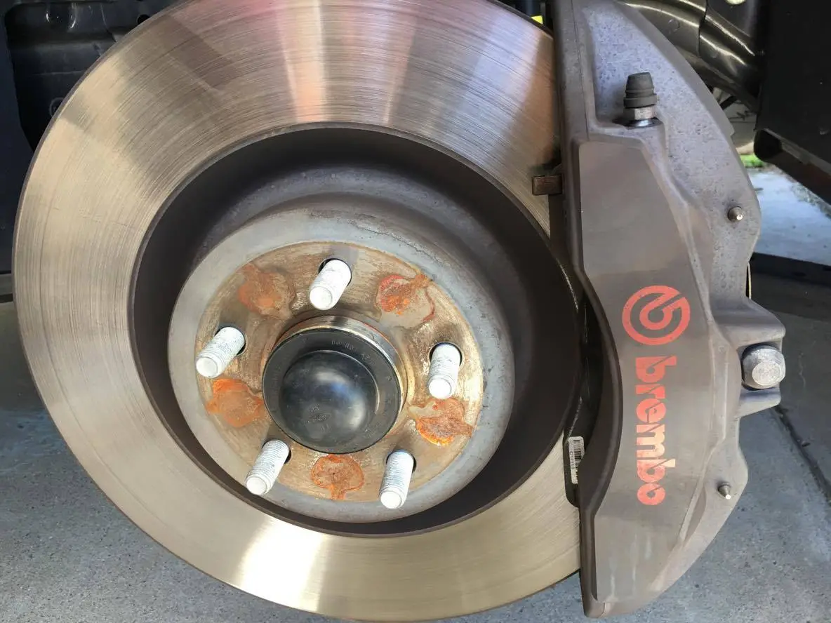

So I finally got around to pulling off the wheels. I did not pull off the calipers, but I just sprayed some brake cleaner, brushed off the rust and dust. I doubt this will do much since I didn't bother looking at the pads.
This is what it looked like when I pulled off the wheels...
I cleaned it up and it looked like this...
I haven't tested it so I don't know if what I did works or for how long but I'll keep everyone up to date.
*Did this all the way around the car*
Brian8891
Apr 7, 2017
59
28
Apr 21, 2017
#57
  • Apr 21, 2017
  • #57
Bad news.. It did not stop the squealing issue. It took a while to replicate, but I think its with the pads and not the rotors.
