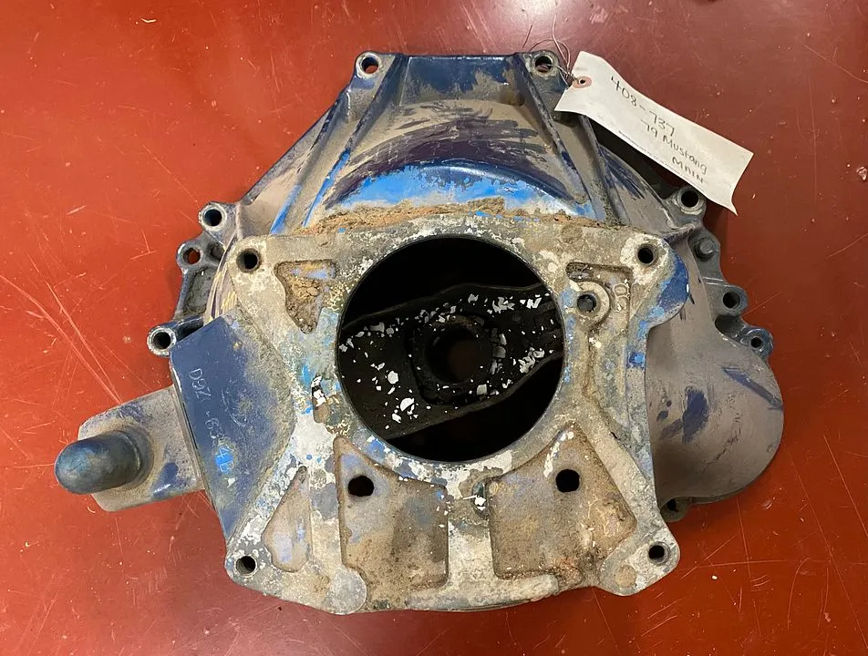

You have to love small town Oklahoma salvage yards. Got it for $75 with the dust cover and clutch fork. Will not be using the clutch fork, pivot ball, or dust cover as this will be used on a Tremec TKX later down the road. Little oven cleaner and a good power washing will have the two layers of blue paint, engine oil, and clutch dust off of it and looking like new. The TKX is way down the road but starting to gather the "cheap" parts now.
What t56 do these bolt too? Though only the tko 500/600, 3550 and tkx shared that bolt pattern, spacing and counter bore? And damn I remember when I bought one new from downs ford for $100 extra with my first 3550 for $1100 in the late 90's.
Fixed my mistake, meant TKX. Been working on T-56 on another car the last couple of days and got dyslexic. Have a McLeod bell and dual disc clutch for it to mate up to the stroked 351.

Questions for you knowledgable bellhousing swap people, is this the same as a T5 bell, as it seems?
And is an old Ford toploader bell different from a T5 bell? Back in 19, when I went to get my engine dynoed, the shop did not have a Ford bellhousing. I ran down to Summit and bought a new ford T5 bell for a 5.0 Mustang. Turned out to have a larger index hole for the trans than an old Ford type, and the shop did not have a dyno adapter for it.
Had to wait until he found an older bell to run my engine.
No sir. The TKO/TKX share the transmission bolt pattern to the bell housing but as you pointed out the hole in the center is different. The T5 has a different bolt pattern than the TKO/TKX.
