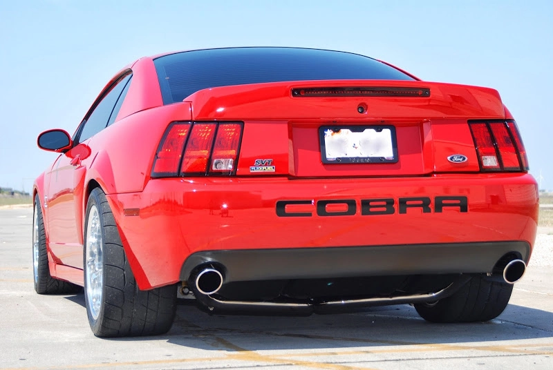

I like low, but I guess the real goal for me (for looks) is not to have a huge gap from the fenders to the tire like they do stock... mine looks kinda 4x4-ish, lol....
I actually really like this look tire size, etc a lot, and the fenders hug the tires pretty close, which looks great to me.

thats an 18-295. you can see it has a little bit of travel to go into the wheel well if you hit a bump. my car's rear end for reference. http://i.imgur.com/sqQmo4I.jpg.

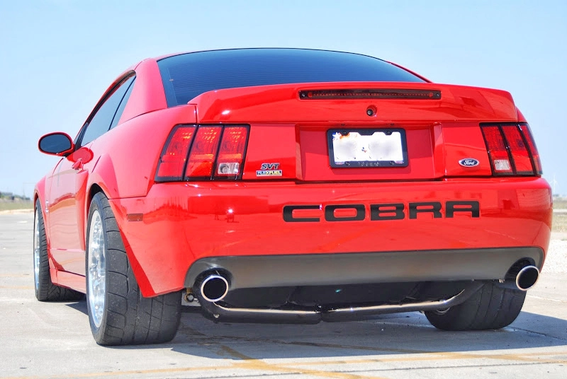

I like the ride height of yours from the other pic you sent (my car is same color too)
the red cobra tires appear wider to me - I brightened the pic a little to see it better: (maybe it's just the angle that makes it look that way?)
I'm not afraid to push limits, I just want literally the widest I can fit without sticking out like you mentioned.

i am 99.99% sure thats a 295 on an 18 wheel
