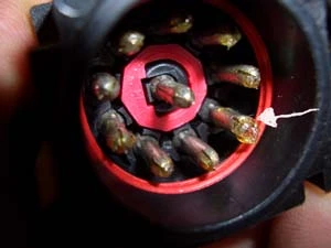

I did find in my salt pepper shakers a bunch of gel looking substance on most prongs i have pictures of it..i dont know if it was silicon gel or what but i tried to get rid of all that...is that normal?...reset computer and let idle...still did it.

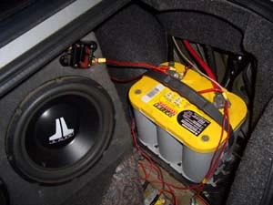

And when ever it stalls it hard restarts..why does it hard restart? i have to give it gas to start back up...sometimes longer than others...heres the thing sometimes when it stalls it wont even turn over after it stalls it doesnt click or anything the light jus dim and nothing happens... So to me sounded like a connection or something..my battery is in the trunk so i jus pushed the battery around mov3d it rather and got back in and it started... so i think im on to something with that. Maybe the starter red wire is shorting or loose maybe? Does that sound possible... Can a loose connection like that cause stalling after u stop at a stop sign or even surge? where could the loose connection be?

The other poster is talking about your motor ground. I would use at least a 4 AWG cable (the cable gets bigger as the numbers get smaller. So 2 AWG would be bigger than 4 AWG).
BTW, this would have NOTHING to do with your TPS wire.
