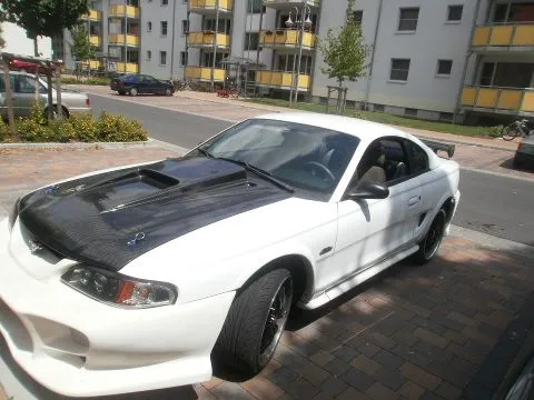

My 1998 Ford Mustang GT is stalling in second gear when I downshift. Any Ideas on what it could be. Thanks
