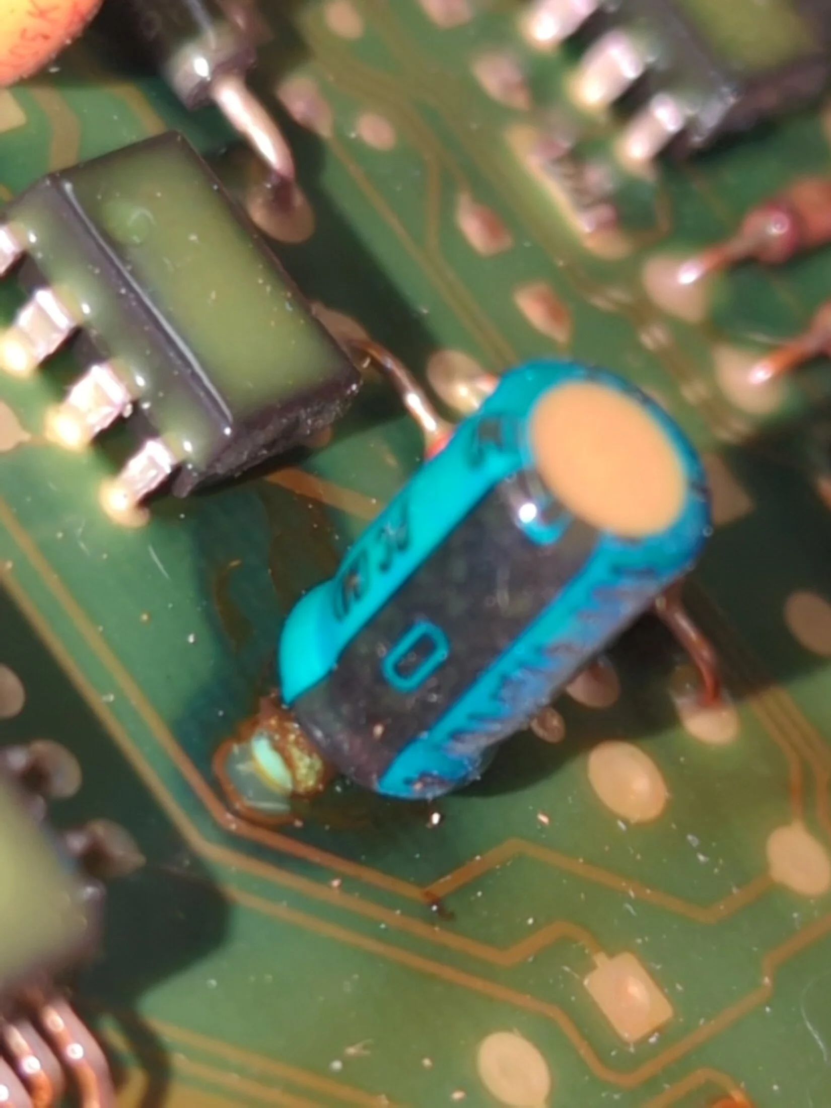

Just opened the computer. 2 caps are blown, with some board corrosion. ...
Off too ecu exchange it goes
Sounds like once you get your ECM overhauled it should run real good, those caps look bad just like on my 91, is there a website or article or anyone that knows what every component in these ECMs does and what functions they are responsible for? I would love to see something like that.
Yeah mine runs fine but it has this persistent minor idle issue and everything has been checked replaced and triple checked and I opened up my PCM and some of the yellow Chiclets have corrosion plus the capacitors look bad so that's my next step, might do it beginning of the year .

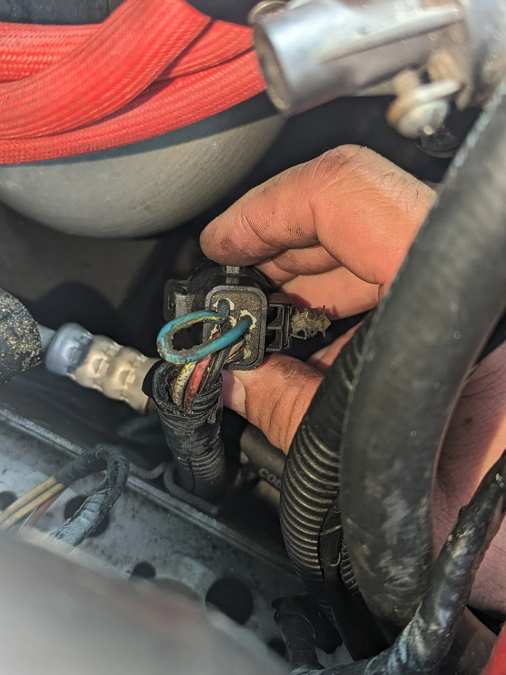

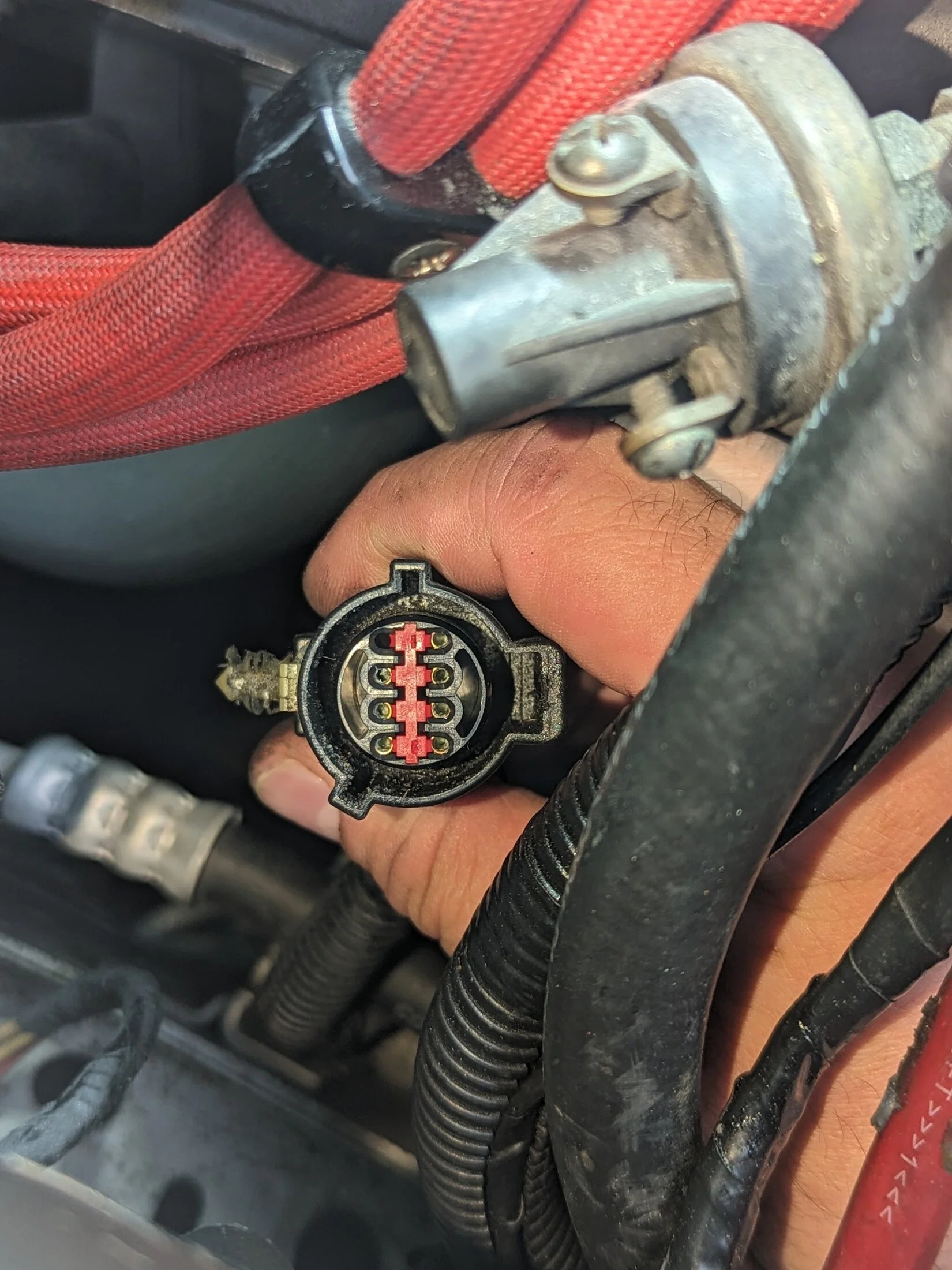

@Mustang5L5 I think I found an issue . . Does this O2 harness look wrong to you? tryin to compare to your write up but want to be sure
