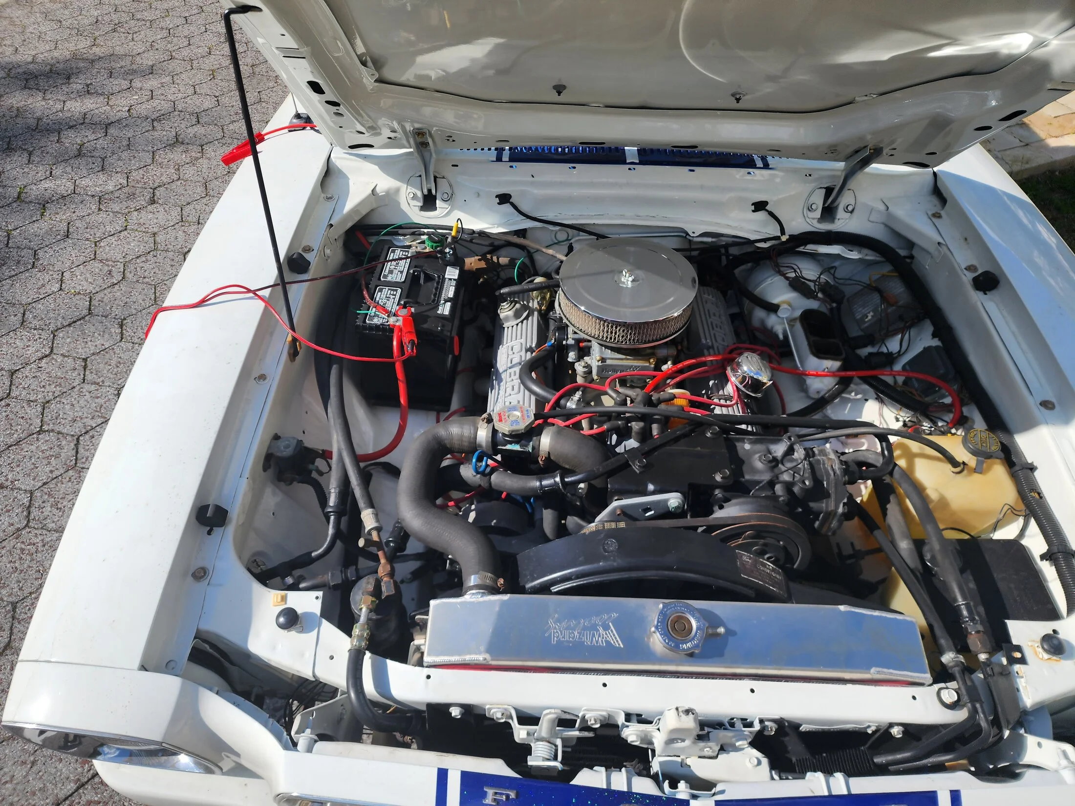

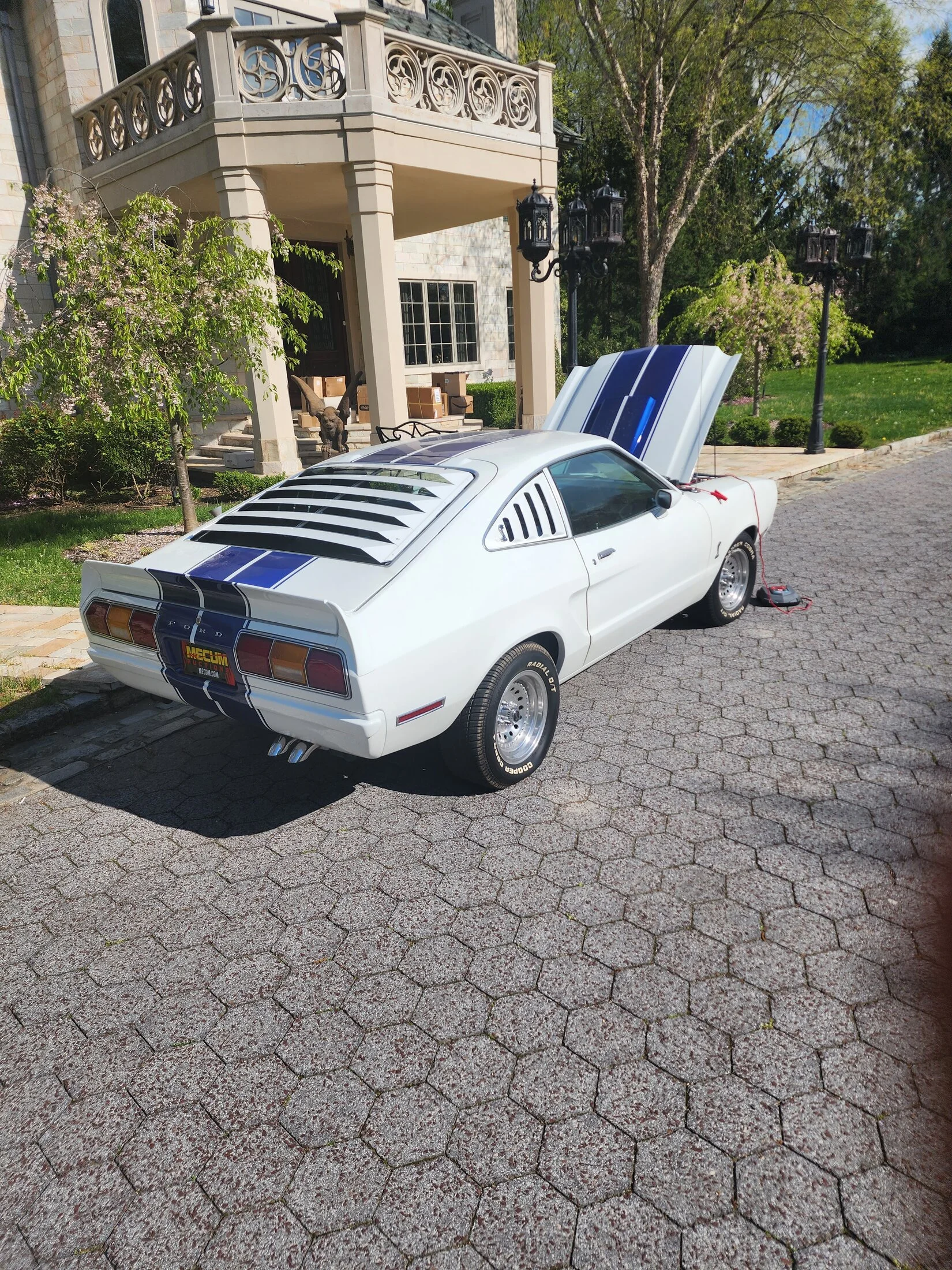

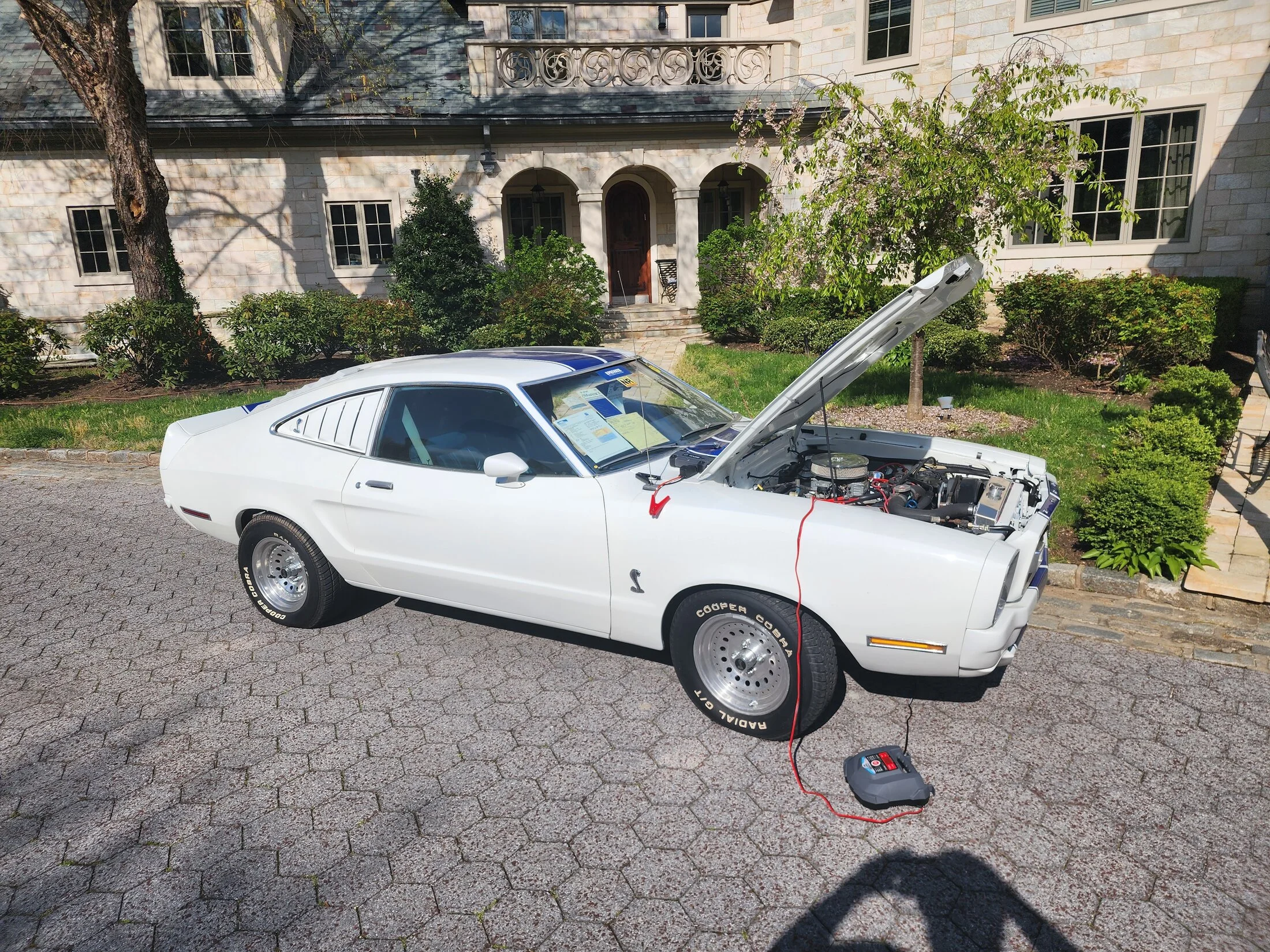

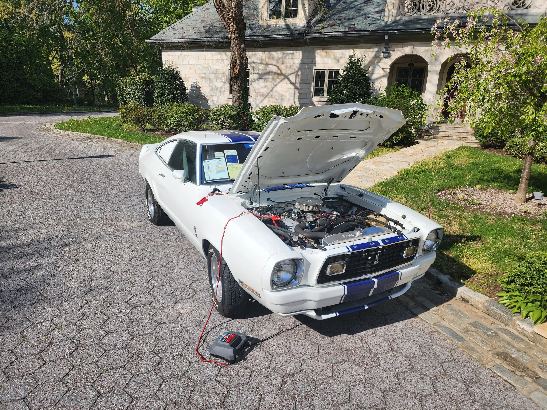

I'm back. Family stuff took a priority
Here comes some pics
