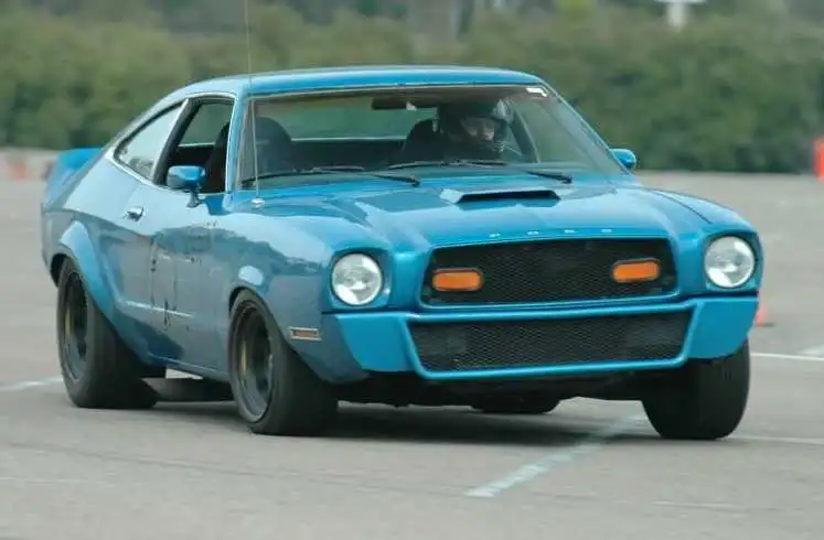

Congrats to Alcino for getting a pic of his car in the current issue of "Popular Hotrodding"! Its in the "Hometown" section (Readers' Rides). Its a great pic of him Autocrossing.

I always wanted my car in a mag and finally just sent a pic. After I sent in that pic I got a call a few days later from the editor asking about my car. He said that he was doing a lot of write ups on expensive cars and wanted to have a more budget minded project that reflected more of the readers rides to balance out the mag and thought my car was perfect. I tried to back out of it saying that my car needed this and that to be worthy of a mag. He said no, leave it the way it is and bring it over.
Next thing I know I'm driving to L.A. for a photo feature. Also there, were three other high end cars all getting photos and tested ( big green car was too new to test) that day.
I know our cars get ripped for being the worst looking and performing, and I was only hoping not to continue that thinking. How did I do? Read about it in the next (April 2006) issue of PHR. I surprised a few people including myself.

very nice:nice: . i do like the front bumper trick but my other question is where did you get those rear fender flairs? i'd like to put flaired fenders all the way around.i'm going for the road course look and with fender flairs i can add some serious meats at the four corners.
manny,
I got the fenders from a bucket of bondo and a sheet of fiberglass. If I could go back in time I would have just tubed the rear and left the panels alone. Gives way more room to raise the tire in the well to lower the car. But, everyone likes the look of the flares.
Also with wide tires all around you need to be careful with suspention geometry. learn about scrub radius, camber gain, and instant center before you start making big changes. I'll tell you now that deep dish wheels in the front is a suspension no no.
Alcino
I feel our cars are small enough to use relatively small tires to handle great( I like to reduce unsprung and rotation weight as much as possible). At the moment I'm using 205/50/15 in the front and 225/50/15 in the rear. Very small for the "pro-touring" theme, but as you will see in the article I did rather well. Remember that tire compound is where you gain greater grip than tire width, and I use Toyo RA-1's which are an "R" compound. I used to have wider street tires and never could get close to the handling I have now.
As for the deep dish wheels in the front look at all the modern cars. Notice something? Shallow wheels ( at least in the front anyway). Why? Well there is lots of theory, but the gist is that
1. With a shallow wheel you can have the ball joints closer to the centerline of the tire tread. This distance is called scrub radius. the closer it is to zero the easier it is to steer (I know people that have power steering problems all the time), and the less bump steer you notice(car does not pull to a side on an uneven road or under braking)
2. With the shallow wheels and the ball joints farther out you can have longer a arms so that the suspension will have a more stable instant center over a greater suspension travel( car will feel more predictable and stable at speeds in turns).
I'm not an expert on this suspension theory, but I know people who are so if anyone has questions feel free to ask. you can also find more info in the www.pro-touring.com and www.corner-carvers.com forums.
Alcino
