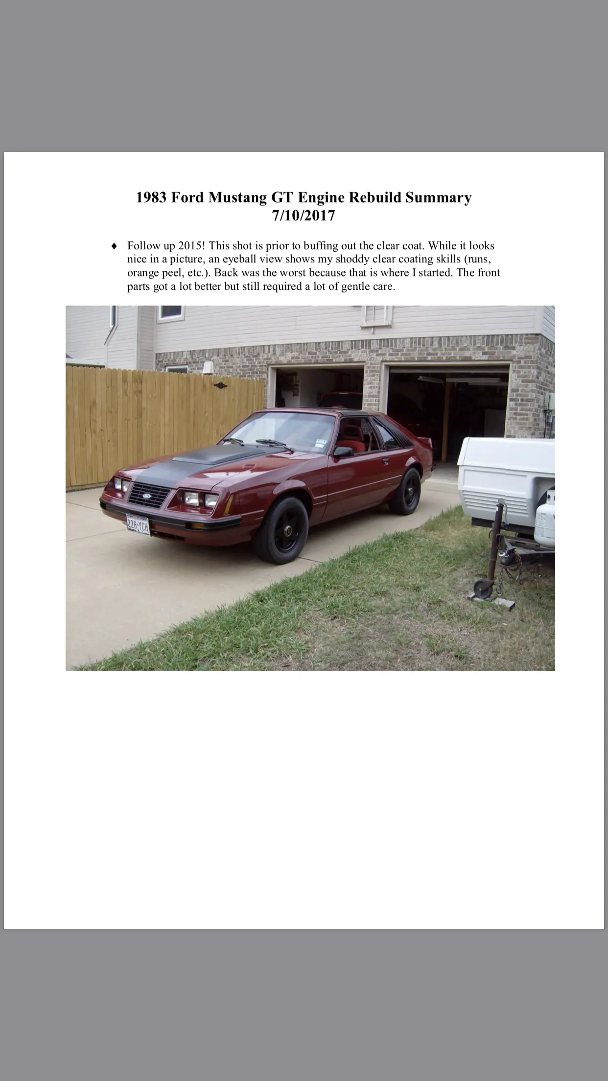

To help me with my upgrade choices, I used the CompCams Camquest program/GUI (screenshots in the attachment) which estimated my HP and torque at ~400HP/380ft-lb respectively. Sounds pretty impressive but I think it is a bit optimistic. Long story-short, I love the performance of this motor. I’ve got over 5k miles on it already and it runs great. I don’t bang on it too hard from stop lights (in order to preserve the T5) but when rolling along this motor screams to 6000RPM with impressive power! The carb might be the weak link but I have it tuned (with the rod/spring/jet kit) so it is very driveable (EFI is too pricey for me).

I think the calculator is being generous, but you may be close. You are probably near the 300 rwhp mark (350-360 at the flywheel).
The important thing is that you love it and are enjoying what you have done. Lets see the car! Original owner '83, and the stock engine went 220K miles??? Very cool!

Thanks guys! In my initial post, I attached a PDF report of what I've done to the car (with lots of photos).

My bad, I didnt download the pdf initially. Youve done a lot of work, and the car looks great. Glad you updated those old 90's wheels, lol.
For a T5, if I remember right, the parasitic loss is about 15%. There is one good way to know what your car makes...
This car is hot!

Very nice mustang:nice: You’ve got to love an ‘83!
I’m betting it’ll be in the 275rwhp range at best. Still, that in a 3000lb car is a bunch of fun.
It’s really cool that you’ve kept it so long.
I believe you should be able to pull out 300 rwhp with tuning of timing when you take it to the dyno. It sounds like to be a very solid and dependable rebuild.
