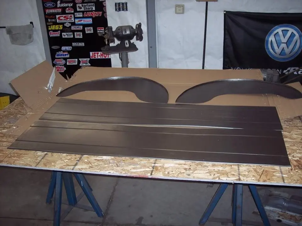

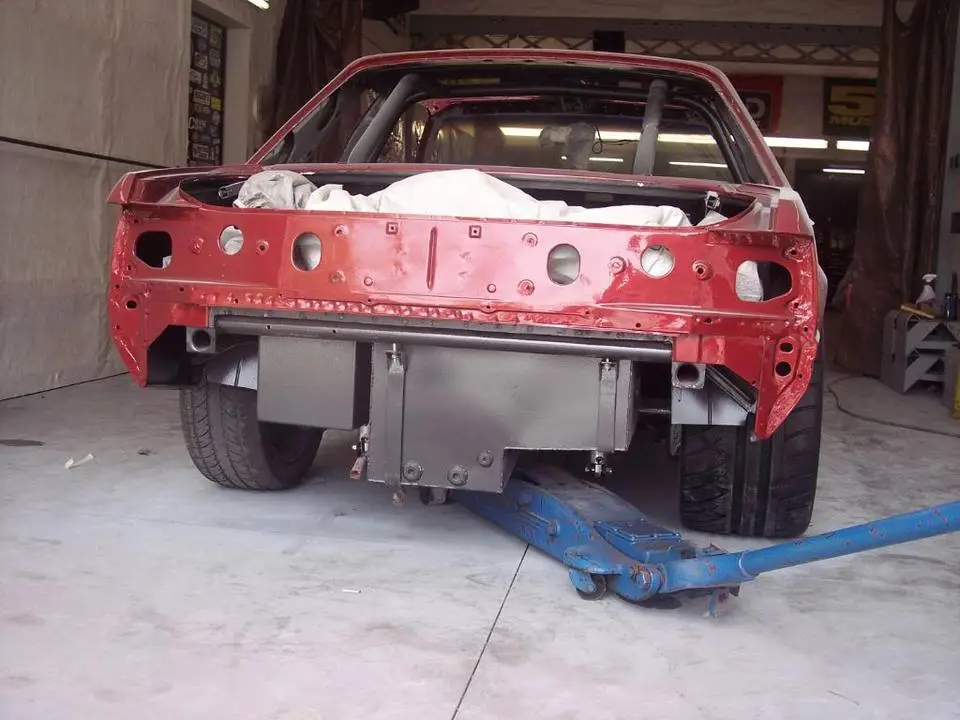

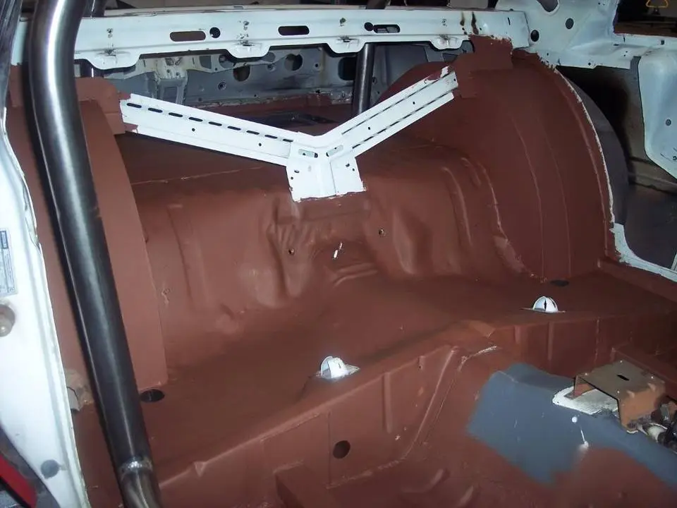

Oh ok. It looks pretty extensive under there. Well, I have another question...looking at this particular setup, is it required to switch to coilover shocks because it looks like the minitubs are going into the space where the stock springs would be? I wouldn't mind switching to rear coilovers tho. I just like to gather all the info I can before I actually get something like this done.

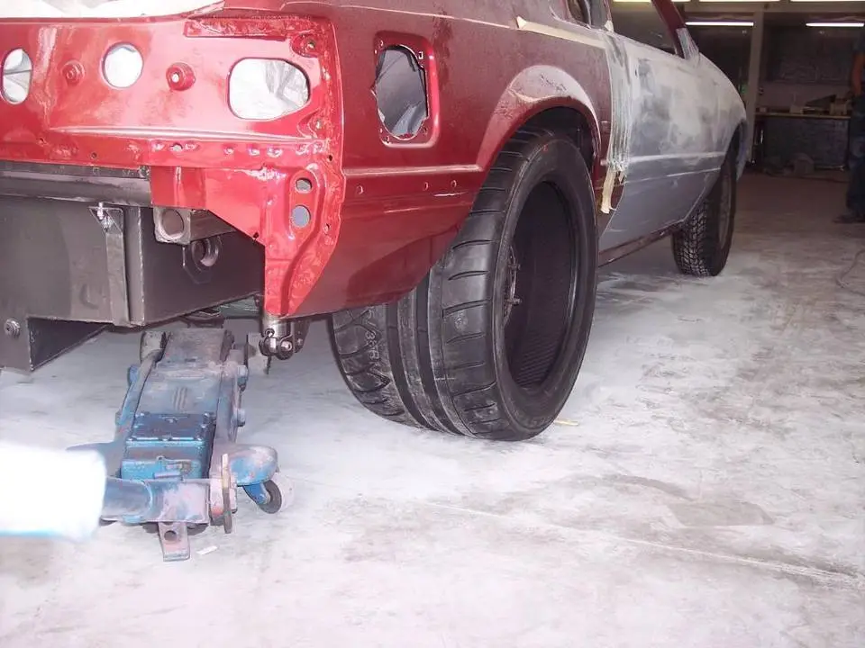

Yes, you have to go coilovers, everything comes as a kit, really wasn't bad to install...
Here's a shot from inside

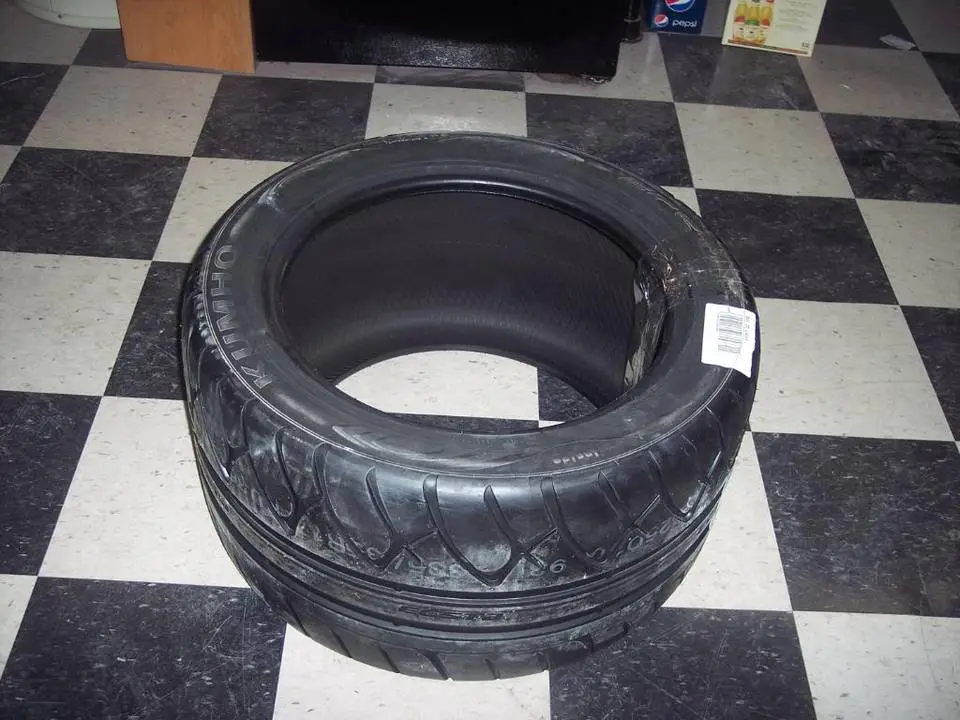

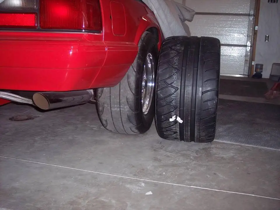

Big brown truck showed up yesterday, thought i'd have to wrestle the driver for these...

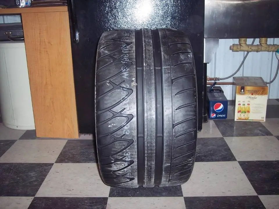

Discount tire had the best price,Kumho ecsta 335/35/17, might not matter what the rims look like

any bigger and the rear end would look like a snowmobile..

WOW that thing is going to look like a steamroller from behind... completely intmidating and utterly badass

We always wanted to do this on a fox, they are an unbelievable 13.5'' wide, to bad it'll be like a month til we can get em mounted ,by the time the rims get here and get sent out to Weld Craft and come back. Hopefully the wait will be worth it and the paint will be finished.

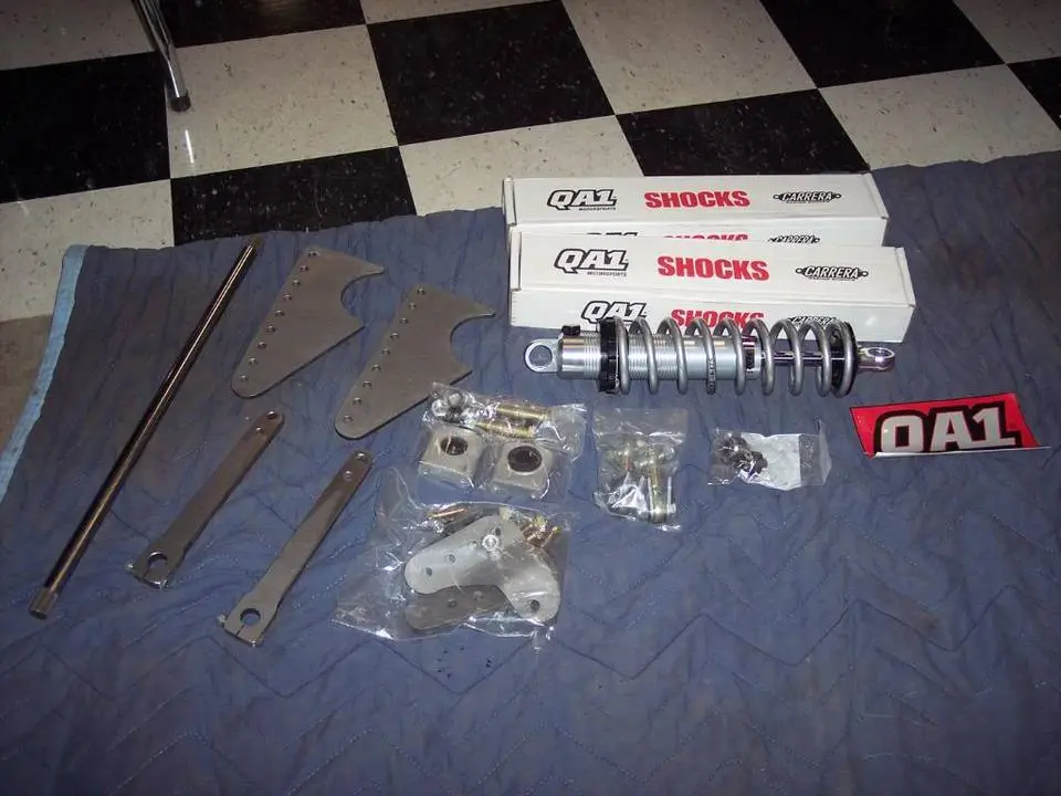

i searched auto welds site and found the tubs but didnt see there coil over kit. maybe i was over looking it but could you give me a link to it.

Not so good on links.
Go back to website, under new products on the left then scroll down to this...
'79-'93 Mustang
ANTI-ROLLBAR/COILOVER COMBO
There's a pic and stuff, going on their site gets me fired up, lots of stuff i want-beautiful stuff.

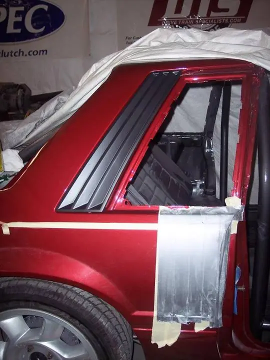

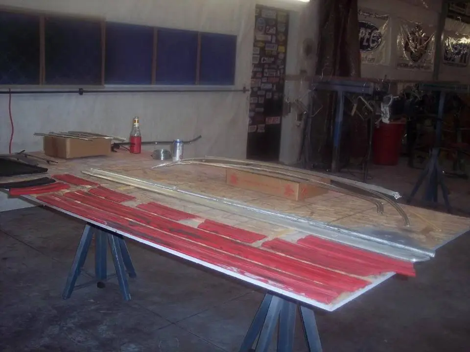

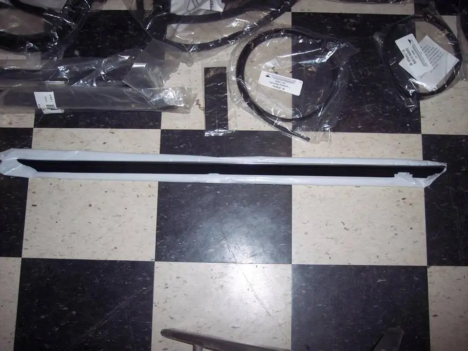

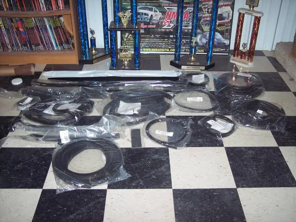

A few updates to get us off page 3, lol, it's always good when big brown shows up. Today he showed up with a complete weatherstripping kit for the whole car and t-tops from Fox resto, it is all sooo nice, just hope it goes together sooo nice.

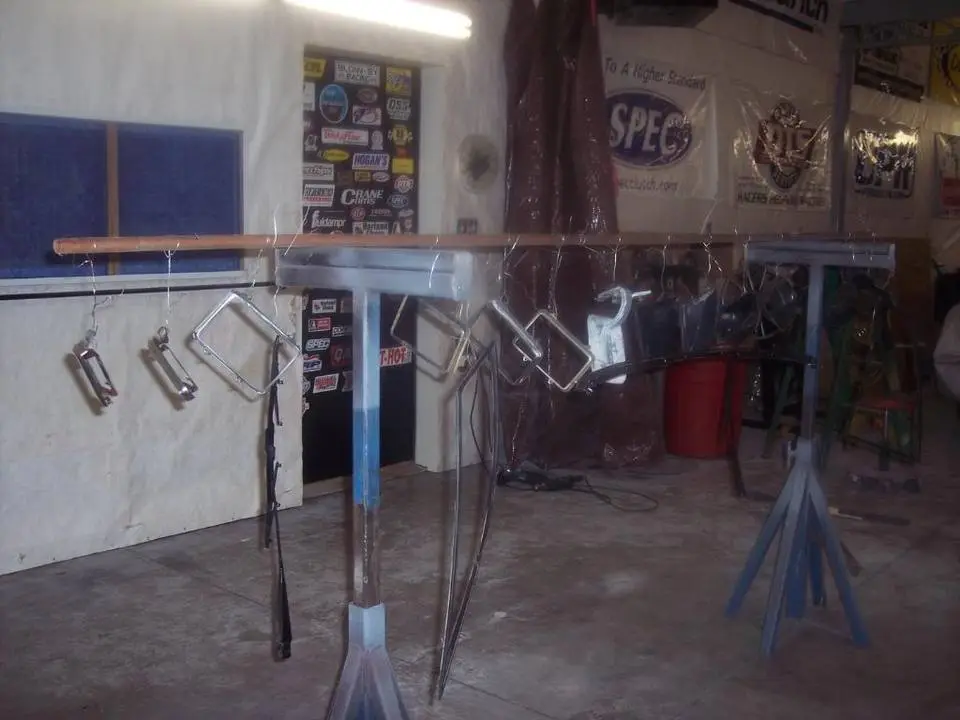

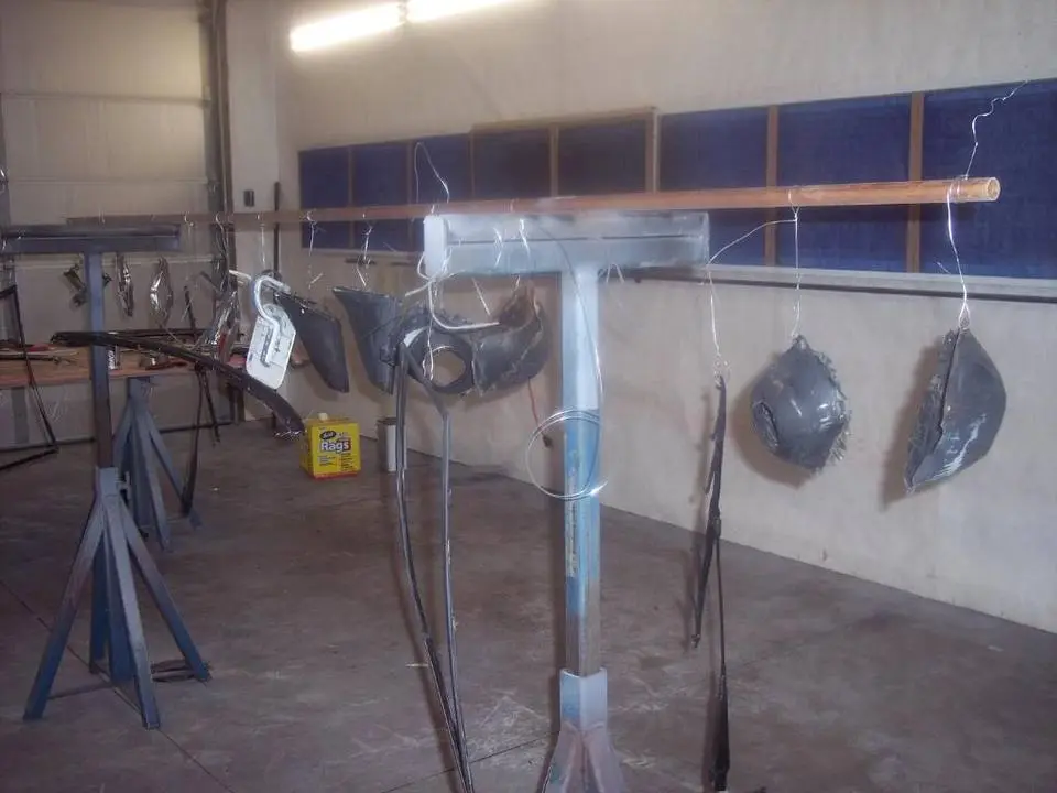

Have spent a lot of time and money getting the right shade of dk. charcoal for all the accents and motor, some will be base coat/flattened clear, to a semi gloss eggshell look. Today I had sucess with my paint store in mixing a single stage vinyl to use on trim and smaller things. Doing base coat clear coat on all this trim and small stuff was turning out to be a real pita. So here is the vinyl paint on the sail panel, great looking stuff and so much easier. Some people may not be fans of sail panels but for us it is a must on this particular car.

Let me know how you like (or how good it is) the weatherstripping kit. I need to save still for it, it's huge coin for the t-top kit!

Get ready to put the hurt on your wallet, that weatherstripping kit was a killer.
The mini tub kit is not that expensive, it's the labor if you can't to it yourself.

was the weather stripping kit 470$? im looking at the one from blue oval, eveyrthing just piles up on you, its seems everything I buy is 500 bucks, I dont even want to know how much you have in your car, im up to 9k, and still have probably 3 to go.

The kit from Fox mustang resoration is 699.00 but includes everything plus t-top, and trunk. Got a discount from Foureyed Pride forums.

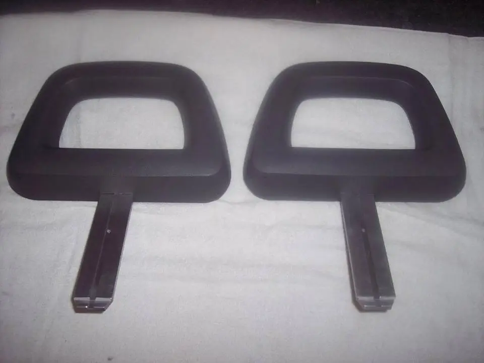

More things are arriving daily...
My neighbor does custom interiors, and he has had several interiors in magazines, he has agreed to do the seats, and a very interesting customizing of the back seat to accomidate the minitubs. Have spent alot of time sanding all the little parts, all are primed now and all of the dk. charcoal stuff is painted.
Possibly all body parts will be done this week and ready to go back together.
