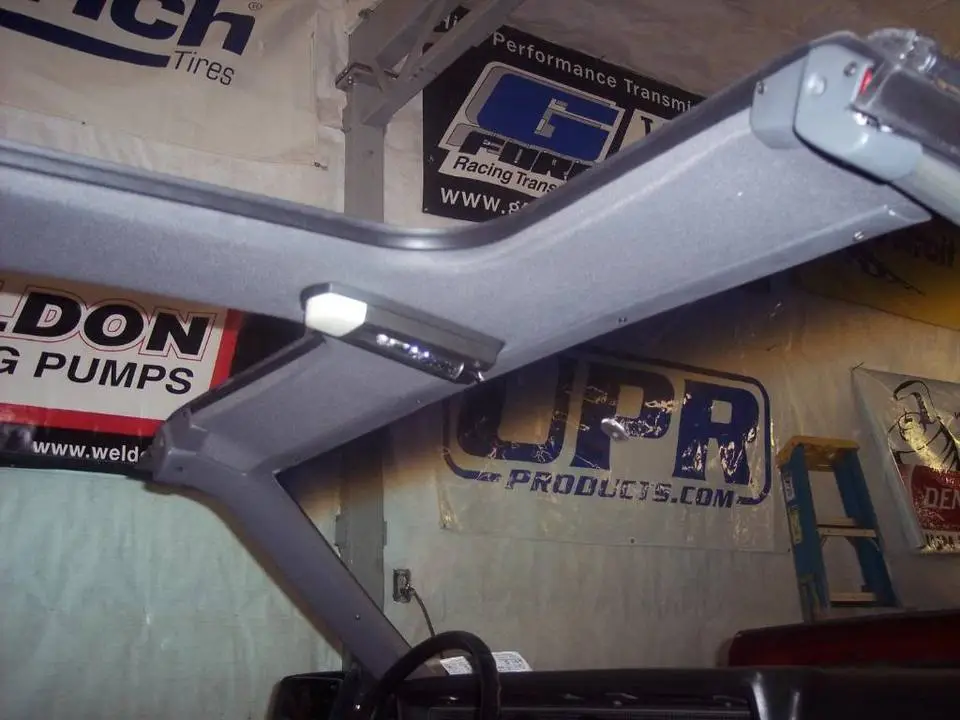

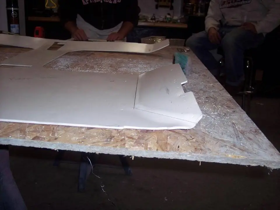

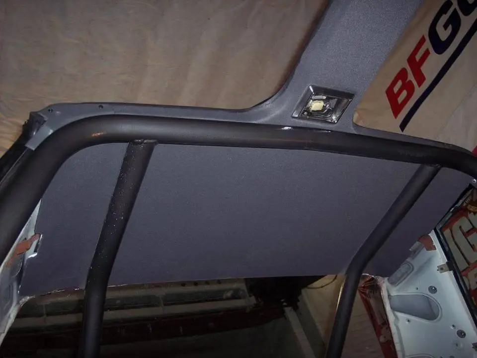

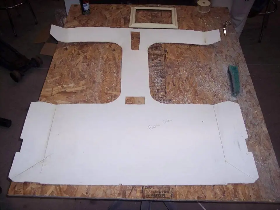

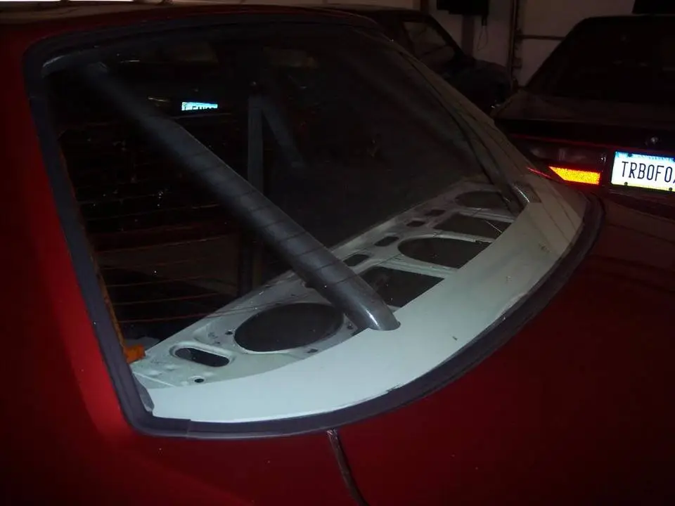

I've been struggling with the idea of spending alot of money for a replacement headliner backer board, especially since 75% of it is gonna get cut away with the t-tops. Got hooked up with the local vinyl sign shop and it turns out they have this awesome stuff. This stuff is a very compressed foam. It looks and feels like plastic, it is water resisitant and can be scored and formed with a heat gun. I used the old headliner board as a pattern and cut out with a hand jigsaw, scored the places where I needed it to conform, then put it in the car and used a heat gun to get it to conform and presto a headliner backer for 20 bucks. I'm gonna use this for the trunk and the doors as well. Comes in a 4X8 foot sheet and he sold me half a sheet for 20 bucks.

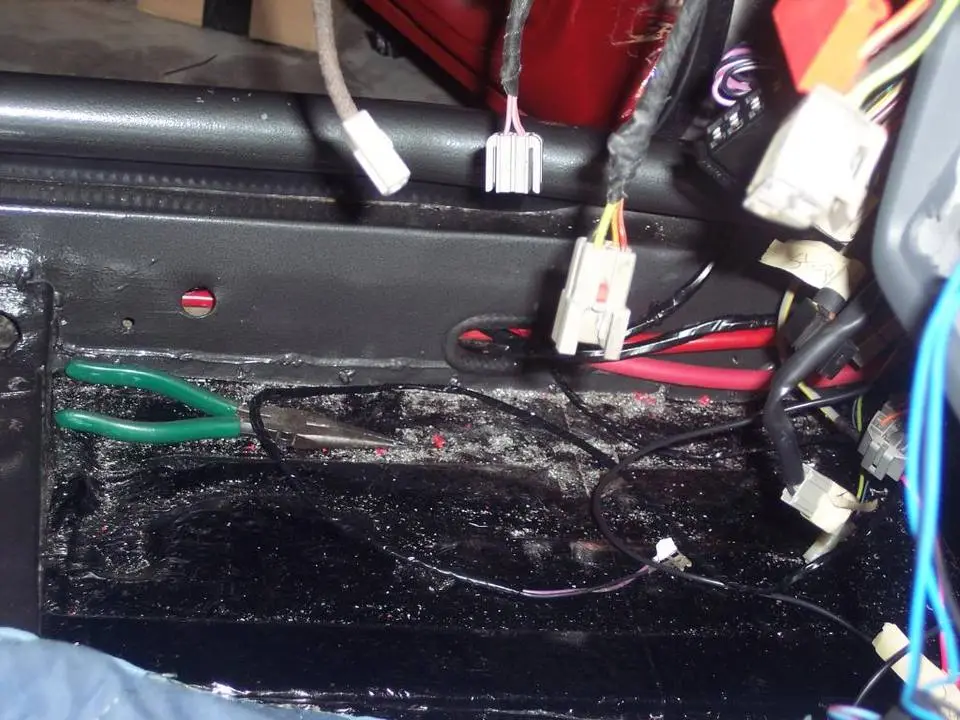

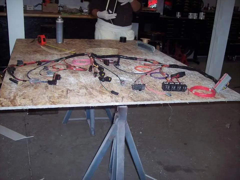

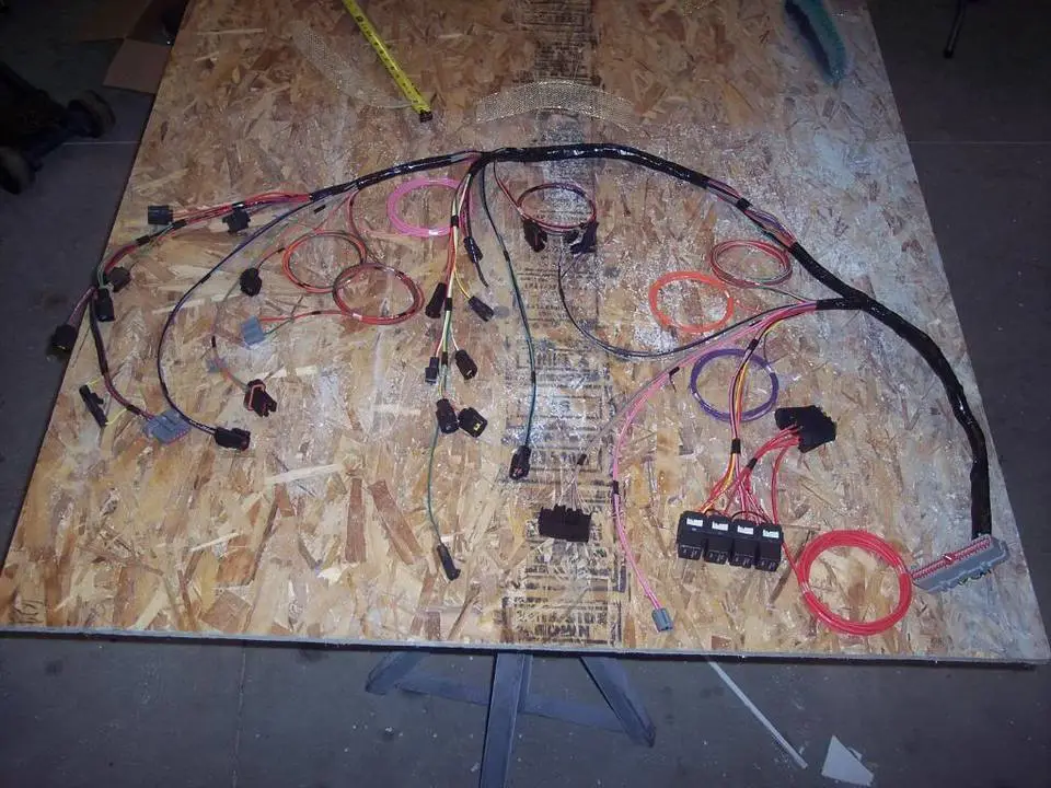

Recieved the new engine wiring harness from RJM out of Detroit, it's a beautiful thing.

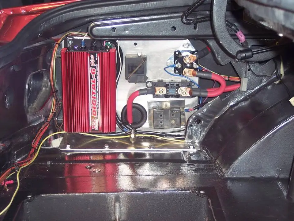

I fabbed up a panel for the trunk to mount the MSD box,the fuse, a breaker box, the selenoid and the module for the fuel pressure shut off. THis is going to better access than the way I did it on the 93, in the fender.

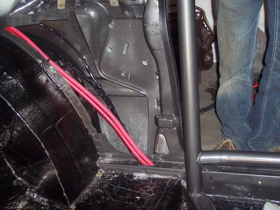

Got the battery cable and the wires run through the car to the front, and was able to stick all of it through the in floor subframe which was good.

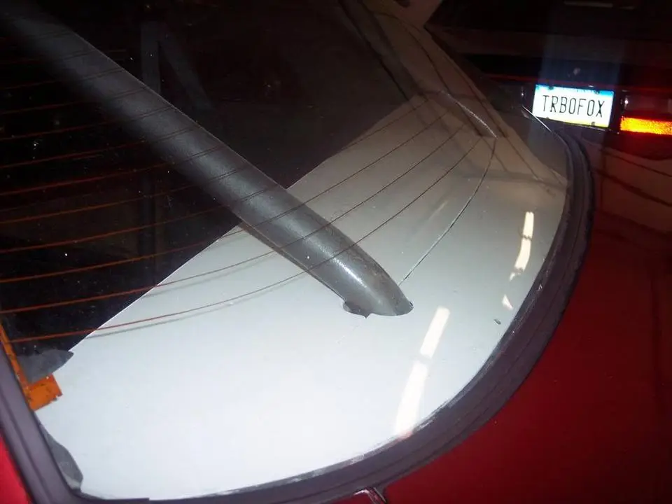

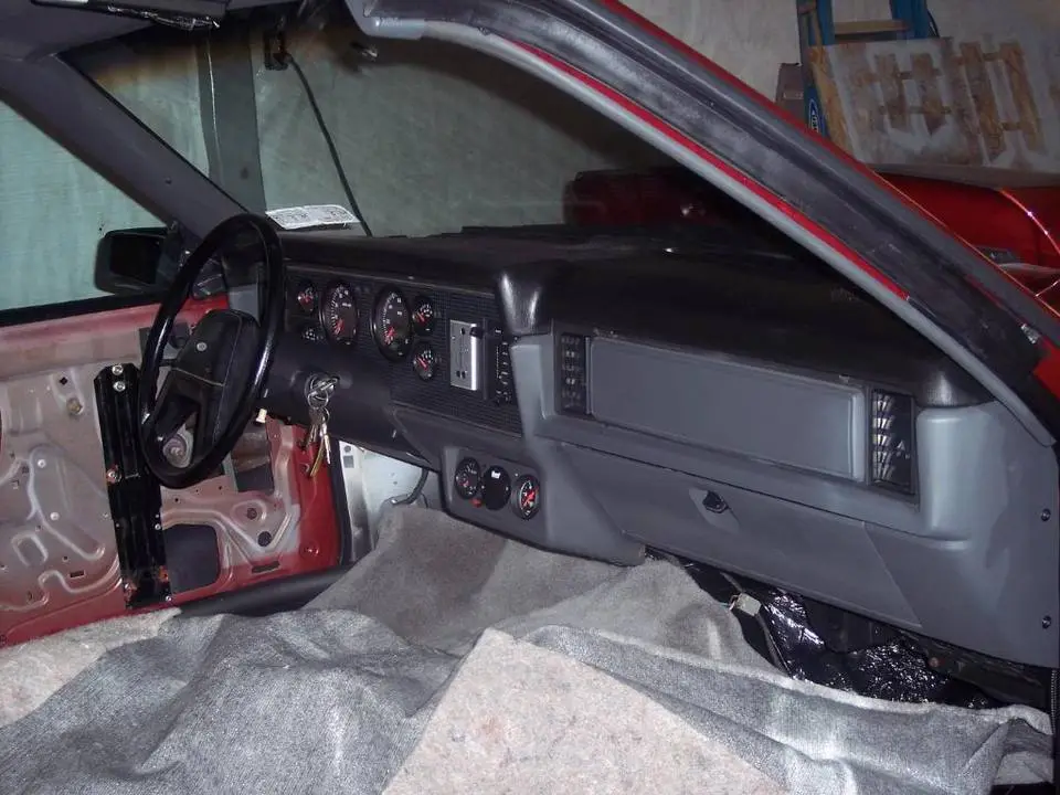

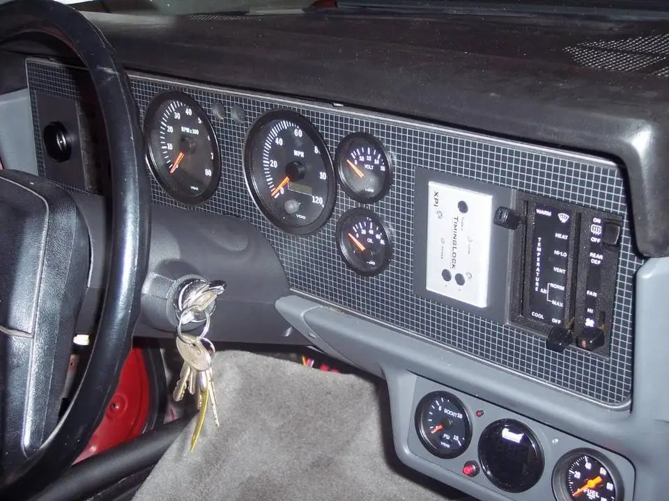

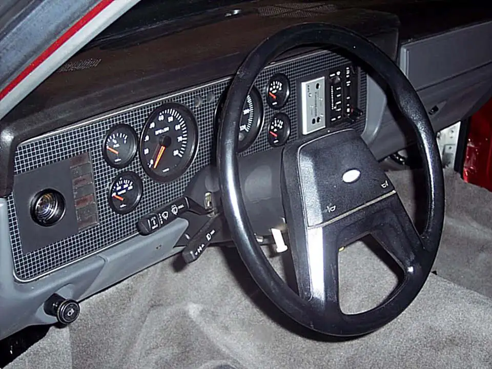

Just a few updates. Got the headliner done, came out really good. Also got the dash installed.

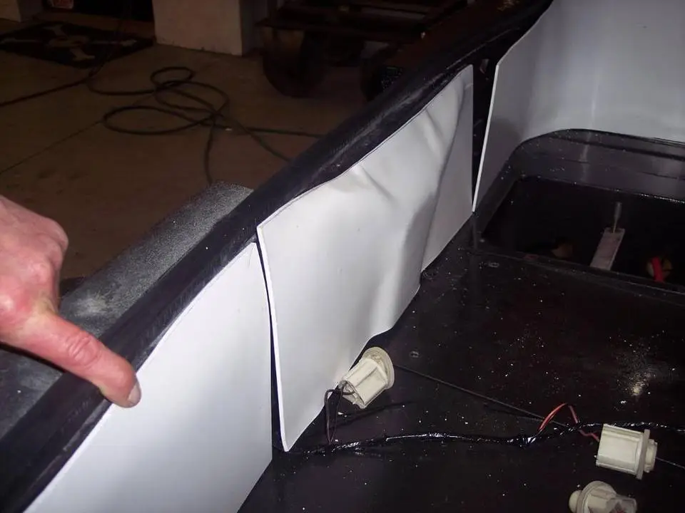

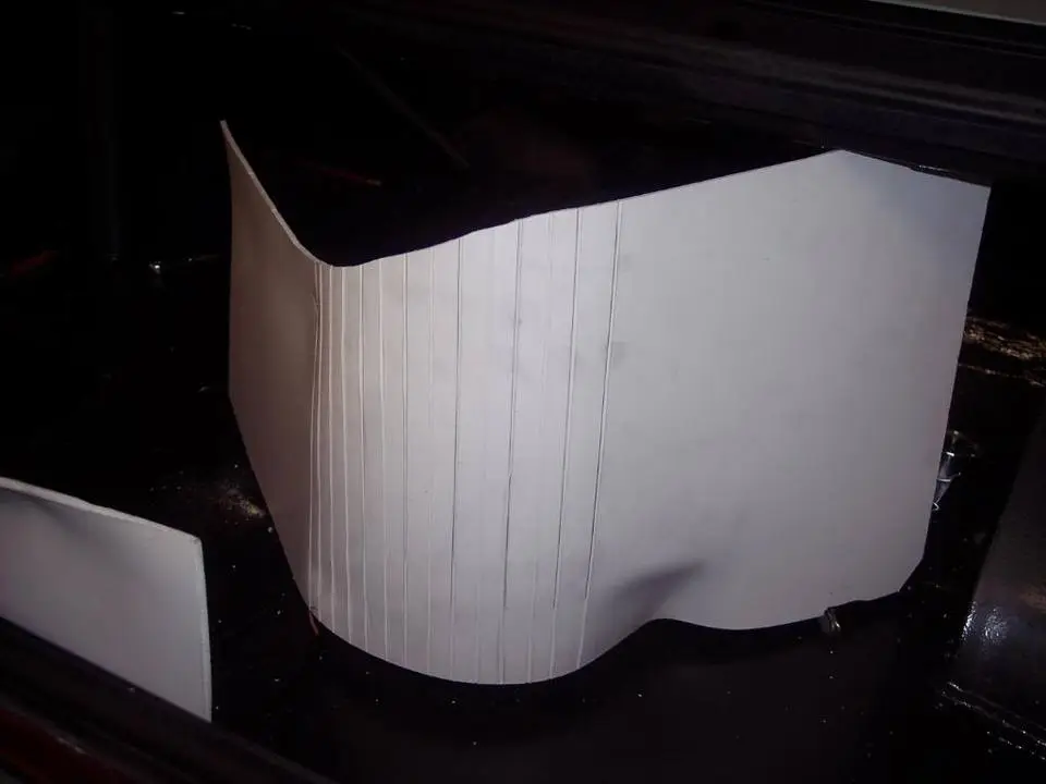

Decided to do the rear package tray in 2 pieces, and it will be covered two toned to match the seats. Used that same board as for the headliner

uuuhh wanna come to my place to do my t-top headliner? wow nice job. Dash looks nice, I say keep the spock steering wheel!
Thanks. Yea, the Star Trek wheel is a keeper.

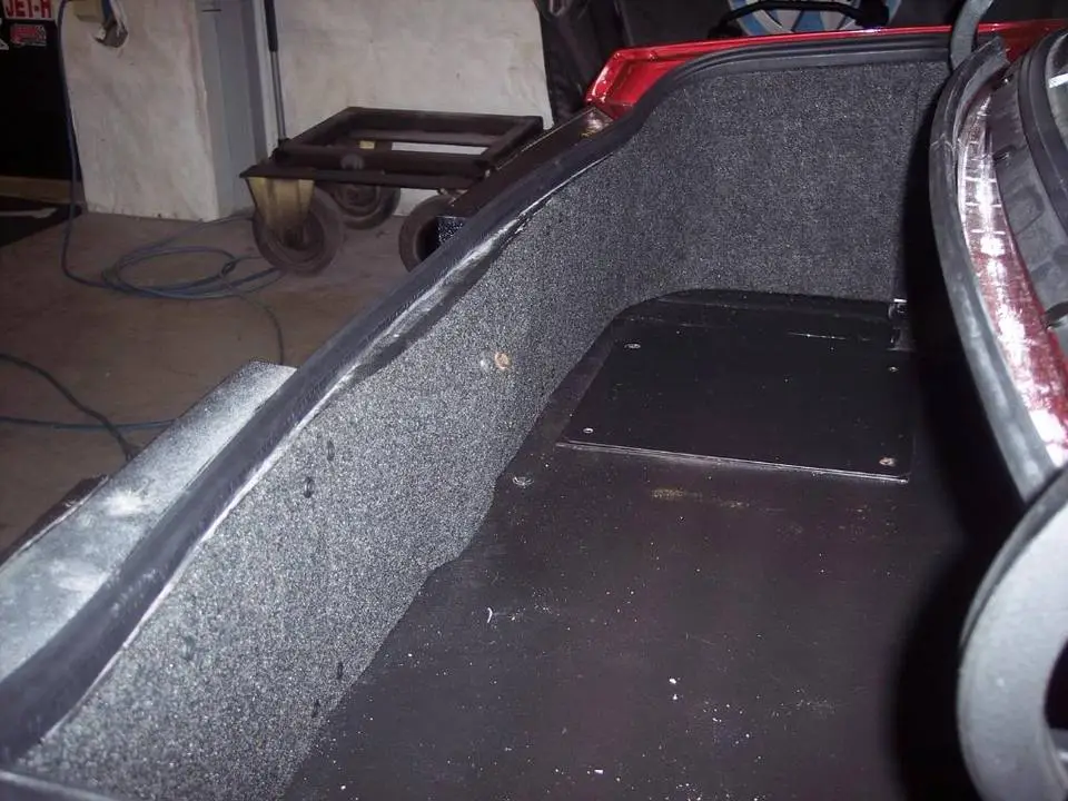

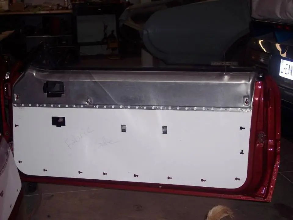

X2. Guess you'll have to settle for door updates, for now. Got the new door panels fabbed...

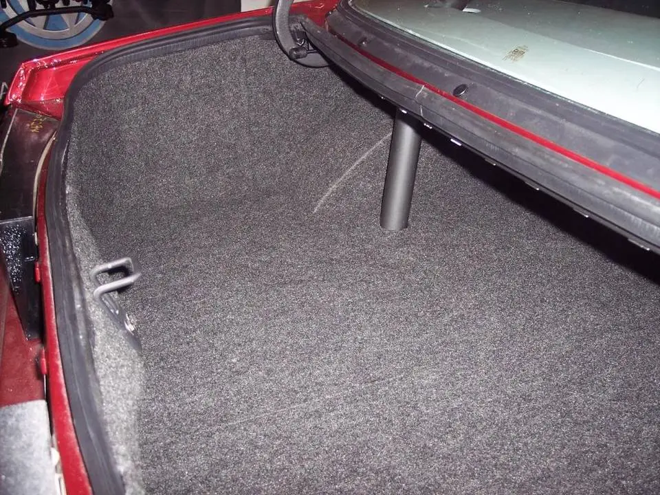

Using this same stuff to finish the trunk, since the trunk came minus an interior...

what is that white plastic you use for the panels?

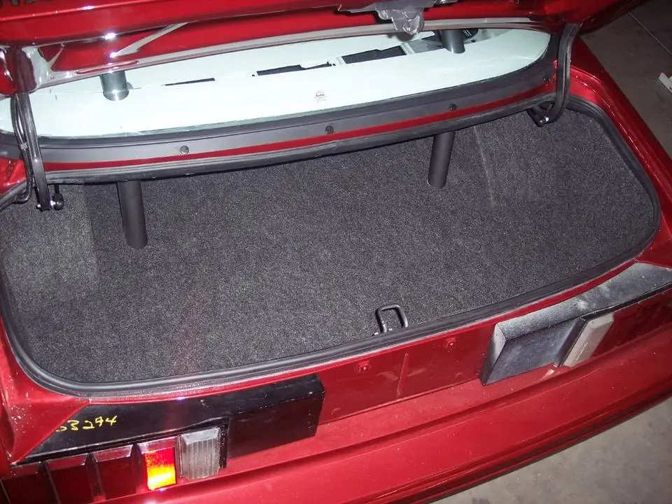

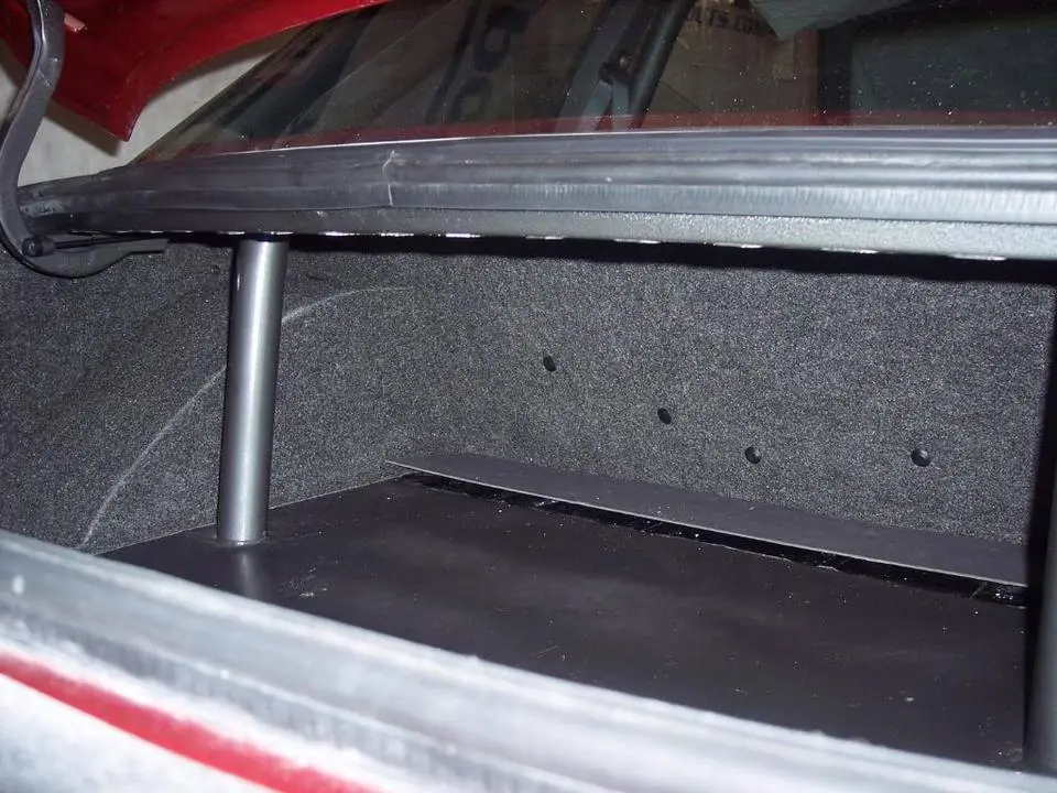

I think it is called Komotex. The stuff is great. Here is the finished trunk.

Dang man. That looks freaking good! You would never guess all the electronics are hidden behind that cleanliness!

Looking good Terry! Looks like you are well on your way to completion. The wiring on the last page looked like when you used to spend a week wiring a harvester. That was never a good week! Good luck with the rest of the build!
