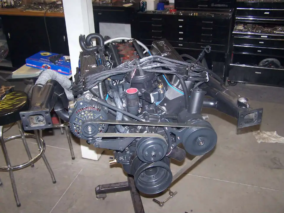

The stock covers angle in on the corners, and hit the edge of the rockers at each end of the heads, new ones on the way. If it runs, we'll be out.

Well the new ones aren't fitting any better, working at removing some bulk on them, if not maybe using a spacer. Talked to Performance Automatic about rebuilding the stock tranny, they said I'll never do it with an AOD have to go AODE?

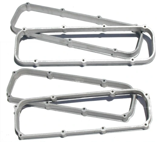

I tried 3 sets of covers to clear my harland sharp rockers until I went to an intake spacer and then the ford racing tall covers. You should look at a set of those VC spacers and keep the shiny ones you have.
Here's just an example:

I ordered the spacers. The other car has a T5 with a G-force upgrade. Got no experience with aod or aode, at this point it will cost as much to sawp to a stick though.

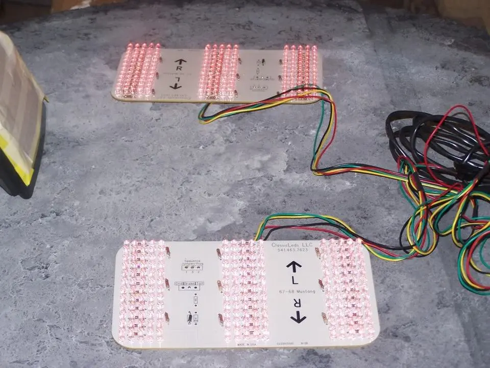

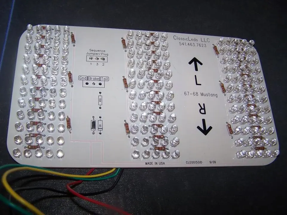

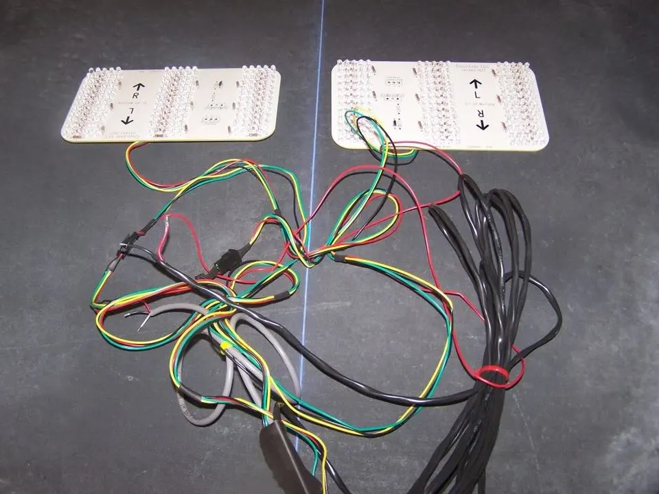

We got 79 tail lights for the car in hopes to make them LED sequential, started doing it myself til we accidentally came accross this company, called North west Mustang LLC. They make light setups for classic mustang, got to thinking maybe 67-68 setup would be able to work, and it does. This is a real nice setup.

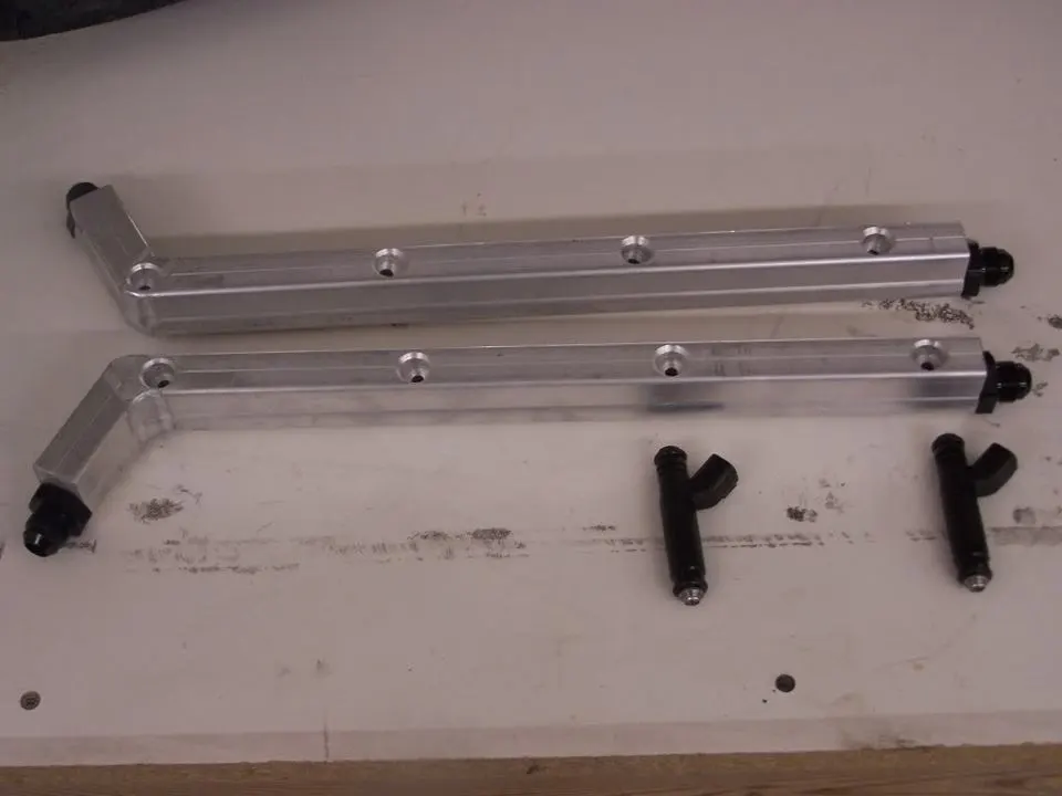

Decided to save some bucks to go against a new tranny and fab my own fuel rails

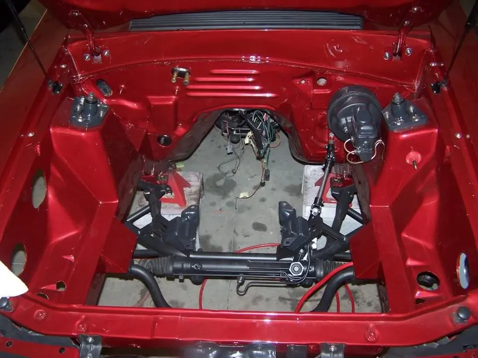

And I got a bay with stuff all painted up the right color,no windshield wiper motor showing and a crap load of turbo piping holes cut in....

no kidding! fab your own fuel rails?? my god, I wish I had 1/1000 of your fabricating skills.

What kind of machine did you use to make the injector holes on those rails? And how hard was it to bore a hole all the way through them?

BTW, I'm really interested in seeing the sequential taillights. That's going to be badass.

Nice touch with the fuel rails!
You never cease to amaze me!

We got 79 tail lights for the car in hopes to make them LED sequential, started doing it myself til we accidentally came accross this company, called North west Mustang LLC. They make light setups for classic mustang, got to thinking maybe 67-68 setup would be able to work, and it does. This is a real nice setup.QUOTE]
I just came across this company, and was goign to use the same stuff to do my tail lights. I got a second set of 79-82 tail lights to mess with too! Good luck.
It is a nice setup and lucky the spacing is right for those lights.

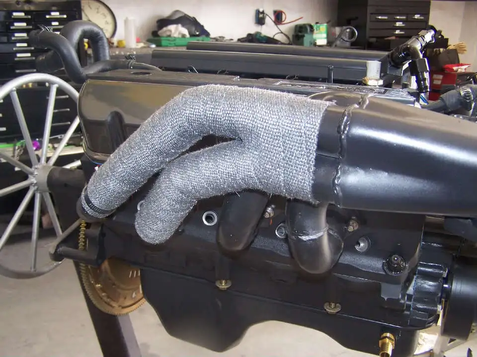

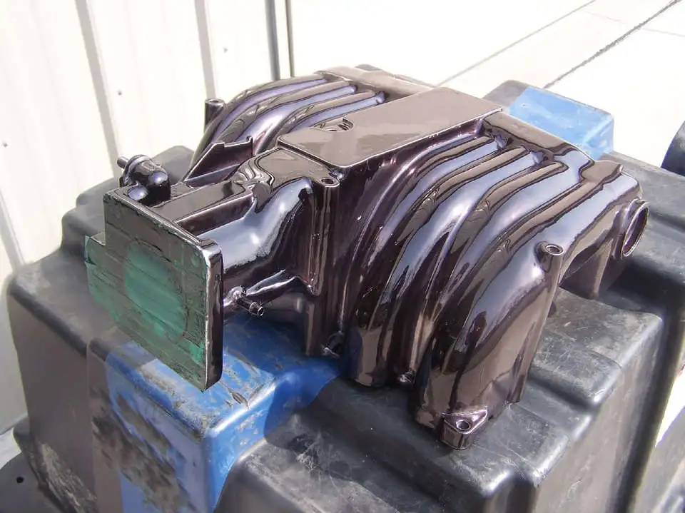

Well, we are getting closer, decided to wrap some of the hotside just to be safe with the engine bay paint
Been powdercoating stuff for a few car enthusiasts around here. When word got out we had alot of visitors.
Did this upper intake in solar rain for someone, also going to do some more engine parts and rims for him.
