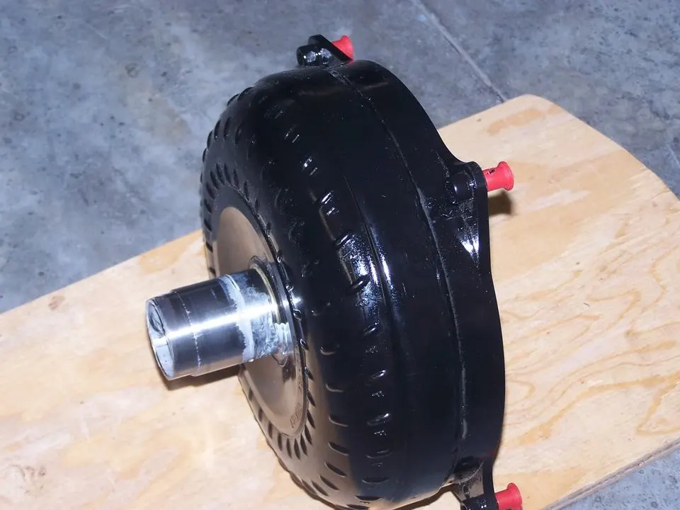

Thought we were gonna fire her last night til the wiring gremlins decided to fork around, my worst nightmare. Got an awesome tranny on the way too.

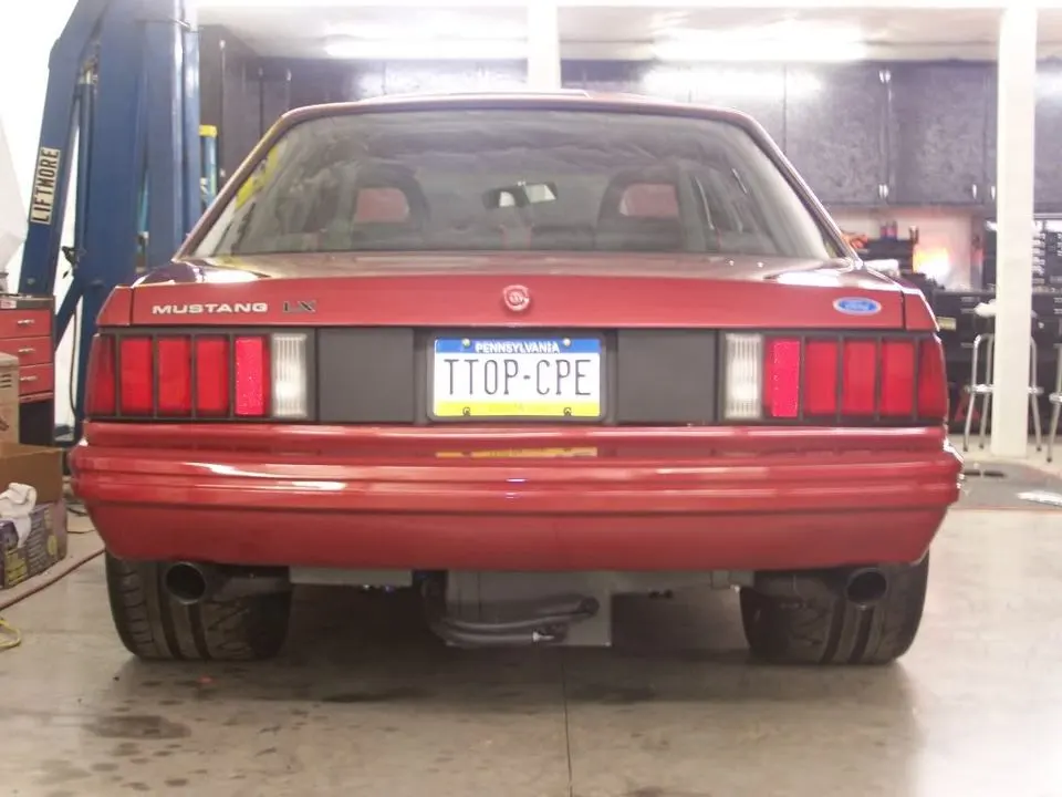

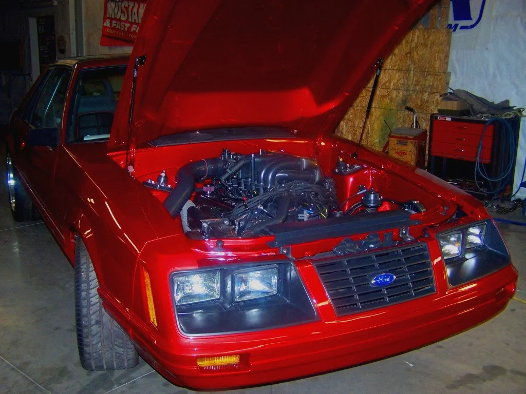

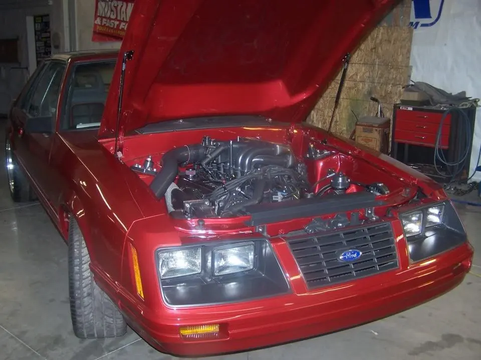

O.k. the good news is we are off jackstands, bad news is the wiring issue. The camera screwed up so I have no pics of the stance, but it is everything I dreamed and more, totally slammed. try for some stance pics tommorow, for now here ya go.
Sorry to hear about the electrical gremlins... I know how much you hate them!
I also touched up your pics to bring out the color of the car... Looking good!

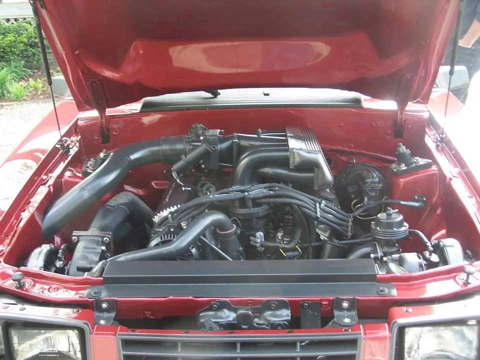

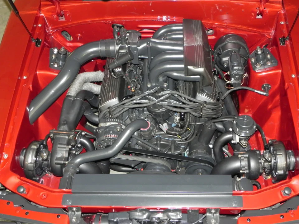

How come you filled in the vents on the back of the hood?
There are no vents. I have the same Boss hood. It actually has an opening at the back. From their ad:
"Boss hoods maximize airflow and structural strength by moving the rear portion of the framework 1"away from the firewall. This allows airflow across the entire rear section of the cowl for maximum cooling. Race testing has proven that this design will keep your inlet temp within 5 degrees of the ambient air temperature. This gives you a denser air charge for more power!"

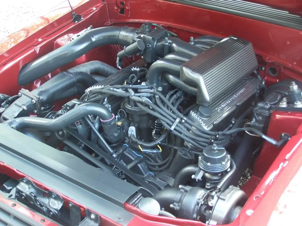

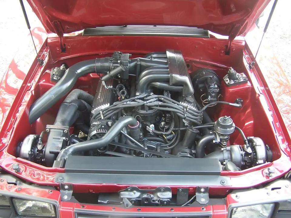

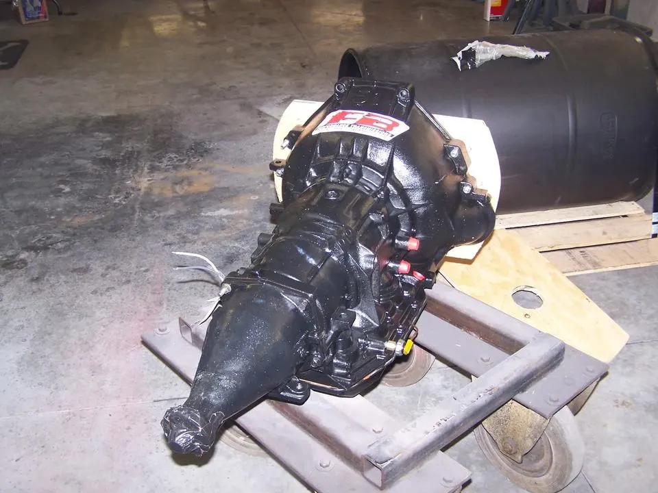

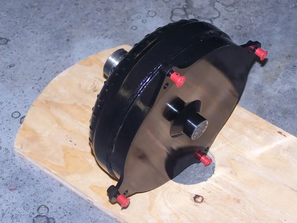

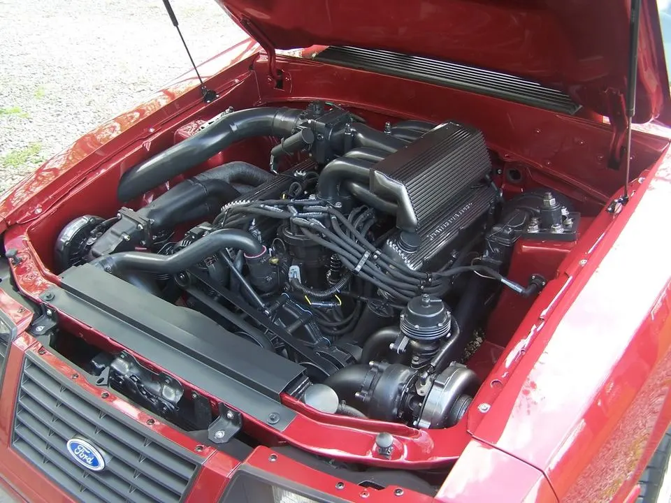

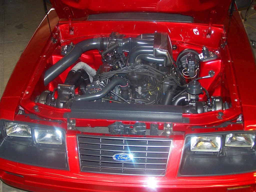

Been so busy dealing with issues, haven't had time for this. Turns out my XPI timing lock box was faulty, took out all the senders, the TFI and the stator,not fun. The stock computer does not like the 60# injectors, as it puts the car into a flooded condition on start-up. The only person willing to help me with a start-up chip was JLP, and it worked to start the car but then the air/fuel went to crap on idle, without the chip the air/fuel is perfect but the car is very difficult to start in the flooded condition, so we are still dealing with that. He is going to change somthing. Might have to resort to a PMS or somthing similar. Did drive the thing in and out of the garage to test the tranny, the exhaust sounds amazing. Here are a few shots from outside in natural light, and of the tranny, got new front tires and the stance is amazing, will get some shots of it soon.

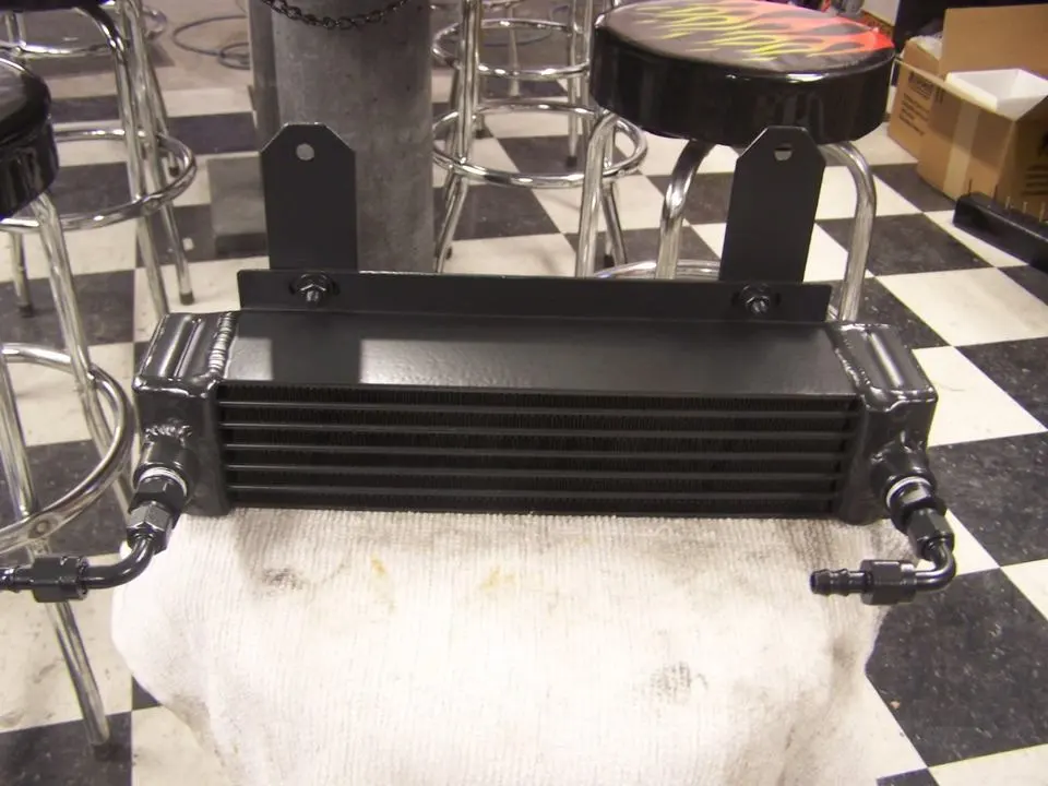

powdercoated the tranny cooler
