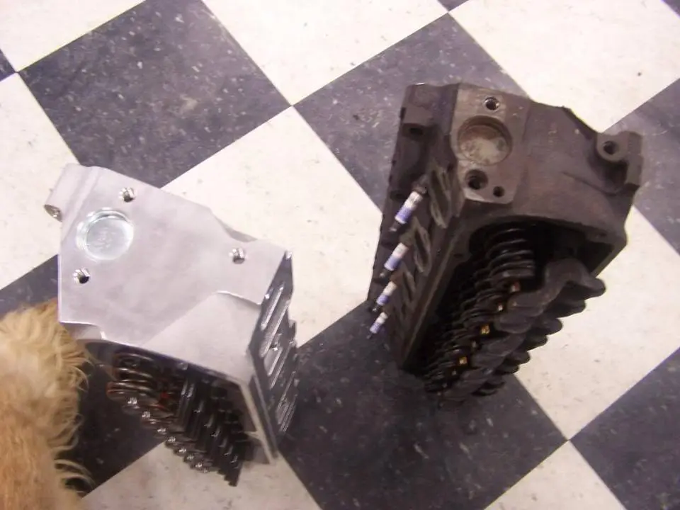

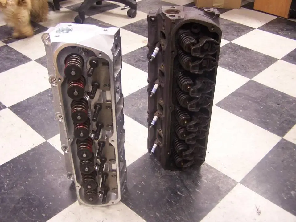

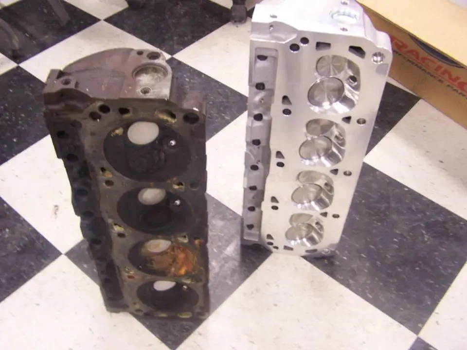

Thanks Bob. Well I can thank 1vetetr for turning me on to Ford Racing Parts Direct, they were the only ones that had a set of these Ford racing" Z heads" left since everyone was running an amazing deal on them.

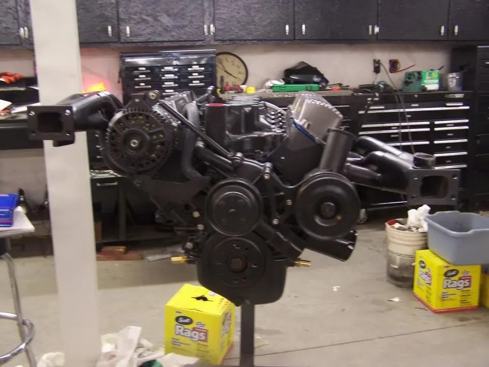

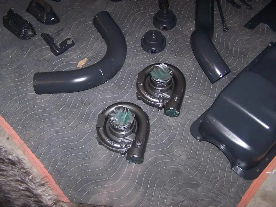

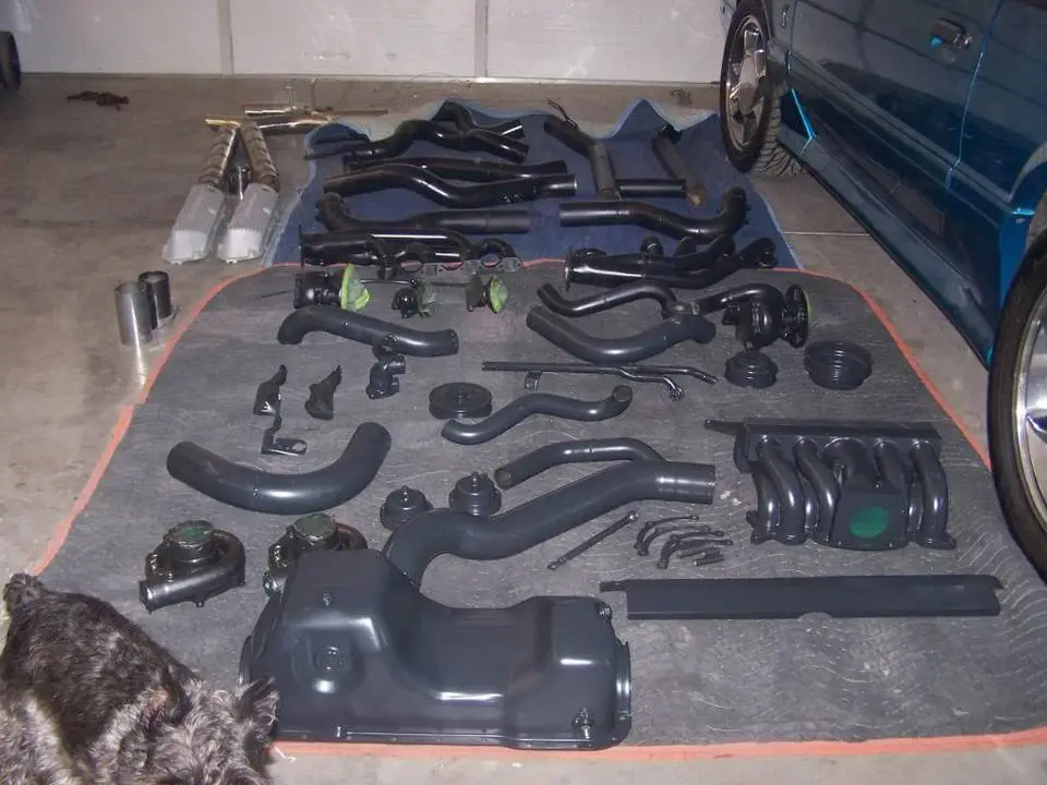

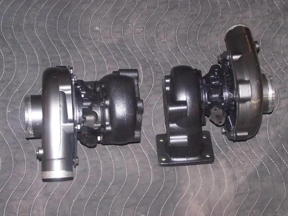

Got all the hot side stuff done with the TurboX coating, got all the cold side stuff done in powdercoat, and played around with some black chrome powdercoat for a few peices as well.

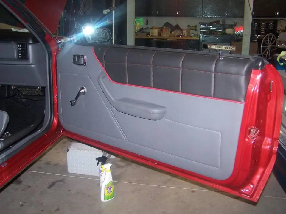

Door panels came back from the upholsterer, really glad we went this way, they still have a factory feel, but match alot better
Are you going for an all-Ford engine? Boss block, GT-40 intake, Z heads…
Ya know, until you mentioned it I wasn't really paying attetion, it just kinda happened, was planning on different heads, but couldn't pass up the price on the Z's. Well with what came in the door today, I guess it's loking that way...

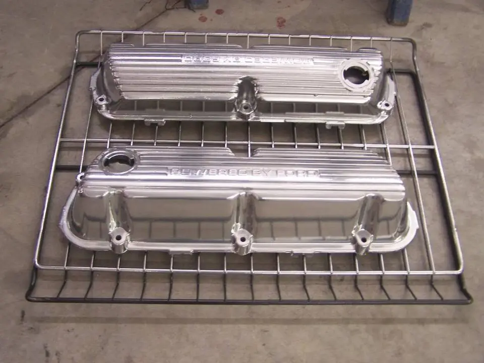

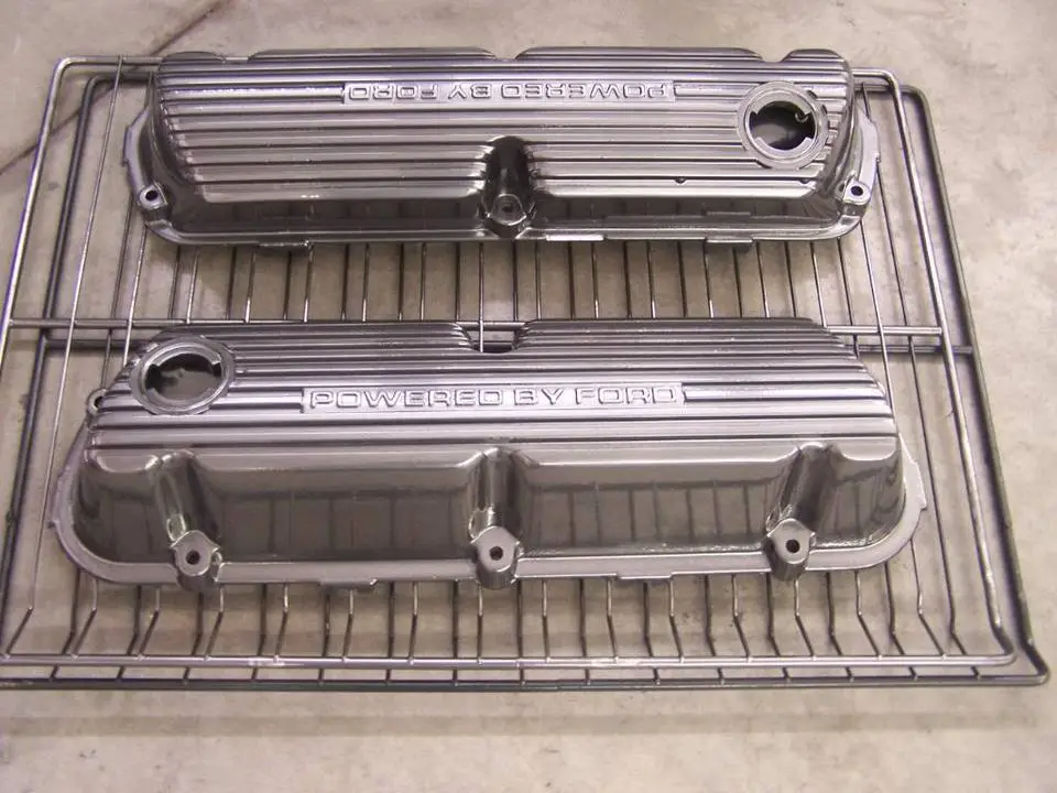

Was playing in the powdercoat, you actually have to powdercoat in chrome first to do black chrome, or you can go over real chrome or stainless. Here are the valve covers, first with the powdercoat chrome, then the black chrome...

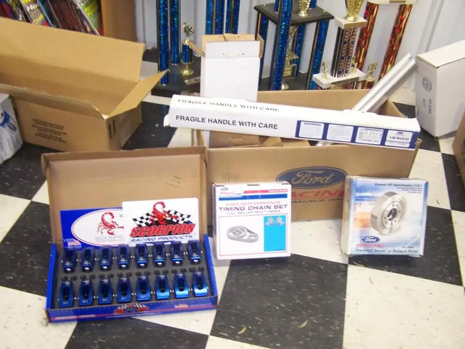

Oh yea, this came today, there was no worry about availability...

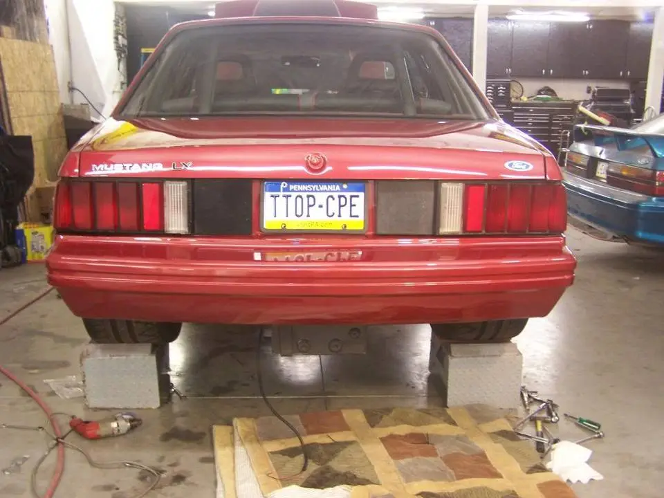

The VCs look great. Funny you posted the plate, I was actually just looking at personalized license plates. Here in Indiana though, if I were to register for one today, I wouldn't actually get it until January 2011. :notnice:

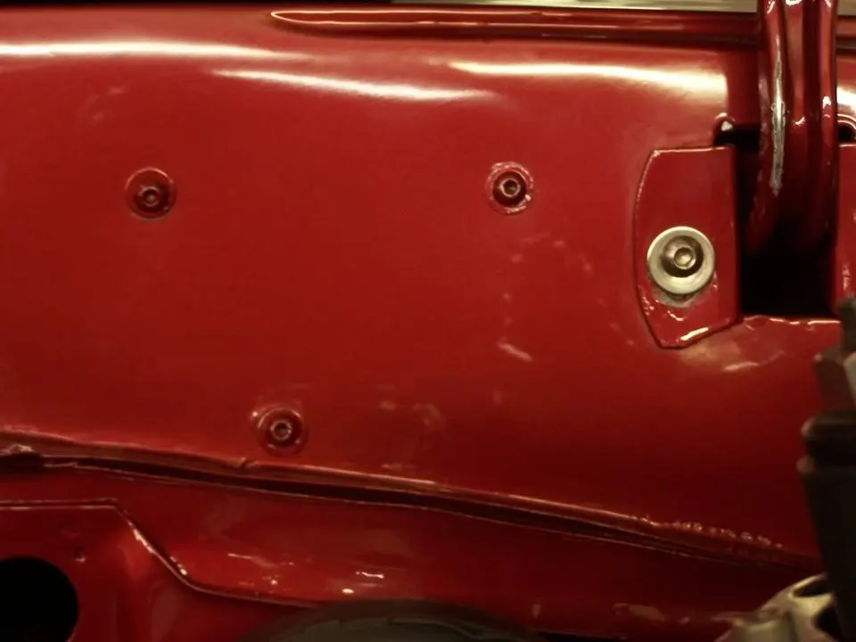

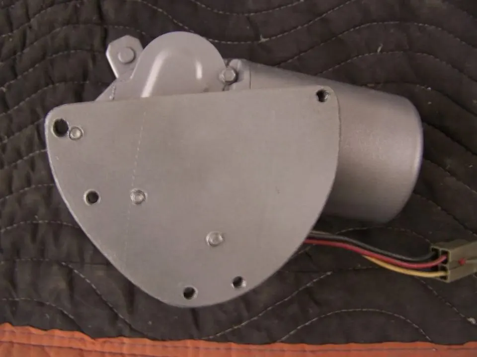

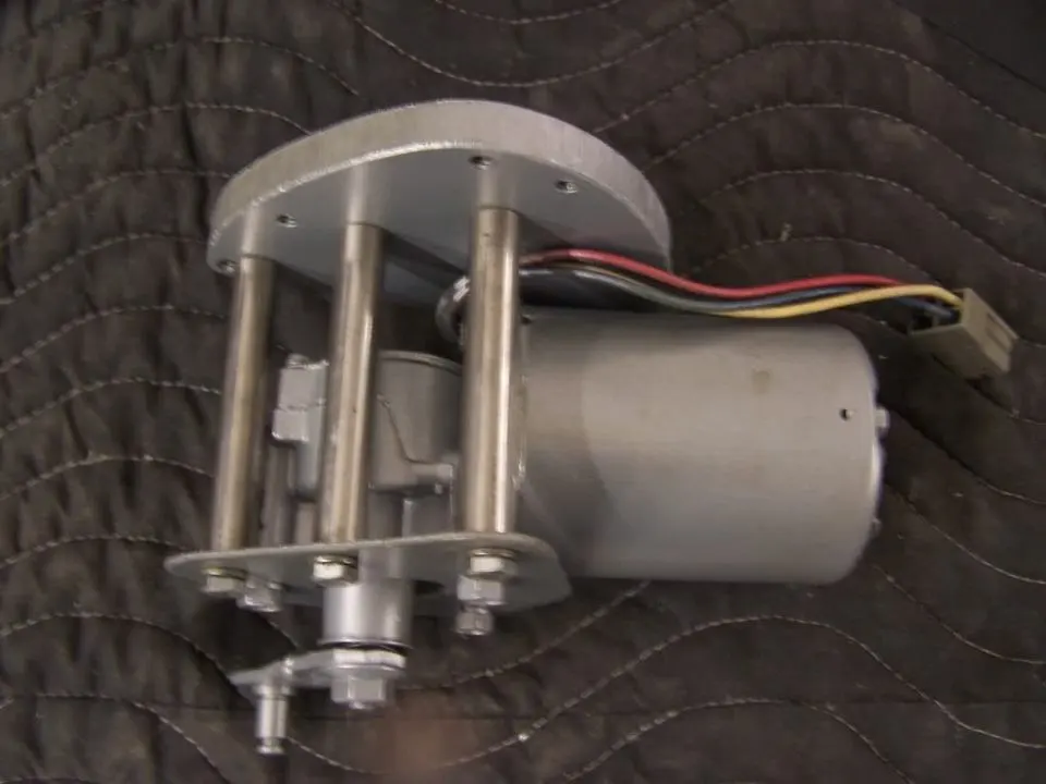

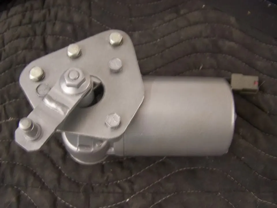

Got the wiper motor relocator done. It turns out that an 84 has a larger wiper motor than a 93, so I fabbed a new version, this mounts on the backside of the firewall and under the cowell with three bolts.

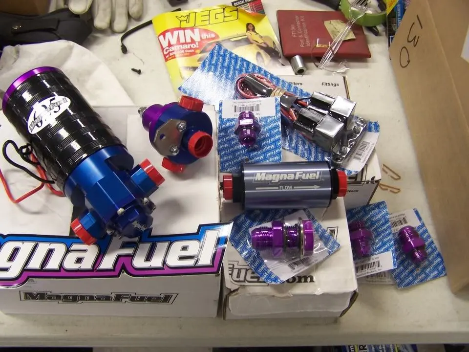

Fuel system arrived

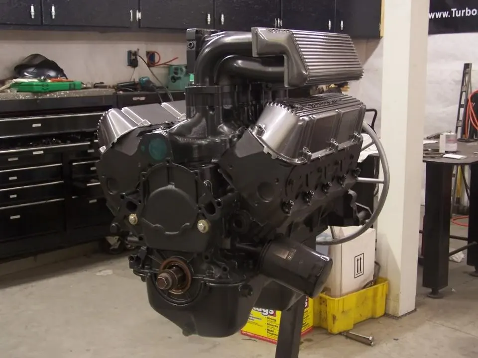

Have started assembling now, got a nice set of powdercoated valve covers that don't clear, any takers :lol:
