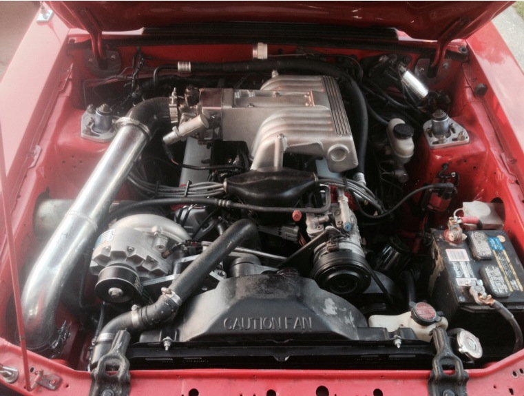

mikestang63 said:
Is that a rail mounted fp gauge I see next to the passenger side spark plug wires? If so, I would advise getting rid of it as they are known fire hazards. Especially with it so close to the wires like that.
I concur...

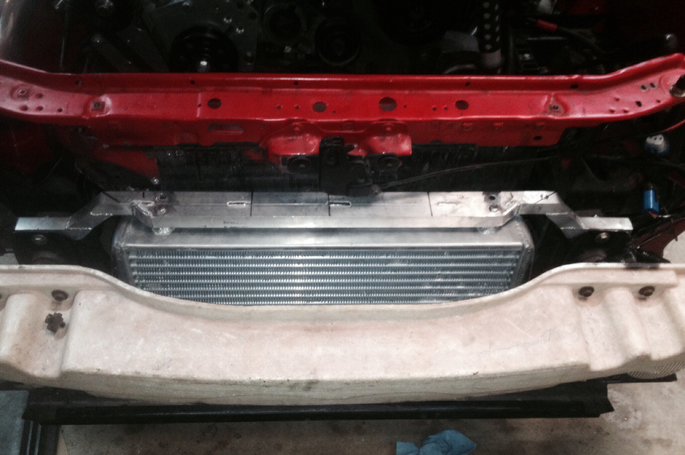

Not a kit.
V2 S-trim that I sent off and sent off and had upgraded to Si and swapped out to a straight discharge. Renegade dual brackets, ebay intercooler, custom made all the piping, Anderson power pipe.
