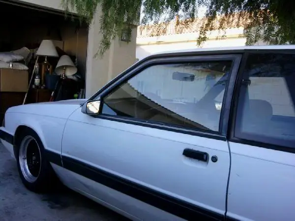

thought id try out photobucket and post piks of parts car and the notch there phone piks sorry there crapy View attachment 224515 parts car now my notch
my notch
ill tack more piks of both tomarrow and start my swap thread if anyone has any imput on the swap hit me up if anyone is in socal and wouldnt mind lending a hand hit me up also if anyone has any notch interior parts head liner the carpet piec that goes where the third brek lite is let me know and if you cant tell i dont know what its called loland i know im a ****ty typer
