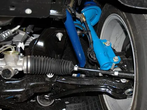

Obviously you have no clue as to what a bump steer kit is. click on this link to see what I am talking about. http://images.google.com/imgres?imgurl=http://www.crazymustang.com/images/bump-steer/P3170020.jpg&imgrefurl=http://www.crazymustang.com/bump-steer-kit-install.php&h=480&w=640&sz=39&hl=en&start=9&um=1&tbnid=RBCc4yJsUFGpzM:&tbnh=103&tbnw=137&prev=/images%3Fq%3Dsteeda%2Bbump%2Bsteer%26svnum%3D10%26um%3D1%26hl%3Den%26rls%3DSUNA,SUNA:2006-08,SUNA:en
Look at the pics of the ball joint and the bumpsteer kit. The solid rod on the bump steer kit replaces the ball joint and the spherical bearing on the bottom it what you get. If you can show pics of both ball joints and bump steer installed I will show you an anomily.Also you should never install offset rack bushings with a bumpsteer kit. They are both intended for the same purpose and it will cause major problems with your alignment.
In the pictures below you can see the ball-joint (pressed into the end of the A-arm) onto which the spindle will bolt to. the tie-rod can be seen also, and is not connected to the ball joint. Perhaps you are thinking of the ball-joint being in the end of the stock tie-rod -> and there is one. But what is commonly referred to as the "ball-joint" is the large one that connects the A-arm to the spindle. :nice:
