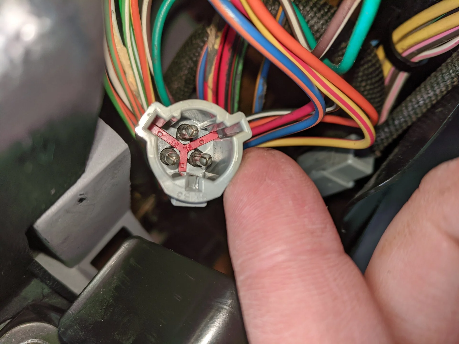

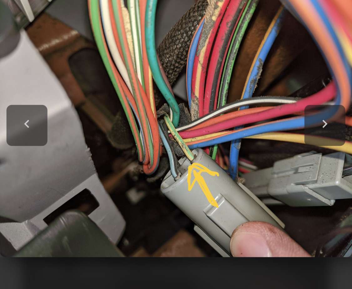

So finally getting around to installing my Momo wheel in my 93 and want a functioning horn. The Yellow/Light Green wire is the only one I need for the horn but I don't want to cut and splice like a fool. So does anyone have an idea on what type or name of connection that is? It runs to the clockspring if that helps. Just want to buy the female side of it run my wire and connect it up

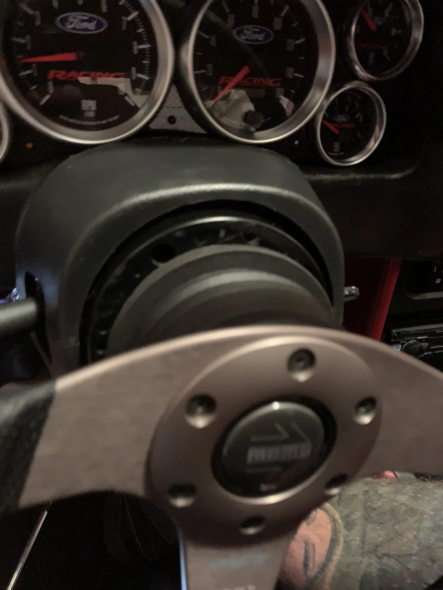

What hub are you using? I believe the Momo hub uses a contact ring that exists up to 1992 and doesn’t exist in 1993.
you might need to “convert” your contact plate to a 90-92 style. Can you provide pics? I’ve done this on my car with my Momo wheel abs kept cruise/horn functional

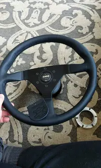

The Momo steering wheel will come with a horn button. I sodered my two wires. Easy process.

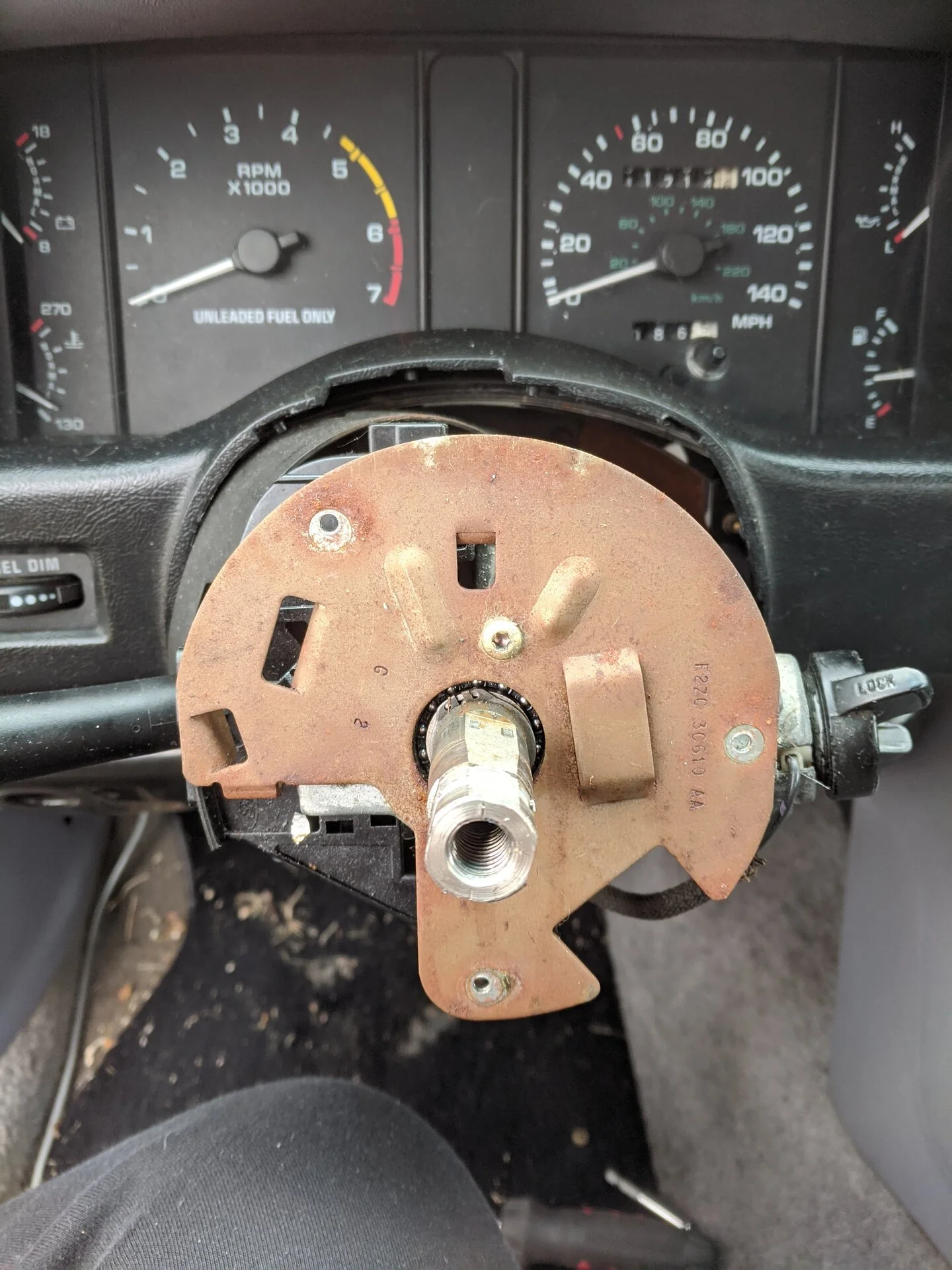

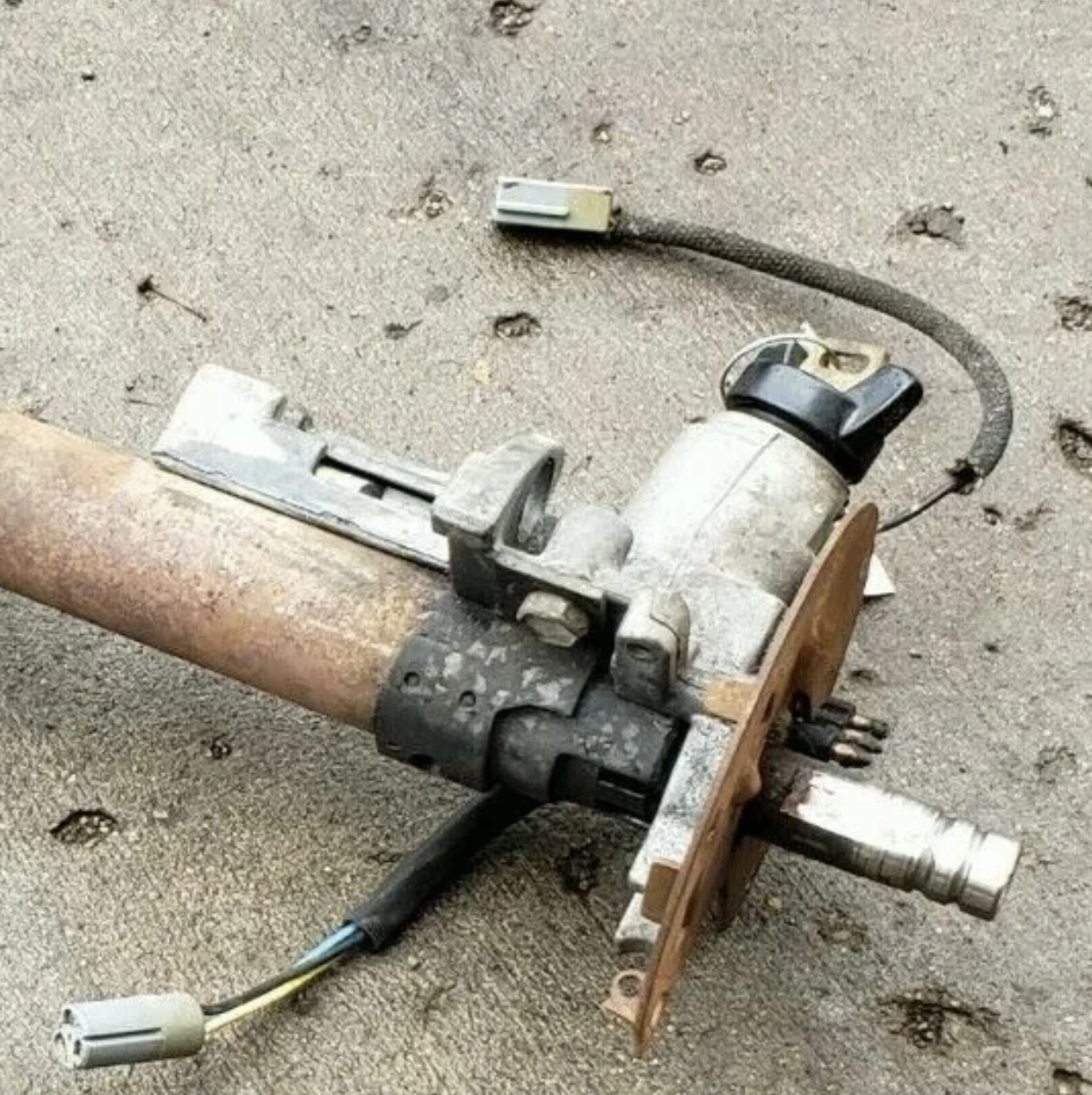

The connection goes to something called a brush. This is what it looks like on the 90-92 cars. It contacts the bottom of the hub. This would plug into the connection you are holding.
Problem is mounting it. Not sure if the 1993 has the proper mounting plate. Here’s how ot mounts on the earlier column. The Momo hub rides on those three fingers.

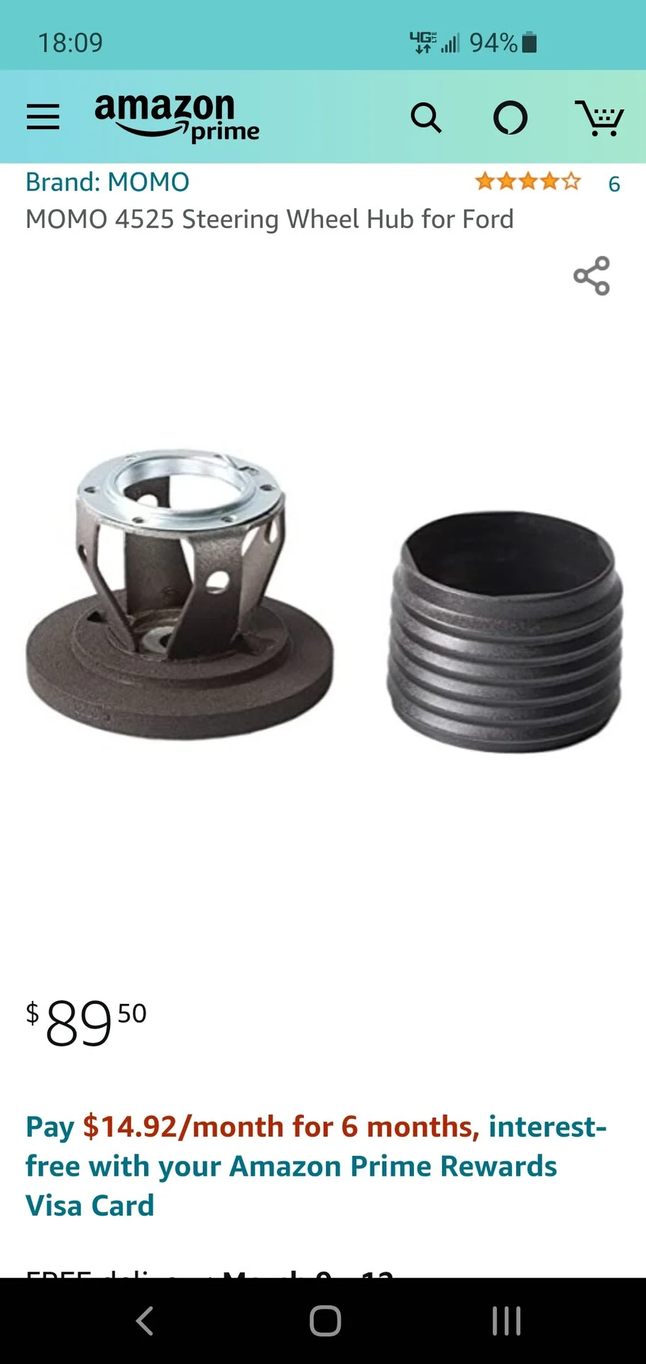

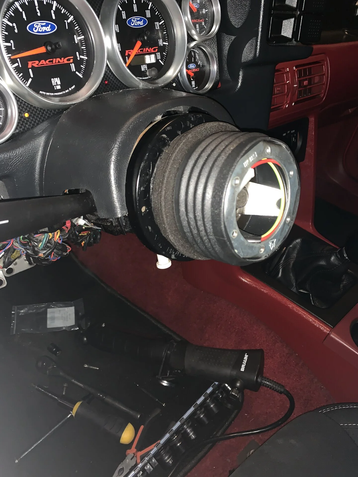

Sorry for the confusion. Basically have a 93 car with a 93 column that I want to mount my Momo wheel to with a momo 4525 hub. Looking at the wiring diagram it looked like I could just run the y/lg wire up to the horn button to have it activate the horn relay signaling the horns. I'm not worried about cruise control it was deleted along time ago from the car.
Here is a picture of how the plate looks with the clockspring removed on my 93 steering column.

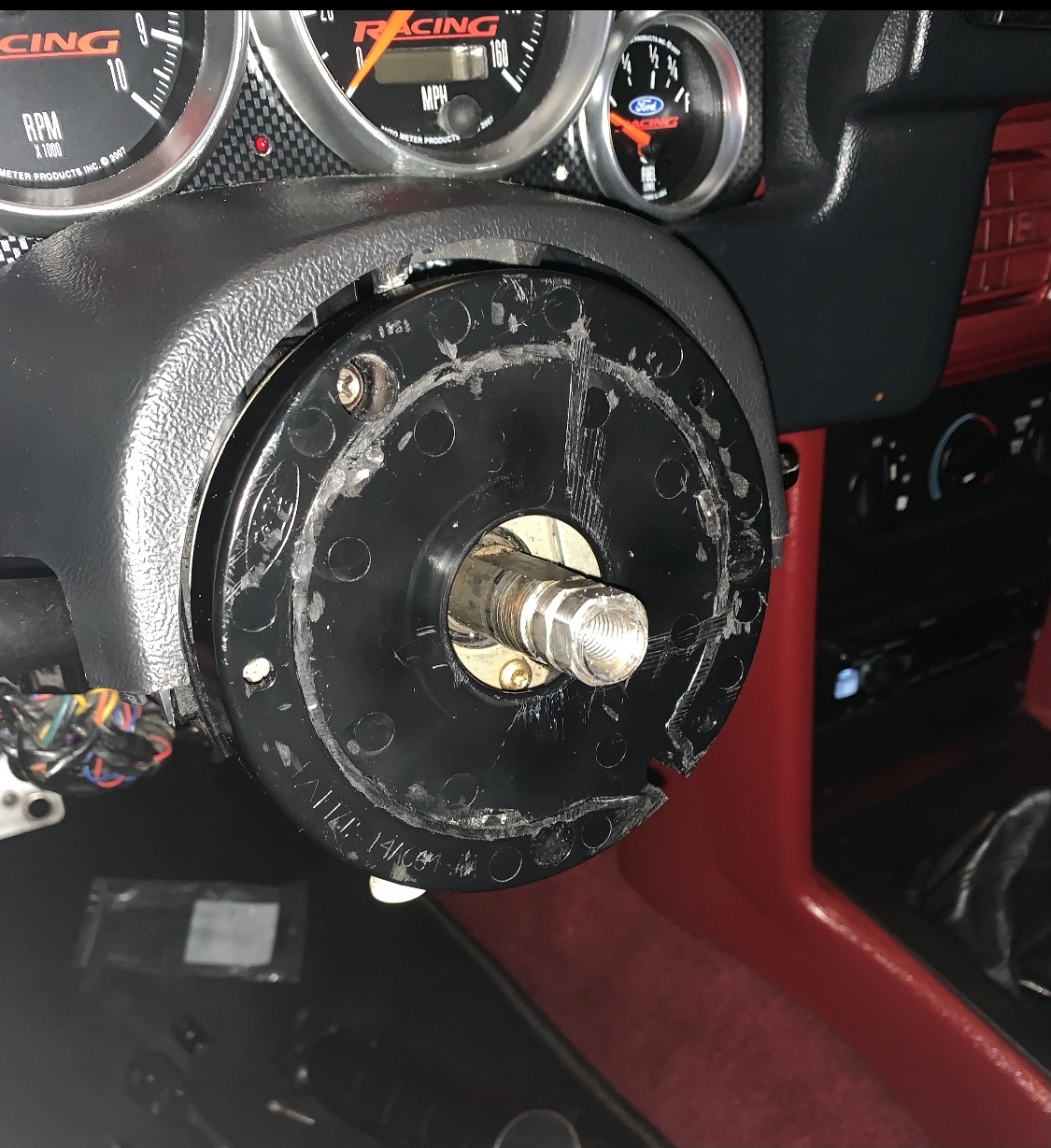

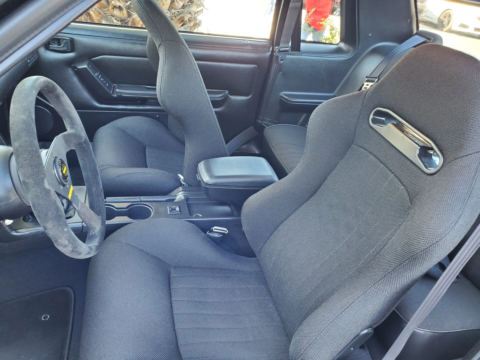

You can mount them to an airbag car fine. I've had one in the past you just need to make up a plate to cover up the ugliness like this one

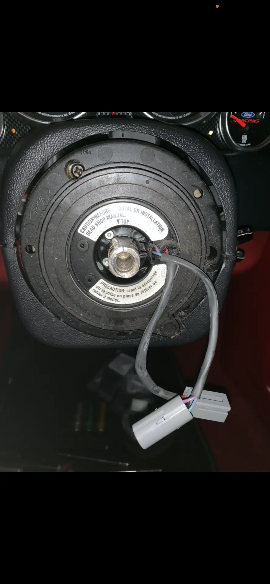

Yeah you still have the clock spring installed. That is the round thing you cut up. I found that if you ground the purple wire from the clock spring the horn works. So in my case I removed the clock spring and harness. The y/lg wire is what runs up to the purple wire of the clock spring so I know if I ground the y/lg wire i'll have horn action. I just don't want to snip or splice :poo: I was looking for a legit connector to interface with the factory one.
You may want to do what I did and pop that wheel off again and make a template out of cardboard. Hit up Lowes for a sheet of abs and cut it out like the picture I posted above to cover up that gap.

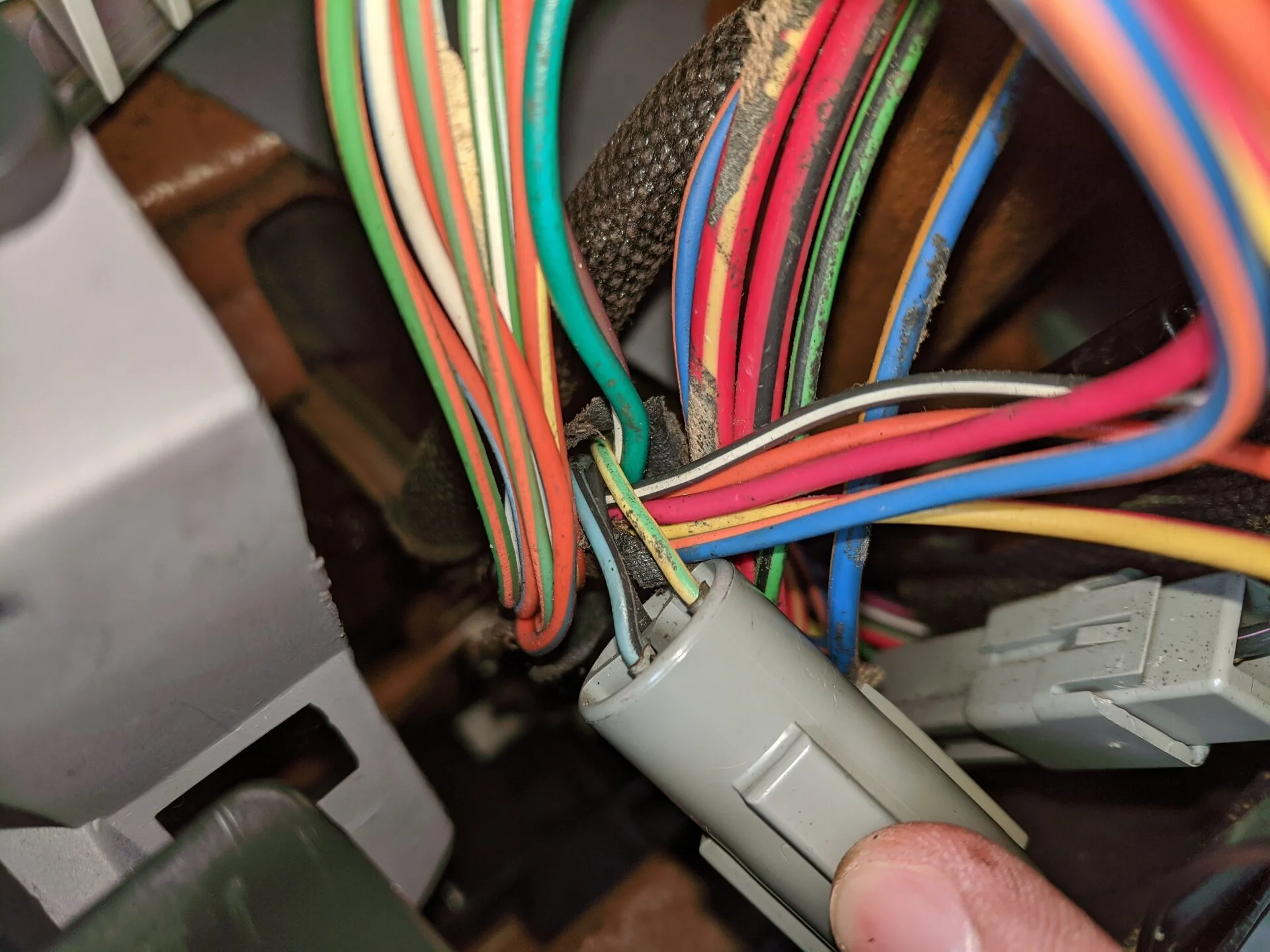

Really doesn’t bother me, but that’s a good idea next time I’m there I might look for that. So the wire you are talking about is this one?

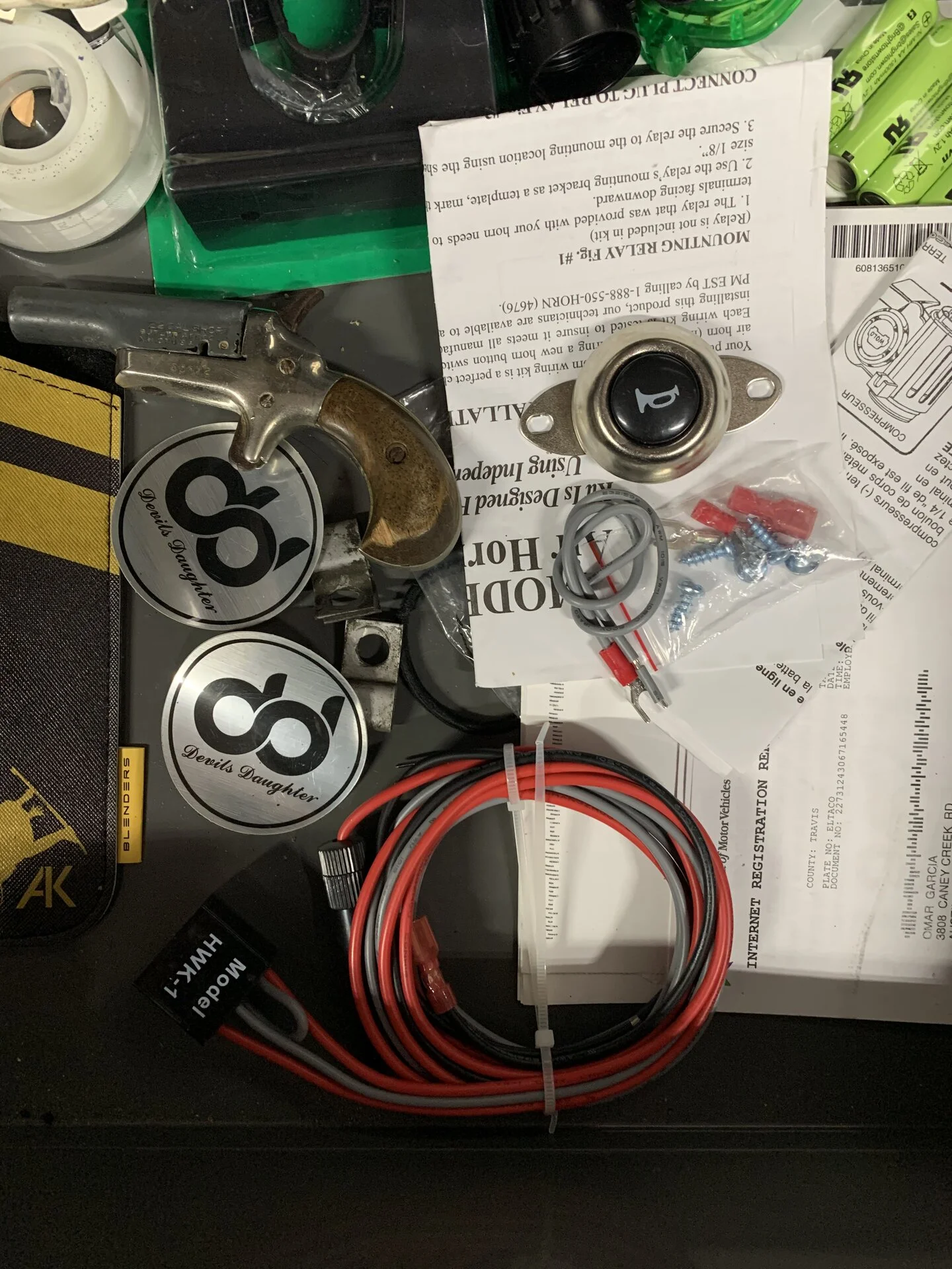

I bought this thing over a year ago, but not what I really wanted, plus bought the deluxe version of it with this relay which I don’t think I even need. Thought maybe I could mount inside the horn button area and hide it and still be able to push the horn button which would push this ugly little button! I just don’t know what I could tap into wire wise.

I assume you are trying to wire the clockspring connector that normally connects to the steering wheel plug? In that case, you might be able to match the plug up here and buy one
Yeah i'm doing it with the clockspring removed. If you want to do it with the clockspring still installed you can't unless your ready to cut the clockspring wiring and face a little like Reddevil has pictured above.
Yup I'm trying to tap into the horn ground wire without messing up the wire. So in the future if I want to move the wheel to one of my other cars or throw the factory clockspring and abs wheel back in I can.
That URL looks like what I needed thanks I'm thumbing through it now

Boostedpimp, you probably could use a suitcase type of connector, i don't love them, but it's only the horn.
Or just goto a junkyard and get a pigtail for the top half.
