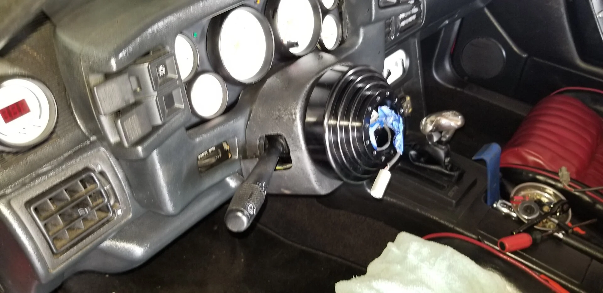

Steering wheel install

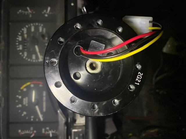

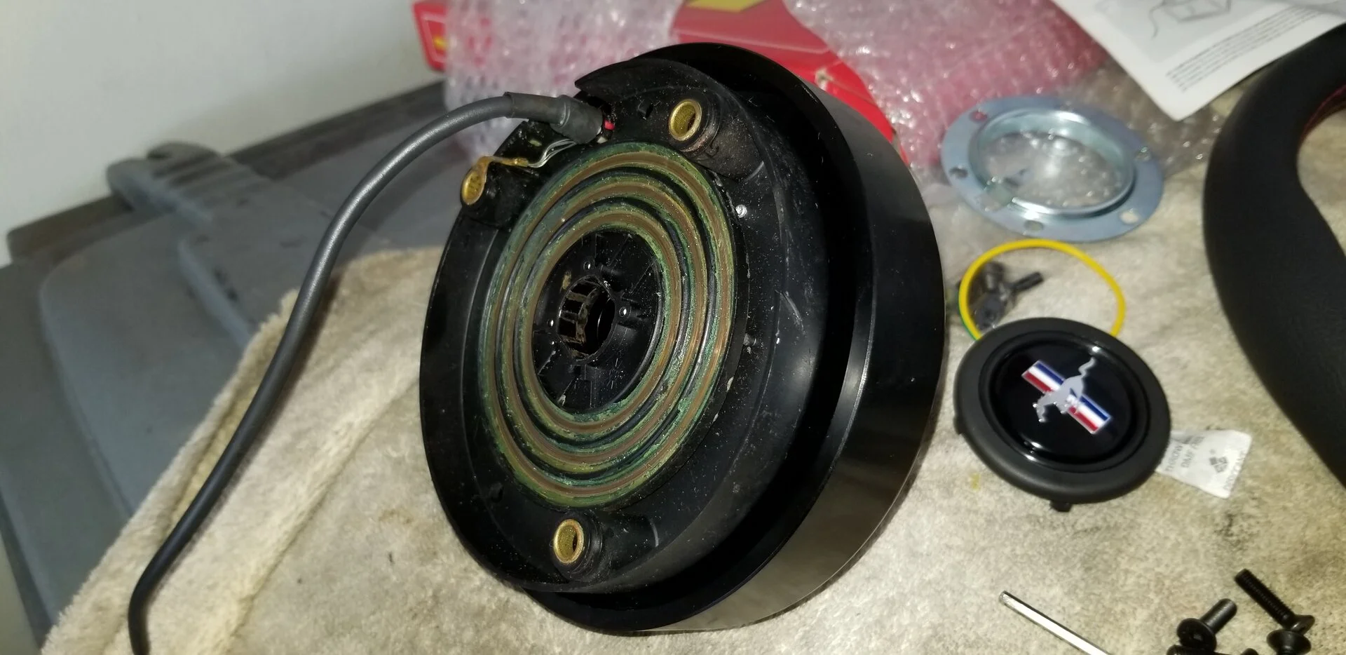

Yeah looks like your car isn't a 93 like mine. 93's don't come with that brush you have there that touches the back of the hub which is why I had to connect to the clockspring connector. The way you have it should work for you if it doesn't I would check the light blue/white wire for 12v if you don't then you have a problem in your wiring or fuse.
Ooops so how are you running the connection between the two? I got so excited and then had that oh wait moment when I started to turn the steering wheel.
a single wire from that yellow/light green wire ran up thru the hub adaptor to the horn button. I left plenty of enough wire coiled up behind the momo horn button to allow for full lock of the steering in both directions.

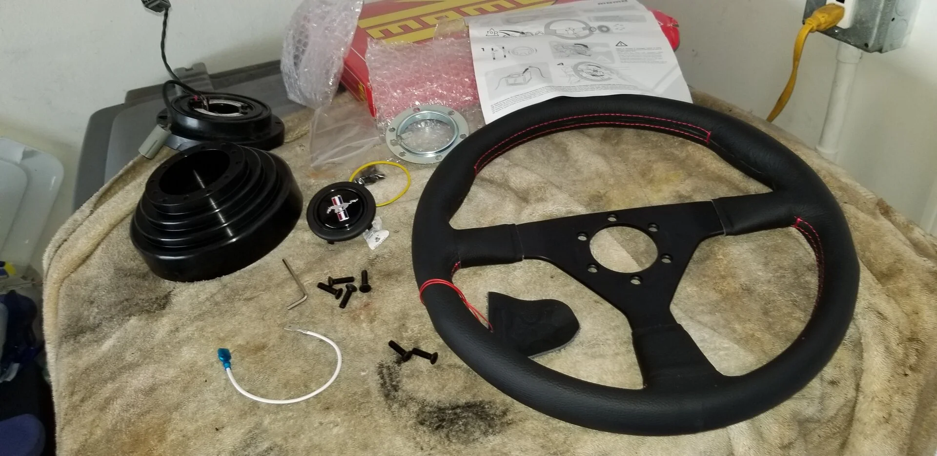

question for those of you that have done this.

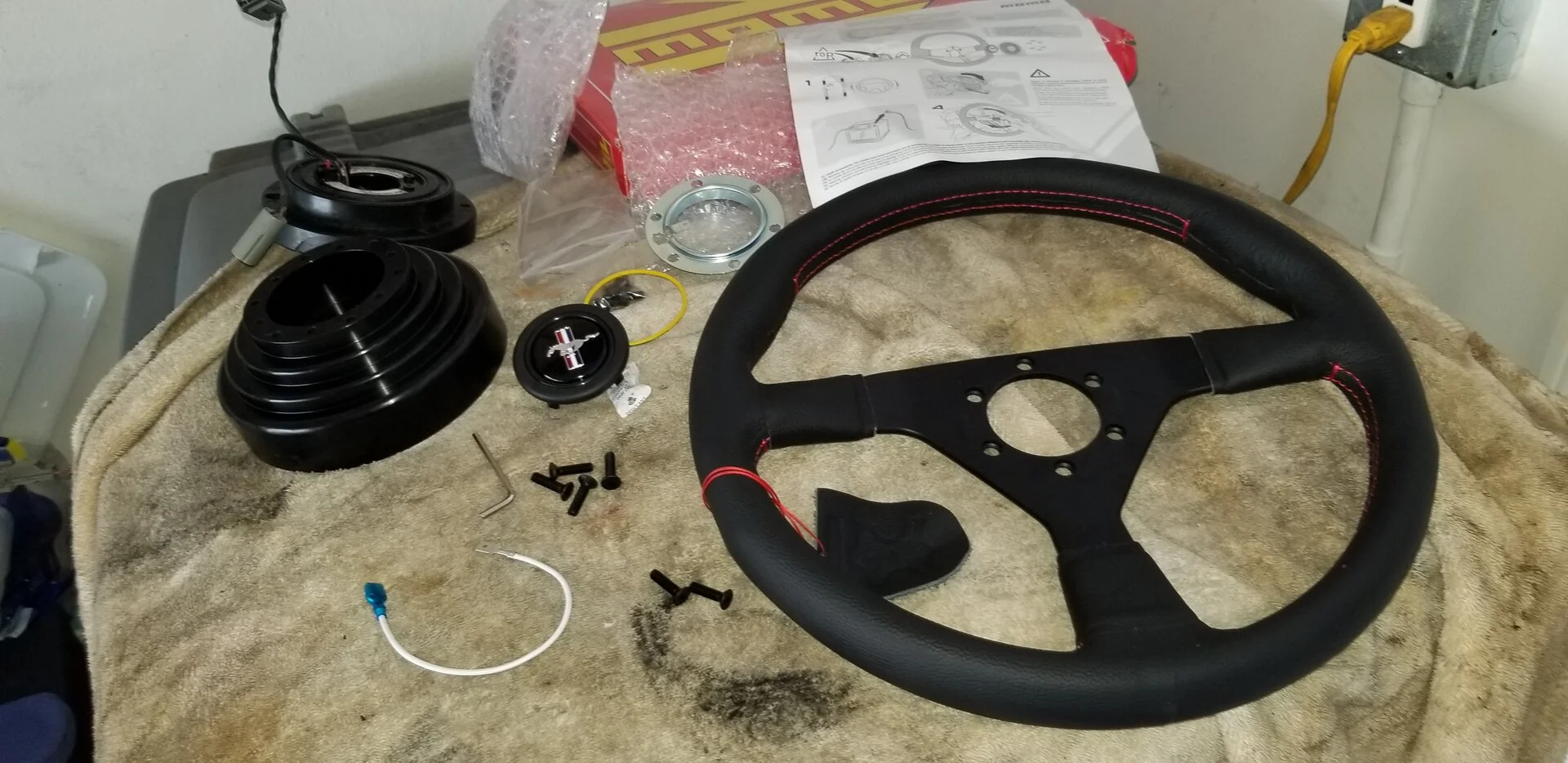

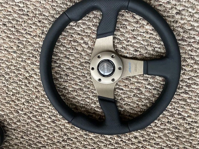

Scored a MOMO 350MM Monte CArlo wheel for $95 and looking to installl on my 90 vert... I came across this hub which appears to allow you to bolt the steering wheel right on it without the need for the $90 MOMO hub, and it also fills the gap left when you remove the stock wheel. It also seems to allow you to keep the clockspring in place? Let me know your thoughts
Looks like I just run a wire from the yellow/green wire up through the steering wheel to the horn button , put this hub on and attach the wheel the to the hub?

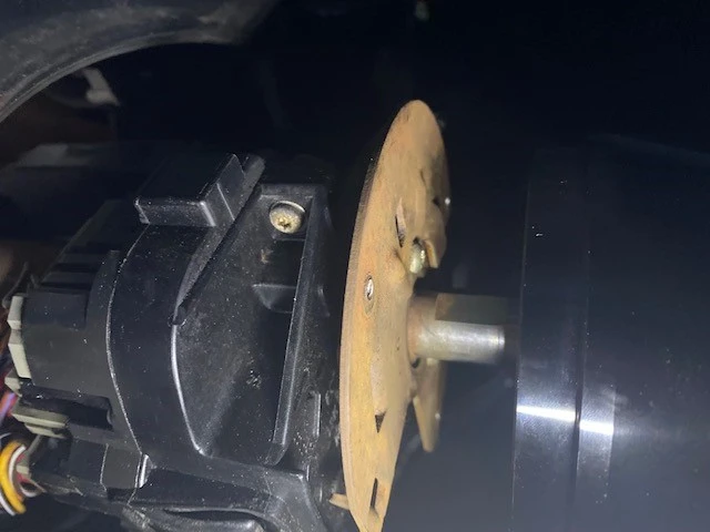

I doubt that has the required space to retain the clock spring. Haven't seen one made yet that does. You'll have to run without one and deal with the ugly space/gap or fab up a cover. Others have cut up there clockspring and bolted it back in to take up the gap but I would advise against that being they are a non replaceable part.

I've yet to see it either. Before i did my tilt swap, i ran through what i thought was every solution.
Only to find none and realize that A. A tilt column swap is pretty easy and B. I like a tilt wheel better anyway.
It's a non invasive mod. Not hard to undo if you keep the old wheel.

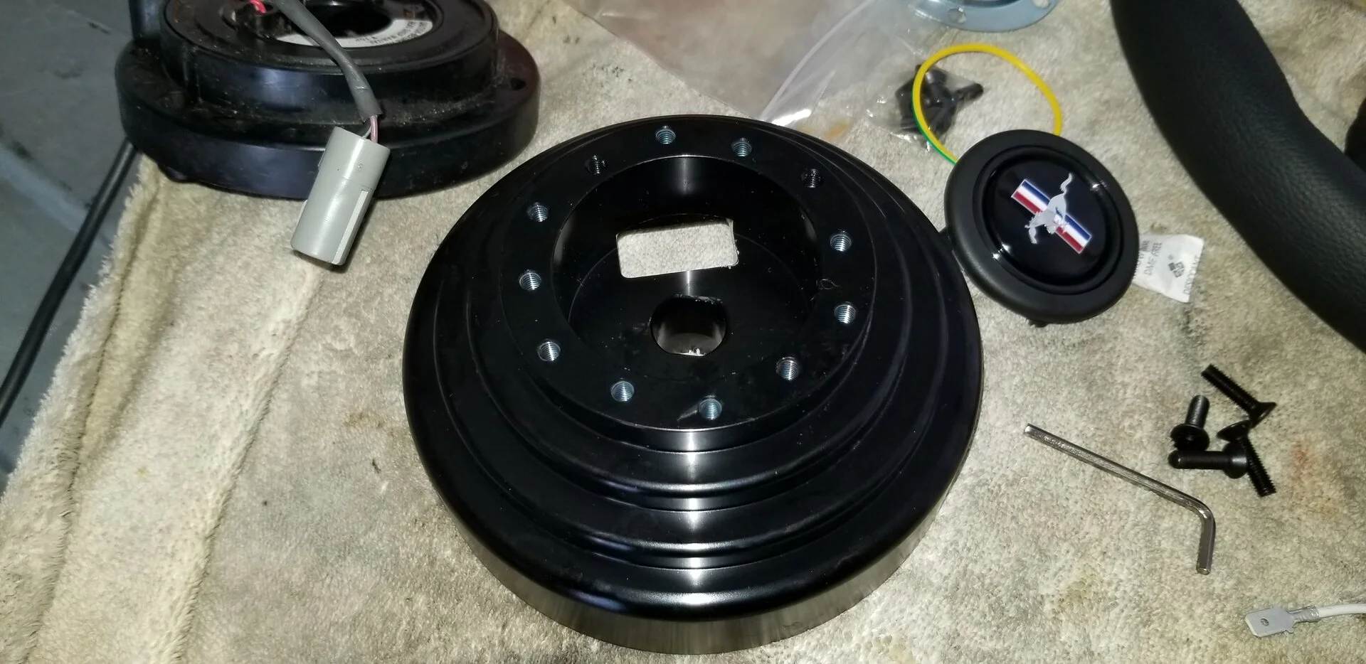

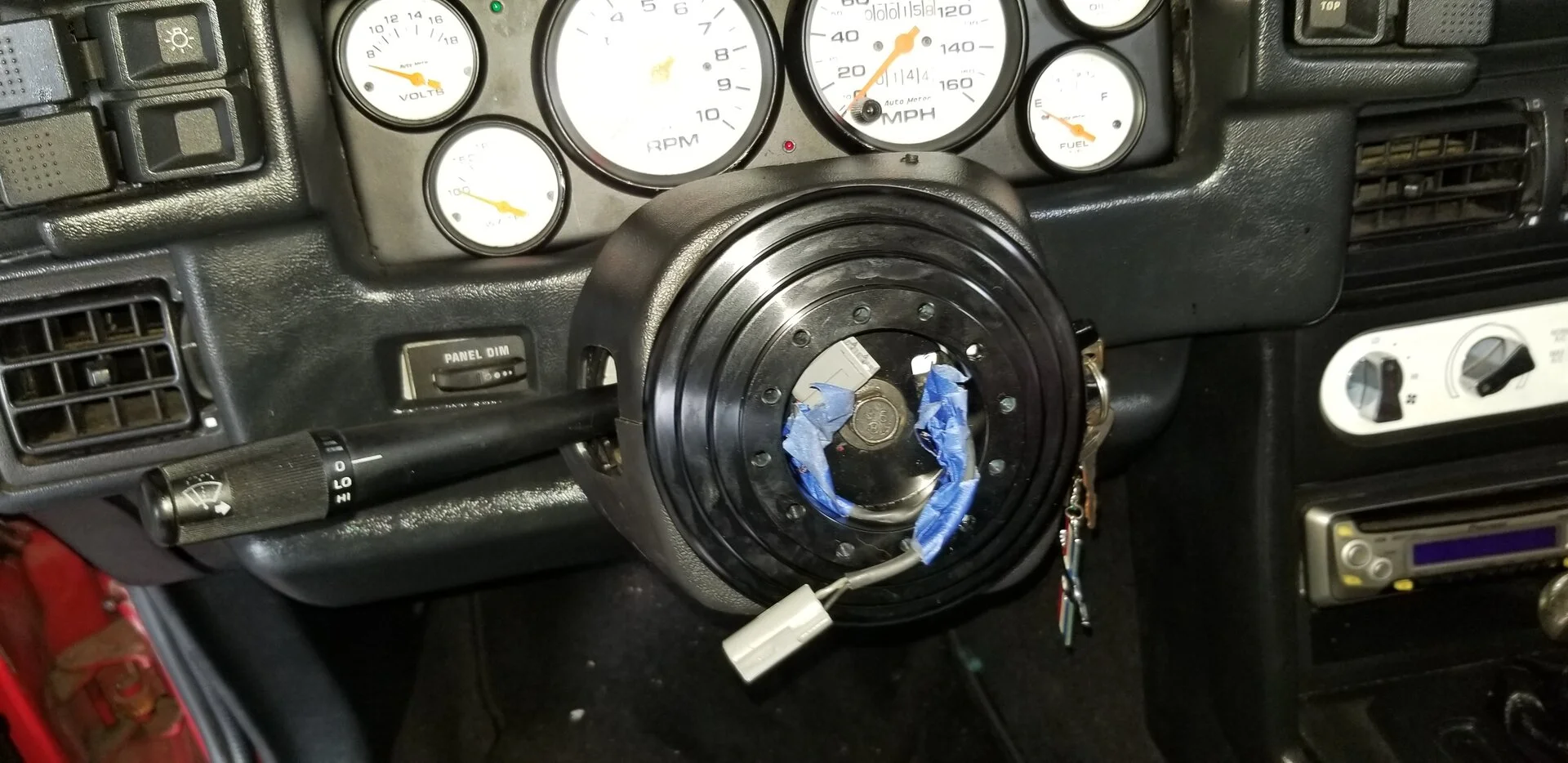

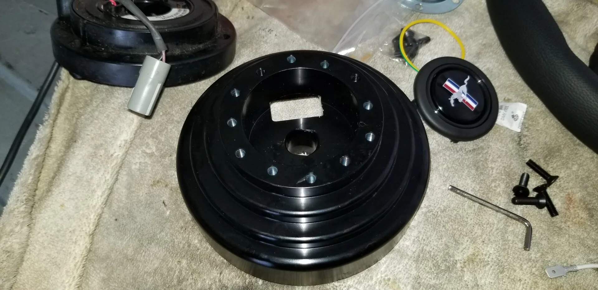

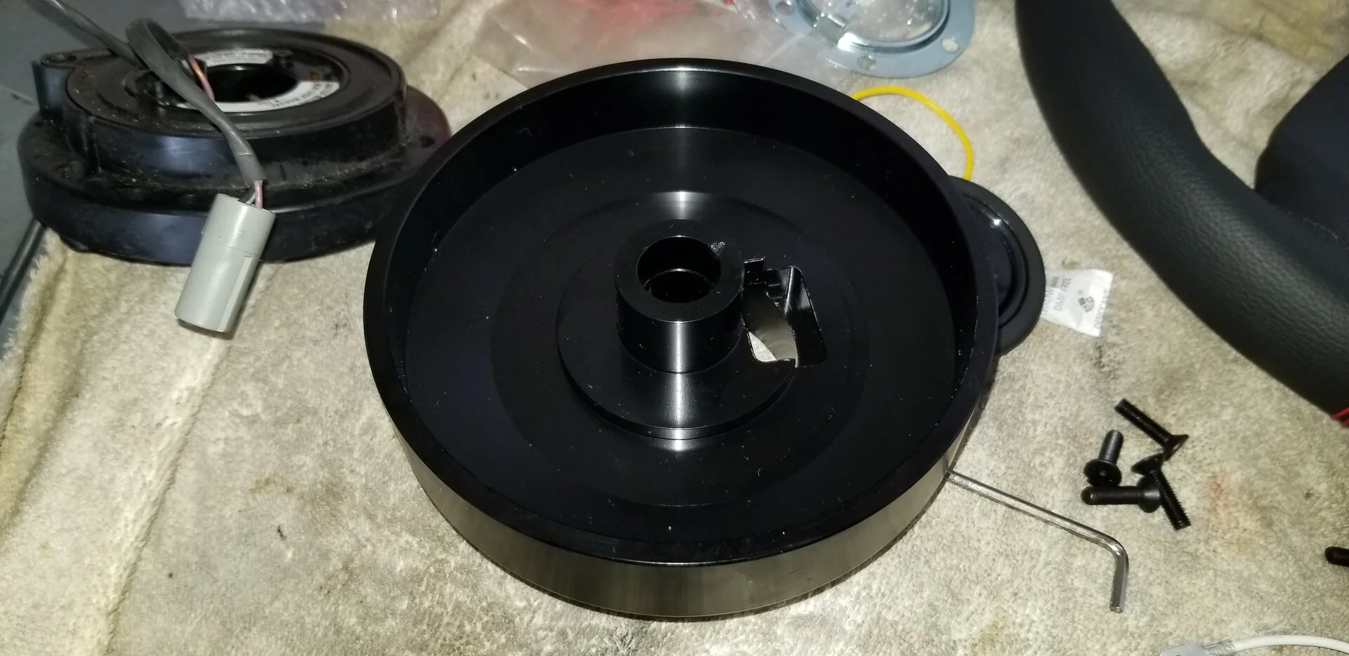

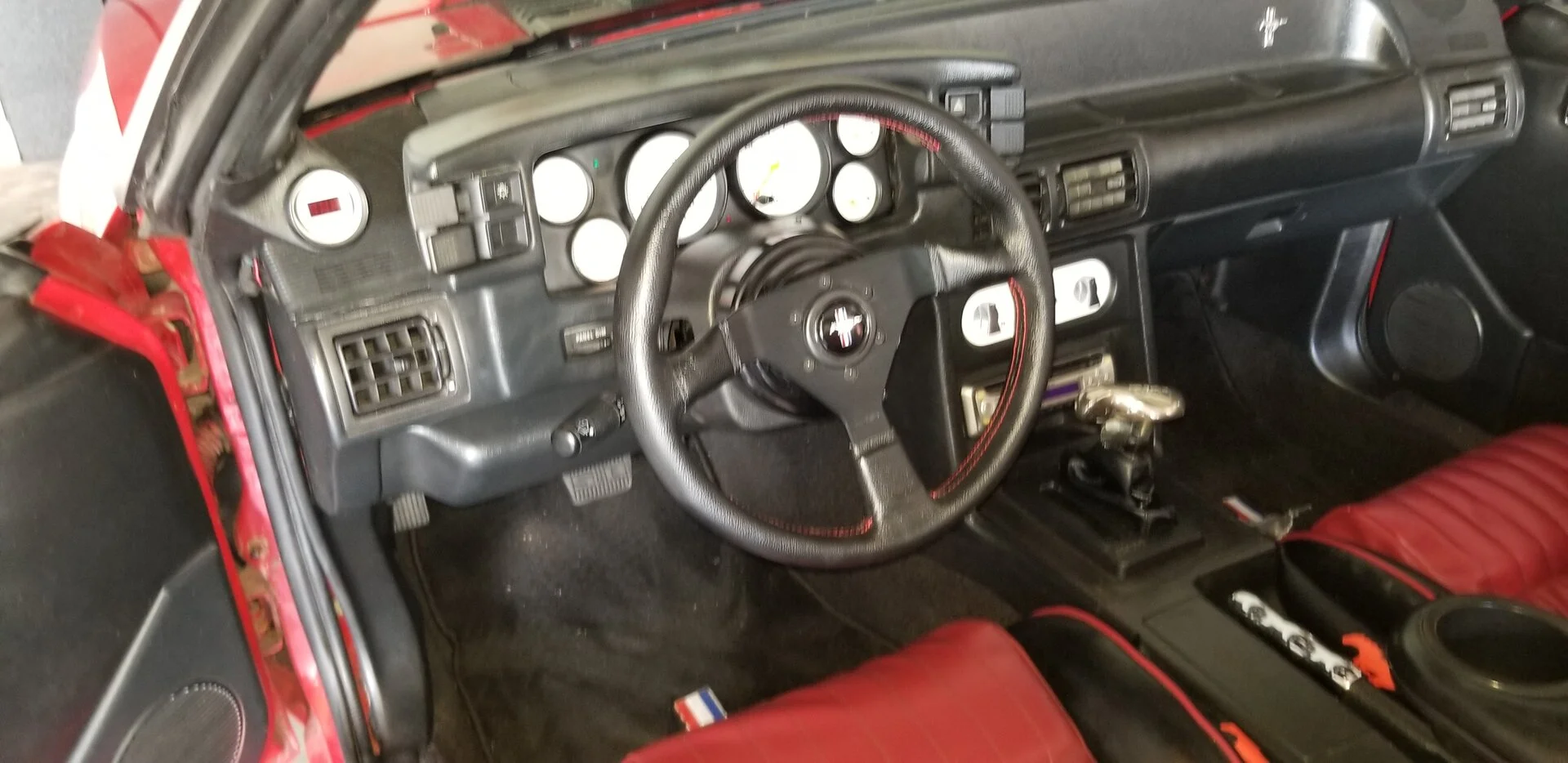

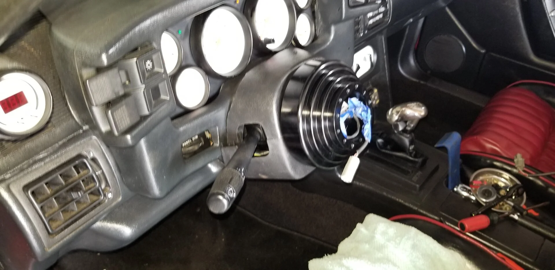

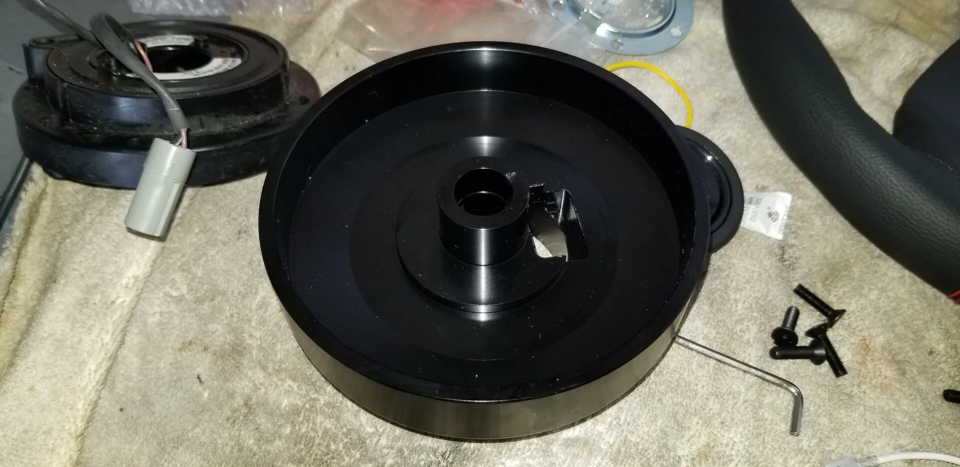

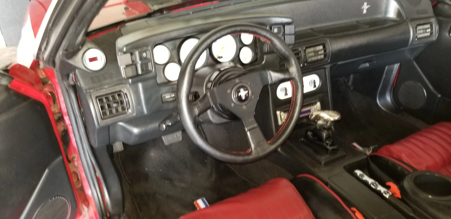

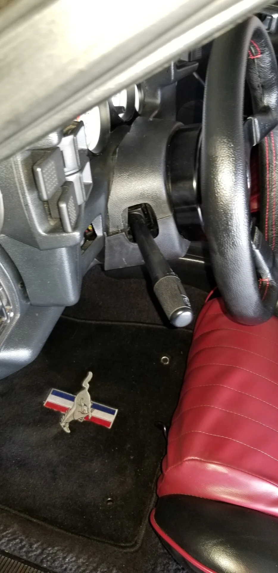

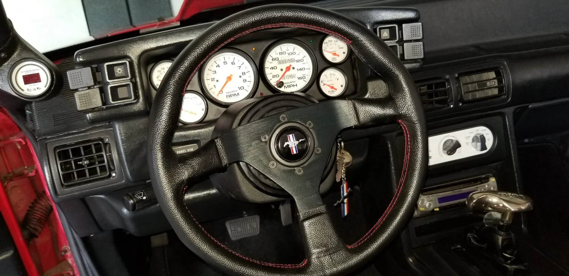

did the install today it looks 100X better without the airbag wheel. The Momo wheel feels so much better and the adapter allowed me to keep the clockspring in place and covers the gap nicely

nice,

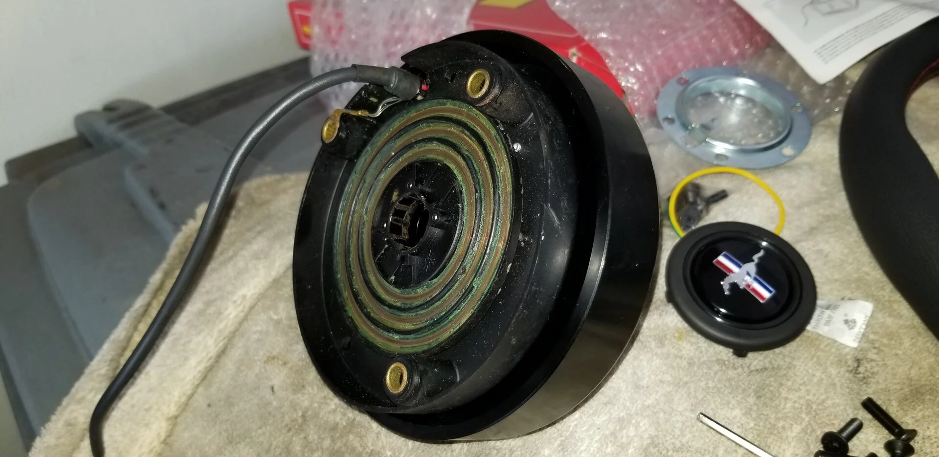

Nice!!! Question, how did you connect the horn? Which wires did you connect? I've purchased the hub and steering wheel from American Muscle. The picture with the hub, is that as far as it goes without the CS? I see the hub you purchased fills that space nicely.
Thank you for your time.
