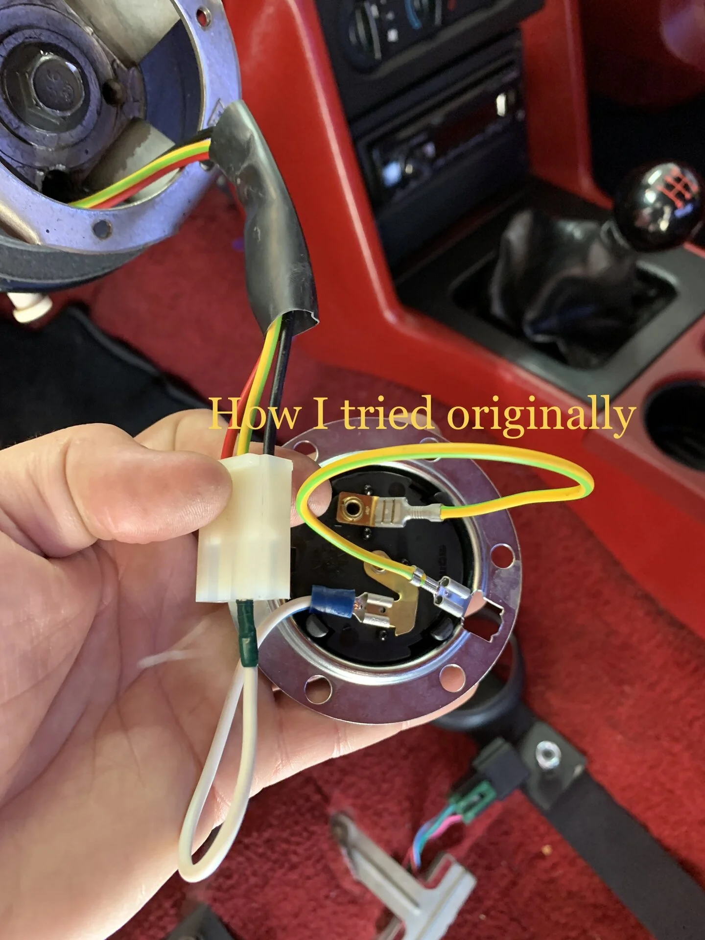

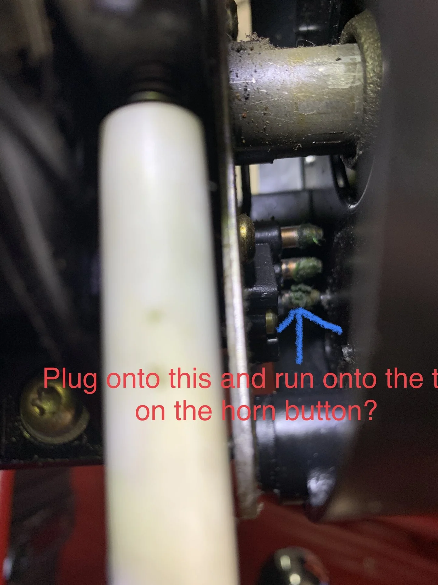

Yeah I may end up going that suitcase type route as it isn't going to hurt anything. I just wanted a setup that would allow me to toss the factory clockspring and airbag wheel back in with ease when I want to. Didn't want to hack anything up this car is clean.Boostedpimp, you probably could use a suitcase type of connector, i don't love them, but it's only the horn.
Or just goto a junkyard and get a pigtail for the top half.

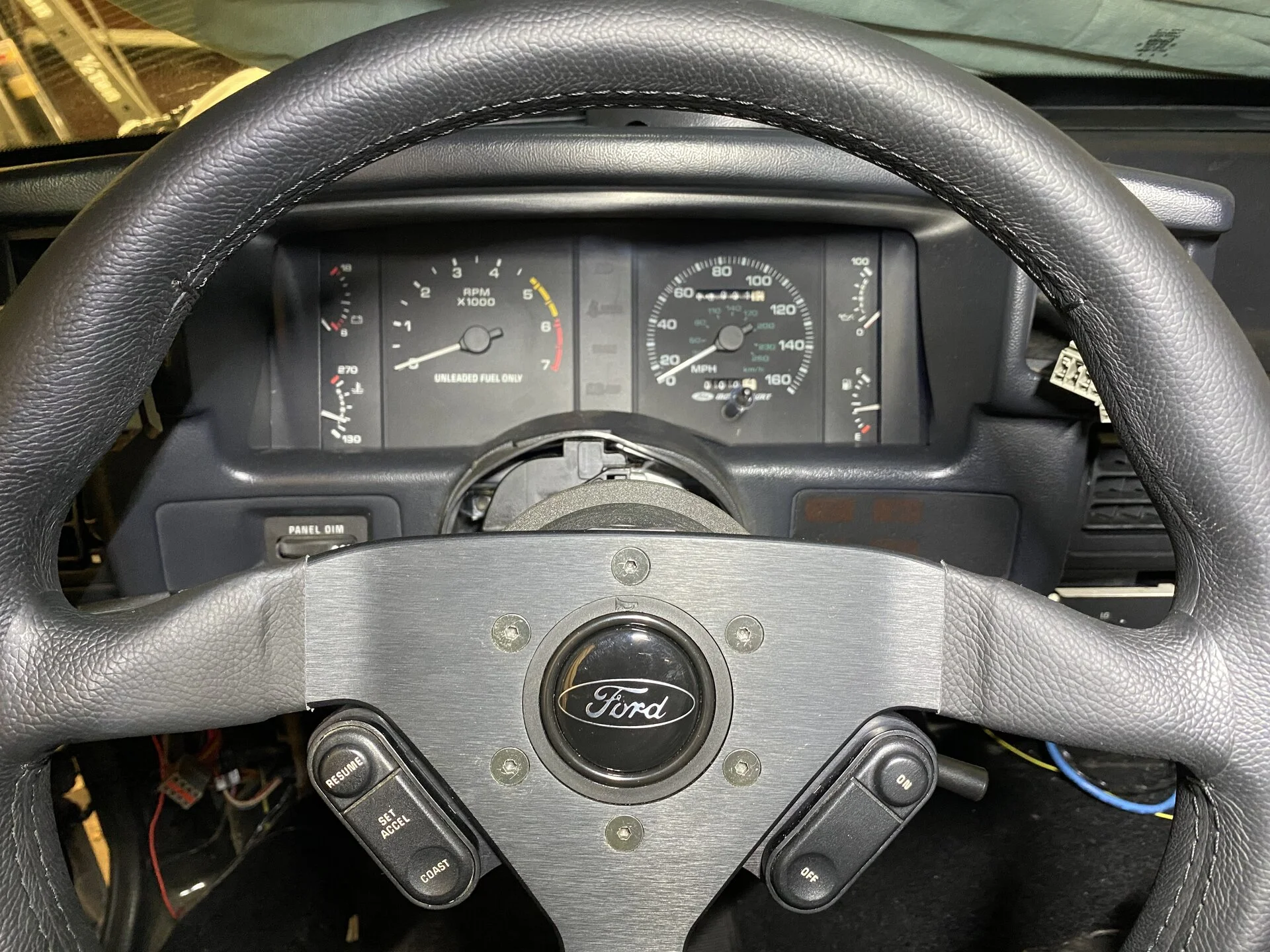

Not really loving the plate to block off the view of the column, just doesn't seem like it was born there and for sure i wouldn't be just mounting my horn button in some random place.
I did the tilt swap so the wheel fit and looked right, the nice surprise was how functional and useful the tilt column turned out to be.
The plate in black abs looks a ton better than that carbon fiber one I posted but I get it. I have a 89 and the tilt is nice but I don't need it in the 93 and there are zero foxes in any salvage yards around here anymore so I'd be dropping a few hundred on a tilt column I'd rather spend else where
The horn wouldn't be an extra button it is going to be hooked up to the momo horn button. I'm not a fan of add on buttons at all
