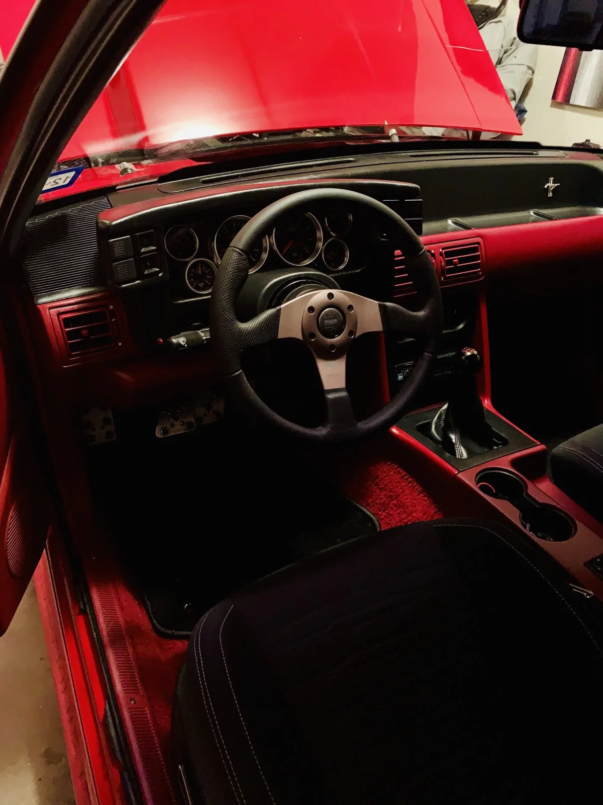

I have an air bag wheel sitting in the garage and i do agree between 87-89 or 90-93 I’m all about the 90-93 air bag wheel it’s a much better looking wheel, yet I just swapped in a momo on mine and no plans on going back. I still need to figure out the horn thing though at some point !!

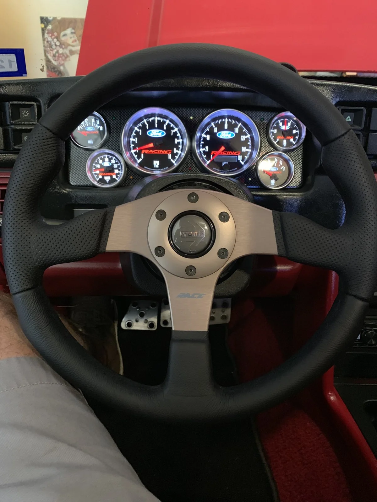

Reddevil91 I am thinking of installing a MOMO wheel and wondering if you can share photos here of it installed? Thanks.
Im quiet indecisive on if I like the non airbag vs the airbag. I do like some of the aftermarket wheels I've been seeing but I'm really wanting cruise control. And now considering finding a way to hook that up that would be a button off of the steering wheel somehow and still making the inside of the car nice and not butched

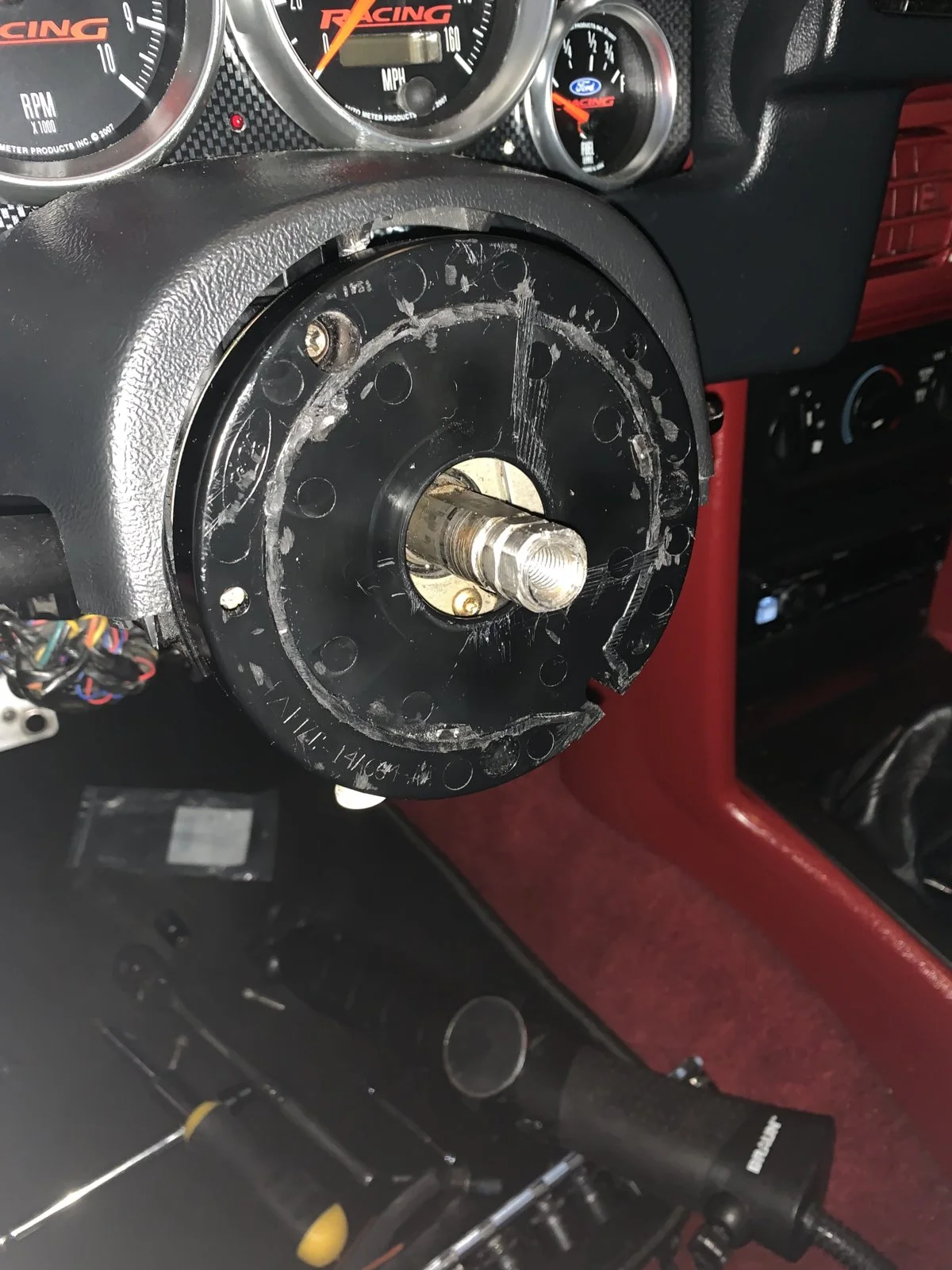

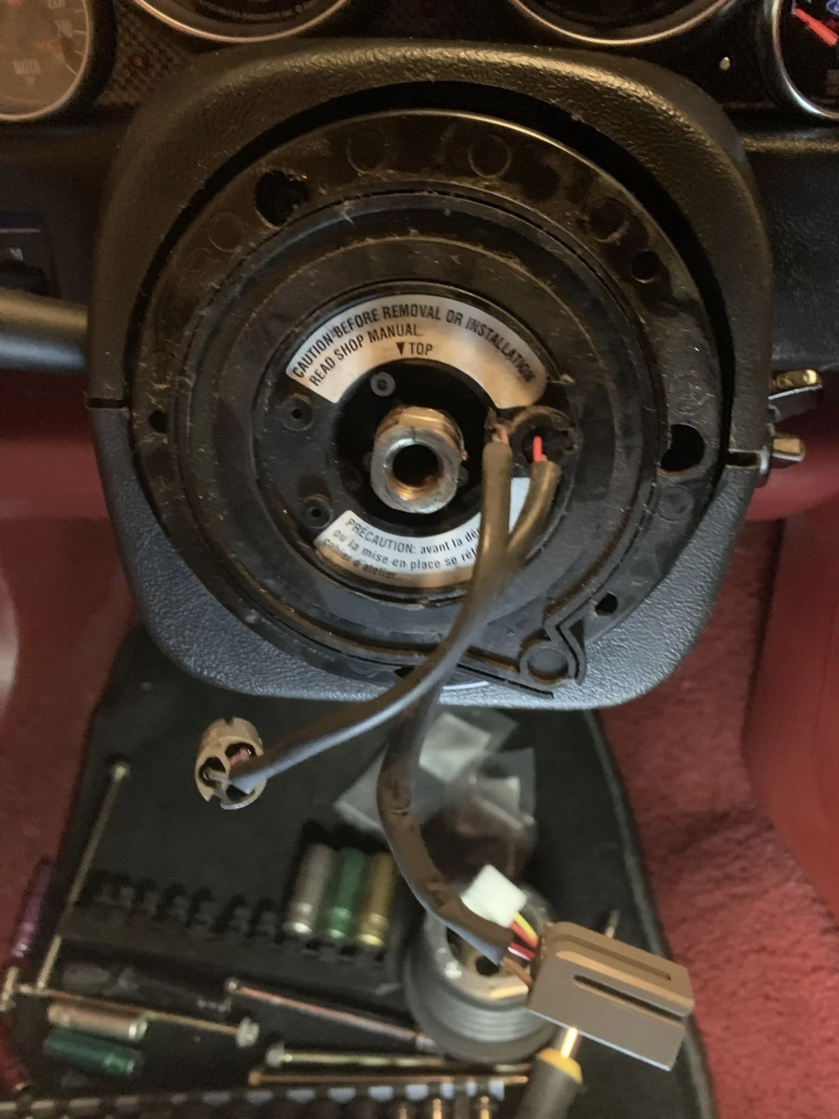

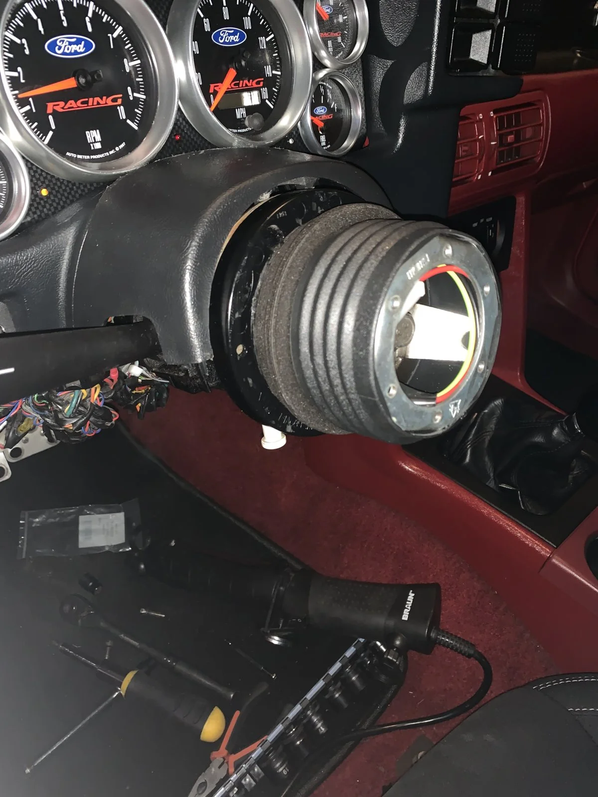

So I did my swap with momo wheel and hub. I installed it and as mentioned in here with the air bag wheel column there is a pretty decent gap that imo doesn’t look good. So what I did is there is a small round piece behind the original wheel, I’m guessing it’s the clock spring thingamajig not sure but a large unraveling occurred. When I finally opened it up. I cut the ridges off and smoothed it down with the dremel. Out it back on, screwed it back in place and it was perfect clearance now for the new hub, filled the gap and all worked out well. I did kinda scratch it up a little being in a hurry, but it’s really not that noticeable anymore since everything is mounted.
