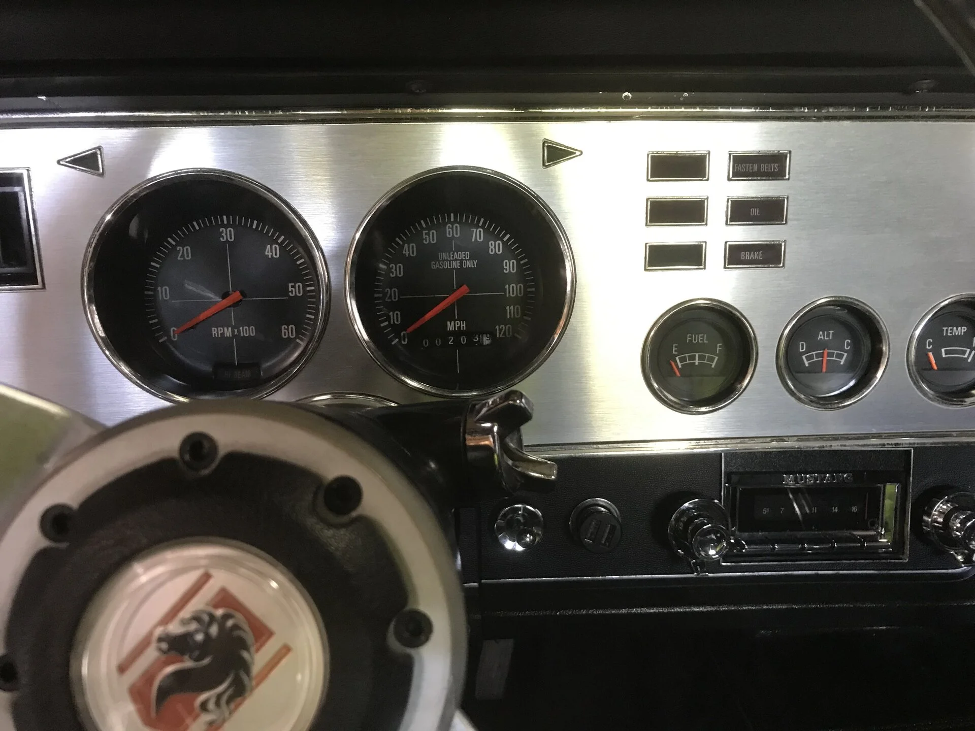

I ran into the same issue. I ended up with this one. No cutting. You will need the amp. And a sub is great. I'll go and find the info in a moment. Waiting for the snow to let up.

Just received the radio. Still sitting on the kitchen table. My first impression unboxing it is the pictures online do not do it justice.
The images I have seen show the gap at the top as well as the static digits being very prominent. The radio I received has a built in filler piece that hides the gap and the numerals are obviously there but they are much less prominent than what the images show.
Enzio, It's a good thing I haven't bolted the dash pad down. I have been waiting on a dash cap and since I received one with the radio it's on the to do list as well.
I have installed 3 or 4 stereos in different II's over the years. Never did it from the top until now. It is sooooo much easier. An ac car may be harder from the top but non ac cars its very roomy up there.
Stereo sounds good. It's hooked up to an 80's Jensen amp and cheap speakers. It gives plenty or noise for now. Bluetooth works fine. Numerals on display are visually invisible once on. I ordered from CAR and the one I received is set up out of the box for II's. They have the spacer built in and the odd mounting stands have spacers included. Have not driven around in it yet but I installed the carpet jamming to 80's metal!
