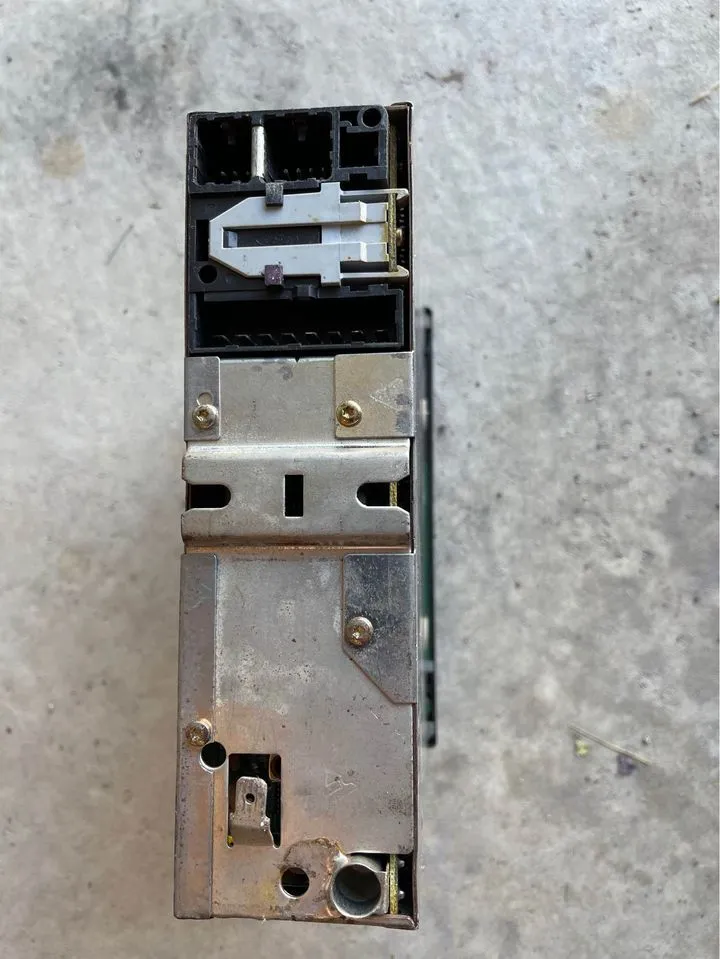

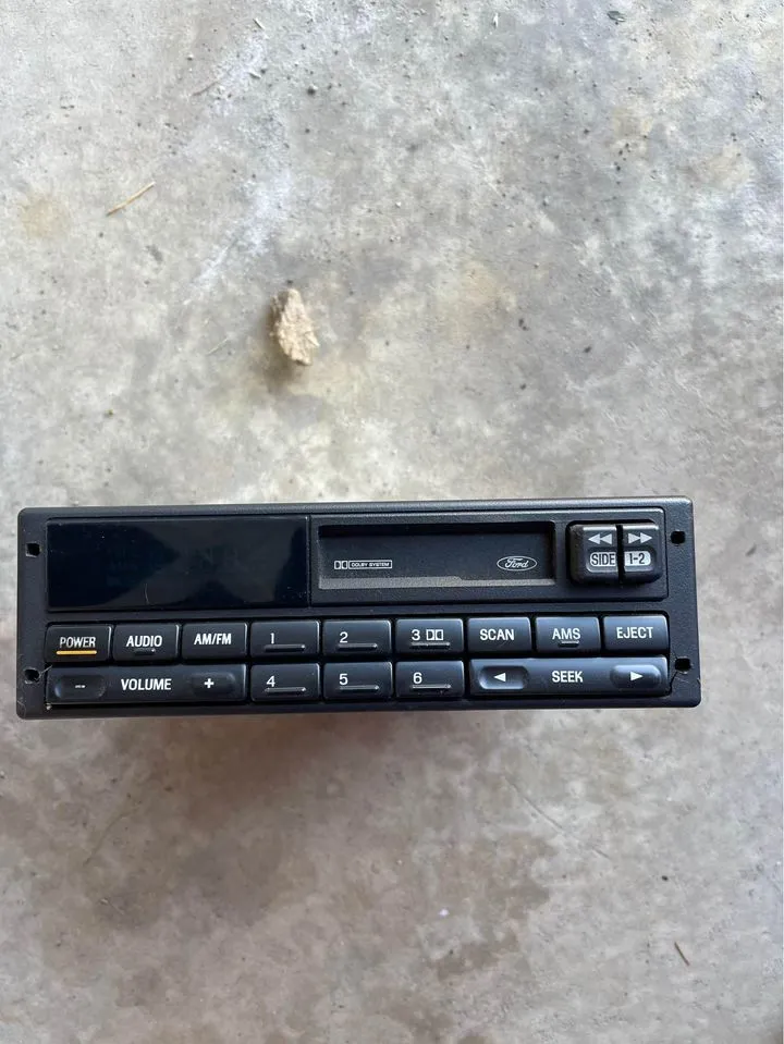

The amp in a 1990 is behind the radio.
Let’s take a step back here. Do you have a photo of the radio you want to use? Do you have a pic of the reverse where the plugs go? Would like to see if it’s a premium or non-premium head unit.

Here it is

So that is a premium head unit.
You do need the 1993 amp system to use that radio, in addition to swapping the face place and tray.
It’s also missing the shorting plug on the back, so it won’t work without it. (Post 6 in the link above)
