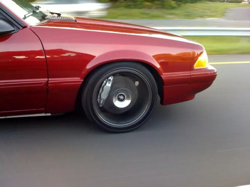

Guys, sorry for such a long wait on any updates but it's been very crazy with work and all. Unfortunatly I only have one pic right now of the front while driving but I'll get some more up this weekend of the rears as well.
BTW the cobra brembo kit doesn't hold a candle to these. This thing STOPS on a dime!
We ended up using a 93 cobra master cylinder and a manual proportioning valve.
I want to hear your thoughts....
-John

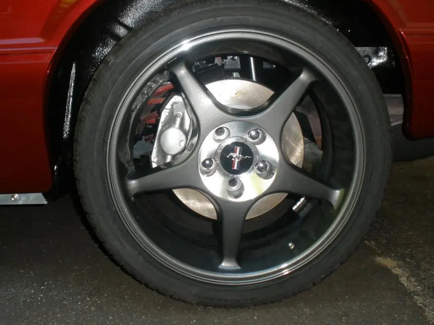

If fellow stangers are interested I might offer a spindle exchange program. The rears are very very simple as well and these are the specs:
05 Mustang Rotors (12.25" dia. x .75 thk.)
Set of Mitsu-EVO or STI rear Calipers
Set of custom caliper brackets
As far as the wheels, there is no need for a different backspacing or anything like that. I didn't try 17" rims but those should fit as that's what comes with the STI. The rims we used are 18" Cobra Y2K's.
The hoses were rather simple and all in all I think this setup is very easily done on a budget.

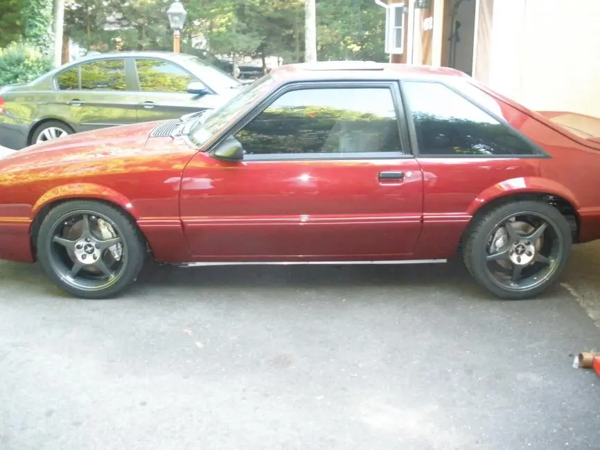

I found a couple rough pics of the car that show the rear setup. Does anyone spot anything else unique about the rear setup????:D:shrug:
Keep the comments coming...
-John
