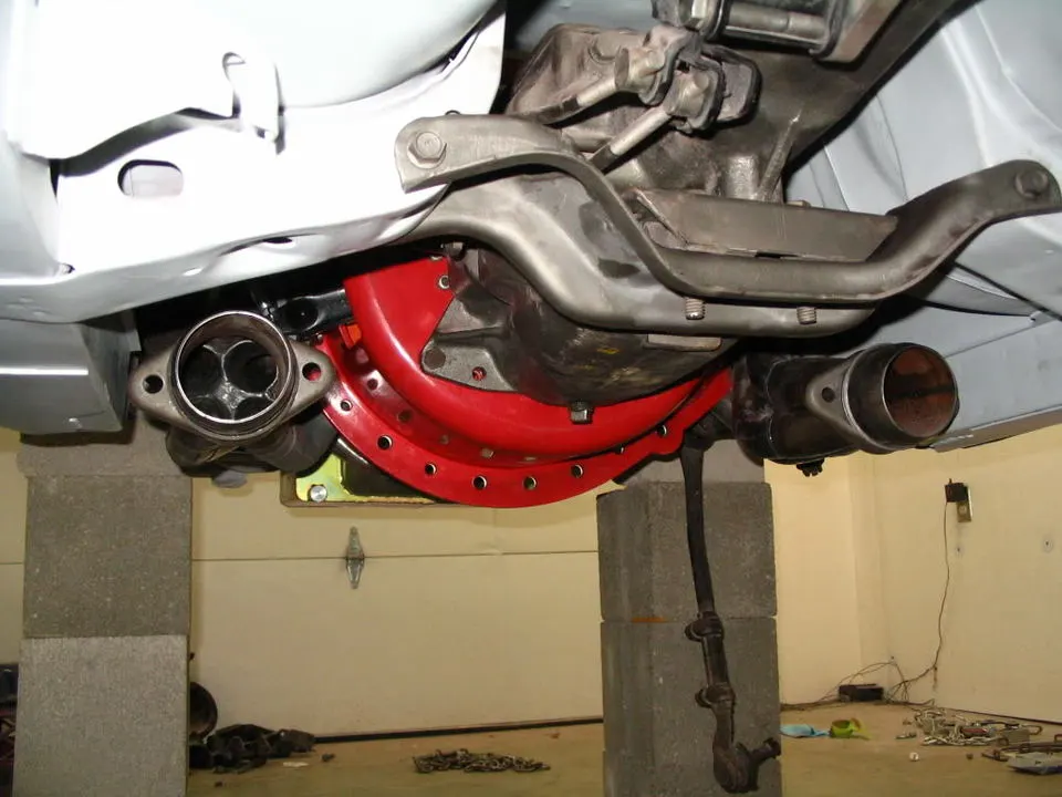

I can start off - no pics with headers, because the headers were never installed, but Hedman 88300 with McLeod 8660 Scattershield from Modern Driveline - do NOT fit. The Steeroids rack and pinion I am using is not the issue, it's the scattershield where a clutch cable goes in. Here's a pic of the space - the lower area where the two #5 and #6 tubes would go is obstructed by the scattershield.
It seems that for this setup, and cable clutches in general, a great shorty header that would work would be the JBA 1650S for regular heads or the 1650S-2 for GT40P or P-Head engines:

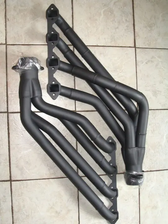

FPA Stepped Long Tubes (1 5/8" to 1 3/4")
FordPowertrain.com (they don't have a part number, but it is indicated on the webpage)
i had them coated "Cast Iron" by a different company after fitment.
-excellent clearance to the body.
-these are not designed to fit a car with HP heads. i believe they would have fit well in a car without these heads. one tube was hitting the oil pan side and rail. i'm certain it would have still hit on a car without the HP heads.
-there is no way these headers would clear a factory starter.
-i had to completely cut two primaries and make my own to clear the oil pan, bellhousing and some steering linkage. not sure i'm a fan of the ball and socket collector.
-i had to complete relocate the z-bar and linkage (again, probably due to the HP heads).
-in the end no dimples or crushed tubes.

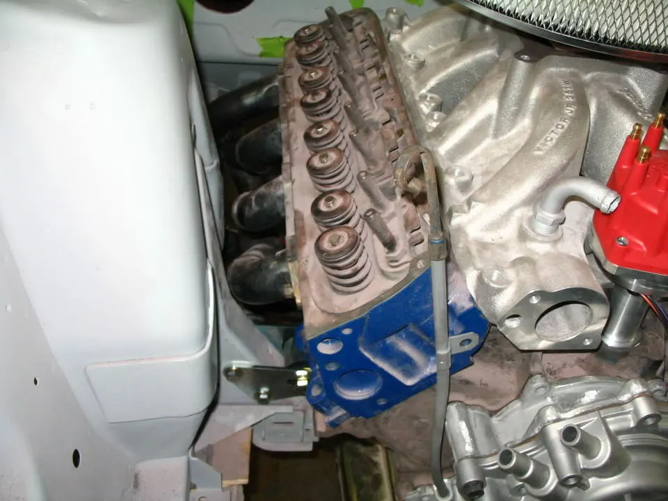

Here are those JBA 1650s on a '65, '66 motor mounts, stock steering
Here's a pic I've found of the 1650SJS on a '65 mustang, '66 motor mounts required for them to clear the shock tower, with stock steering:

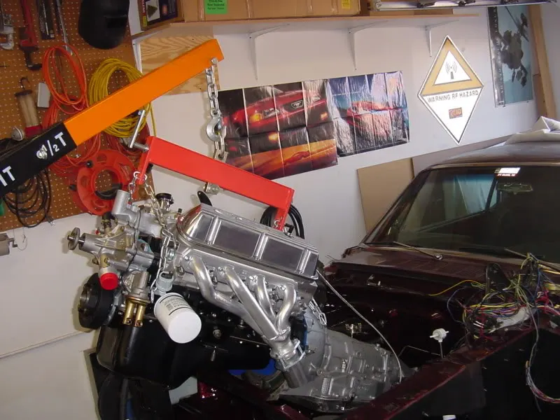

'65 Mustang, 5.0 w/AOD Transmission, Manual Steering, Stock Motor Mounts, Ron Morris AOD Crossmember.
Hedman Headers Elite Shortys, Part#: HED-88408, 1½” pri, 2½” cone out
I didn't want the hassle of possibly modifying long tube headers interfering with the wider AOD trans. I relocated the Park brake cable bracket a little outboard near the crossmember to clear the downpipe.
I was able to drop the motor in with them bolted on.
More pics here.

I have a late model 302 in my 65. It has Edelbrock aluminum heads. I also have a T5 with late model bellhousing and a MD clutch cable. I went with the JBA mid length 1650SJS headers, since long tubes don't clear the clutch cable. I have RMP adjustable motor mounts.
I had to clearance the corner of the steering box with a grinder.
The instructions that come with the headers say that installing a monte carlo bar is required.
I will add this though. I tried the JBA H pipe for these headers and it did not fit well at all. It did not clear the transmission crossmember. I ended up having an exhaust shop make one.
I would definitely buy the headers again, but not the H pipe.

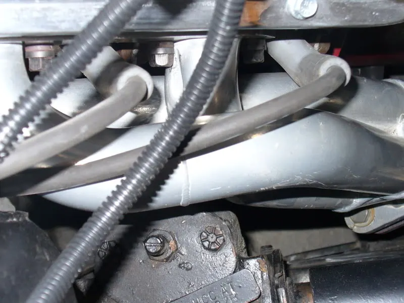

Here are some pics of the interference with the 1650S and Steeroids
The 1650S-2 pics are at the very top of this thread, and are what I have ordered and will get pics of in the next few days.
Here are pics of the interference with the 1650S and Steeroids rack steering shaft:

Here's the solution - JBA 1650S-2, higher and tighter
These are an absolutely perfect fit for my application. Couldn't be happier. Just sent them out to get Jet Hot coated.
