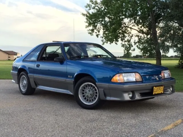

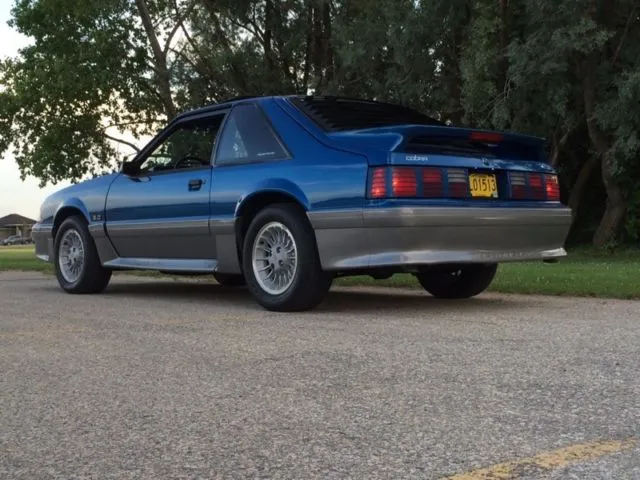

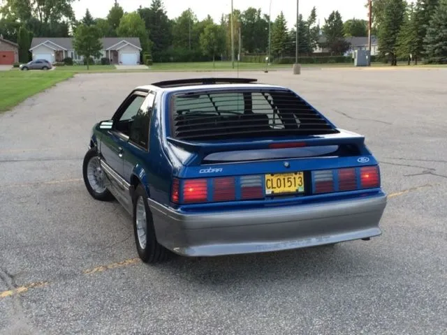

Pics of said suspension components and ride height?

Thanks guys, at first I was thinking struts but then the more I though about it the more that didn't seem right unless they were bottomed out or something but the ride height appears right to me. I was thinking springs but didn't think they did anything other than got softer over time so that didn't make sense either but if they can stiffen up after sitting that makes sense. This car has done a lot of sitting over it's lifetime. I have a couple pics of the car sitting, the height looks consistent front to back. I don't have any of the suspension yet. I will have to get the wheels off for that.

Good looking car, stock height.
Mine does not move much, rides good, corners really well and is also stock height.
As long as it don't thump or bang you're likely good.

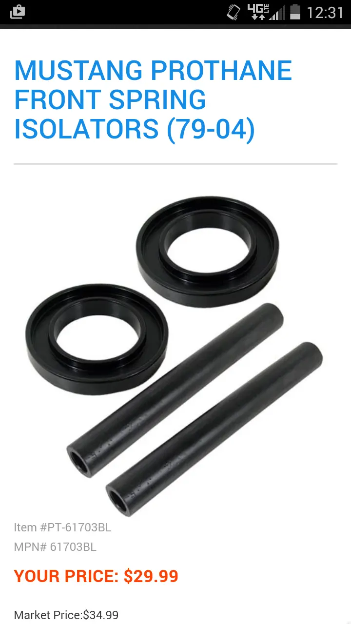

Is there anything else I will need to replace in the way of bushings or spring seats, that type of thing? The springs and struts I am thinking of getting don't appear to come with anything.

Its a good idea to get spring isolators...the rubber that goes at the top and bottom of the springs.

Thanks, I will try to find those locally, I already placed the order for the springs and struts last night trying to get them here for the long weekend.

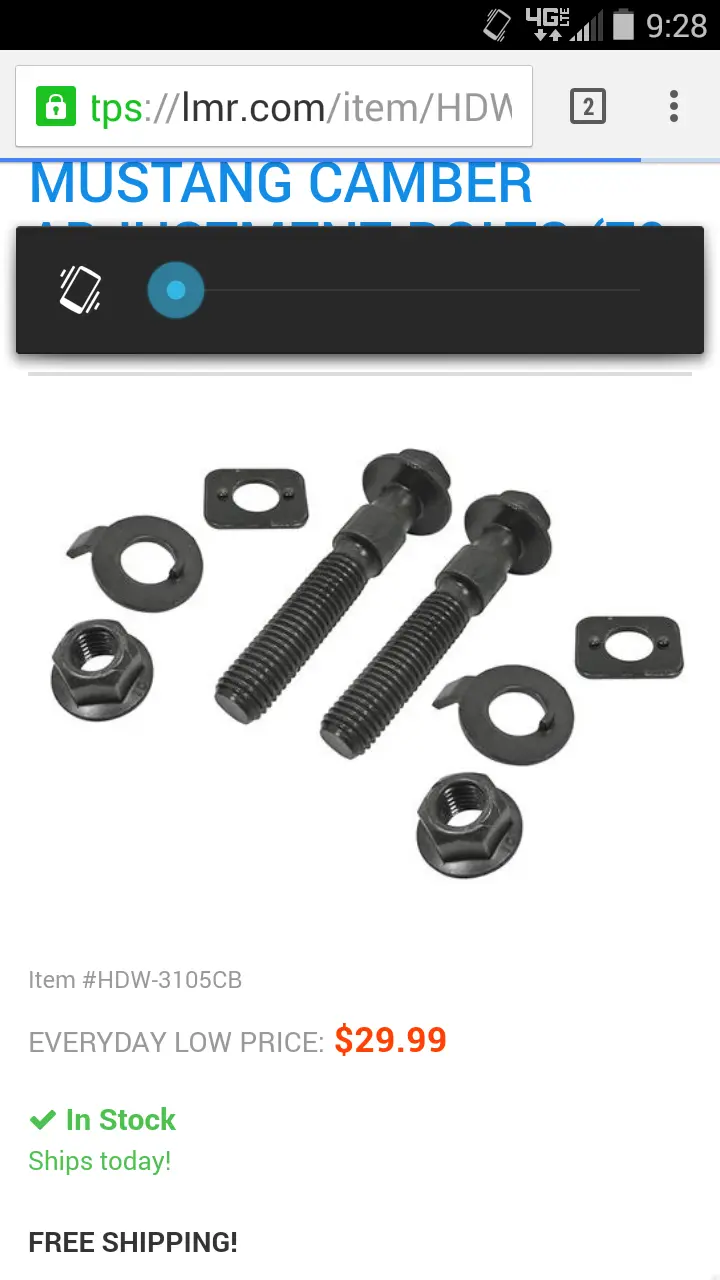

An alignment will be necessary afterwards. They sell camber bolts that take the place of one of the strut bolts on each side. With camber bolts you'll be able to dial in the camber if needed. Most of the time it only takes drilling a rivet out on the top strut plate and moving it a tad.

Ok, I think I have an alignment place that is about 5 minutes from my house so that will be fine. If I recall you can mark where the old strut was positioned before you take it off which will let you put the new one as close as possible to get it to a shop after.
