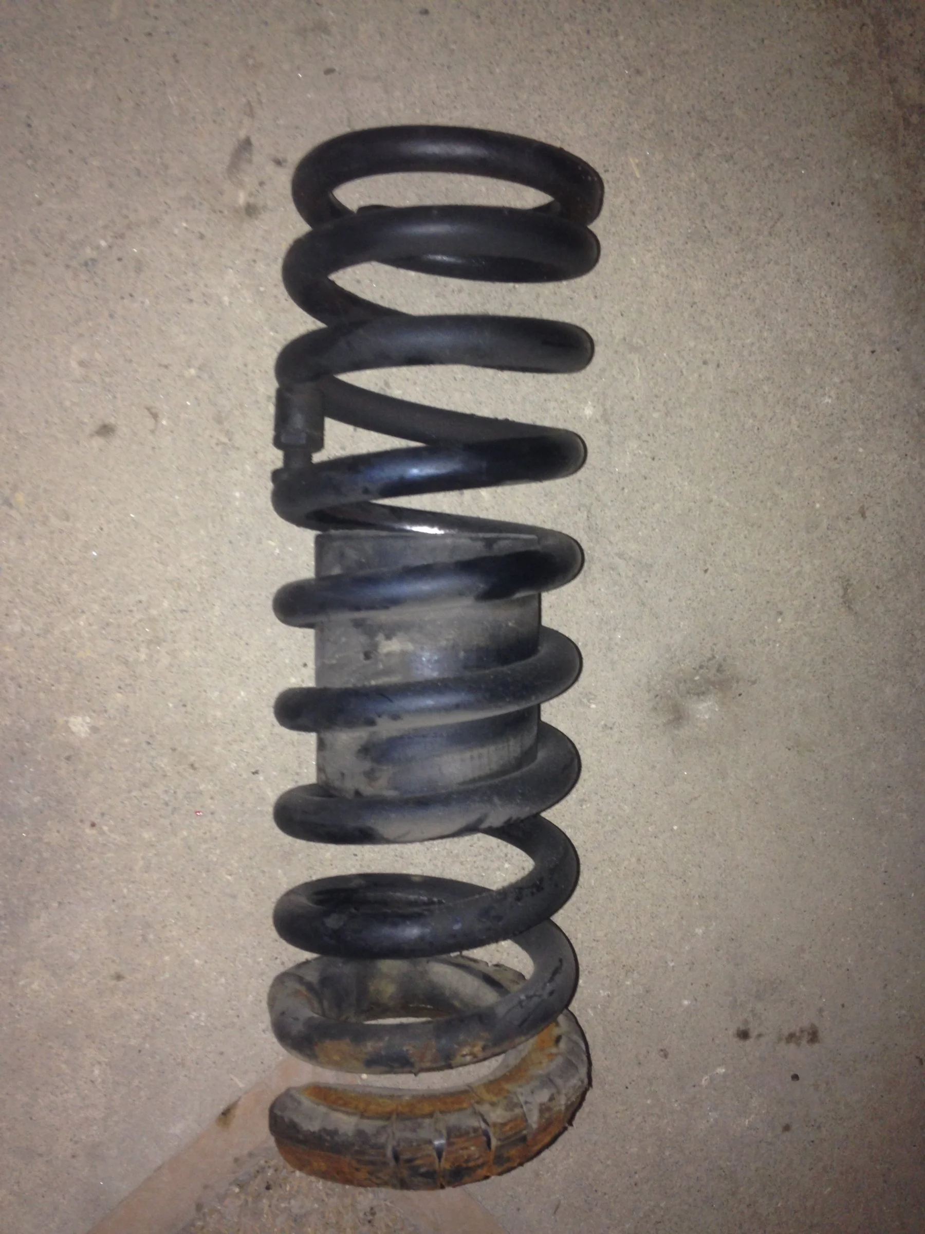

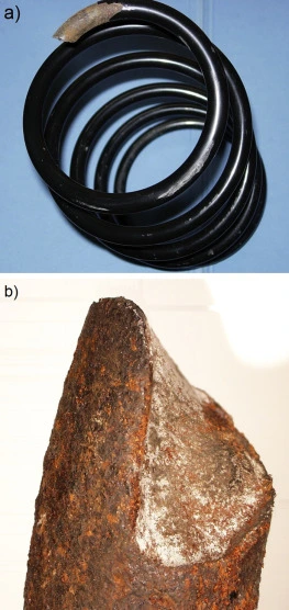

@MFE92 I stand kind of corrected. I did research and found this...
That spring broke from rust... It caused very small fractures in the silicone mixed spring steel
That caused the spring to break. The break shortened the spring...which caused the stiffer ride. As a spring shortens its rate goes up disproportionate to the length cut. 1/3 cut off a spring doesn't decrease the spring rate but increases it.
This spring wasn't damage molecularly by the rust in the unbroken section.
Rust only increases the ability for the surface cracks to penetrate and compromise the spring. You would think the spring would get softer as the surface cracks reduced the diameter of the spring.
I've witnessed several cars that rode harsh...good bushings and all. On my car ( 67 Buick Electra ) I replaced the shocks but the harshness didn't go away until I changed the springs. Since then I always try to replace springs and shocks together on any car I work on if the customers budget allows.
Who knows what that car went through before I bought it.
Just wanted to share what I found out. It could very well be another reason for the harsh ride. I could be wrong ( wouldn't be the first time )
Its kinda like the old tale of valve springs getting weak from sitting...but folks fire them up after sitting several decades with no problems.
I'm at a loss on this issue....but I definetly don't want to pass along bad info.
I was an engineering major in college....but jeesh that was a long time ago

Cool information. I will report back what I find once the parts have been changed. I think a broken spring would be doubtful unless both broke in the same spot on both sides because the harshness it consistent on both sides. I assume there would be a lot more noise if a spring or two was broken too. If they have somehow stiffened up or frozen in a compressed position from sitting for so long I assume it will be a lot shorter than the new spring. I will post a side by side picture of it vs the new spring if there is anything noticeably off with it. If the strut seems really stuck or stiff I will report that too. I am confident it is one of the two but if I find something really odd with the ball joints or control arm bushings I will let you guys know about that too.

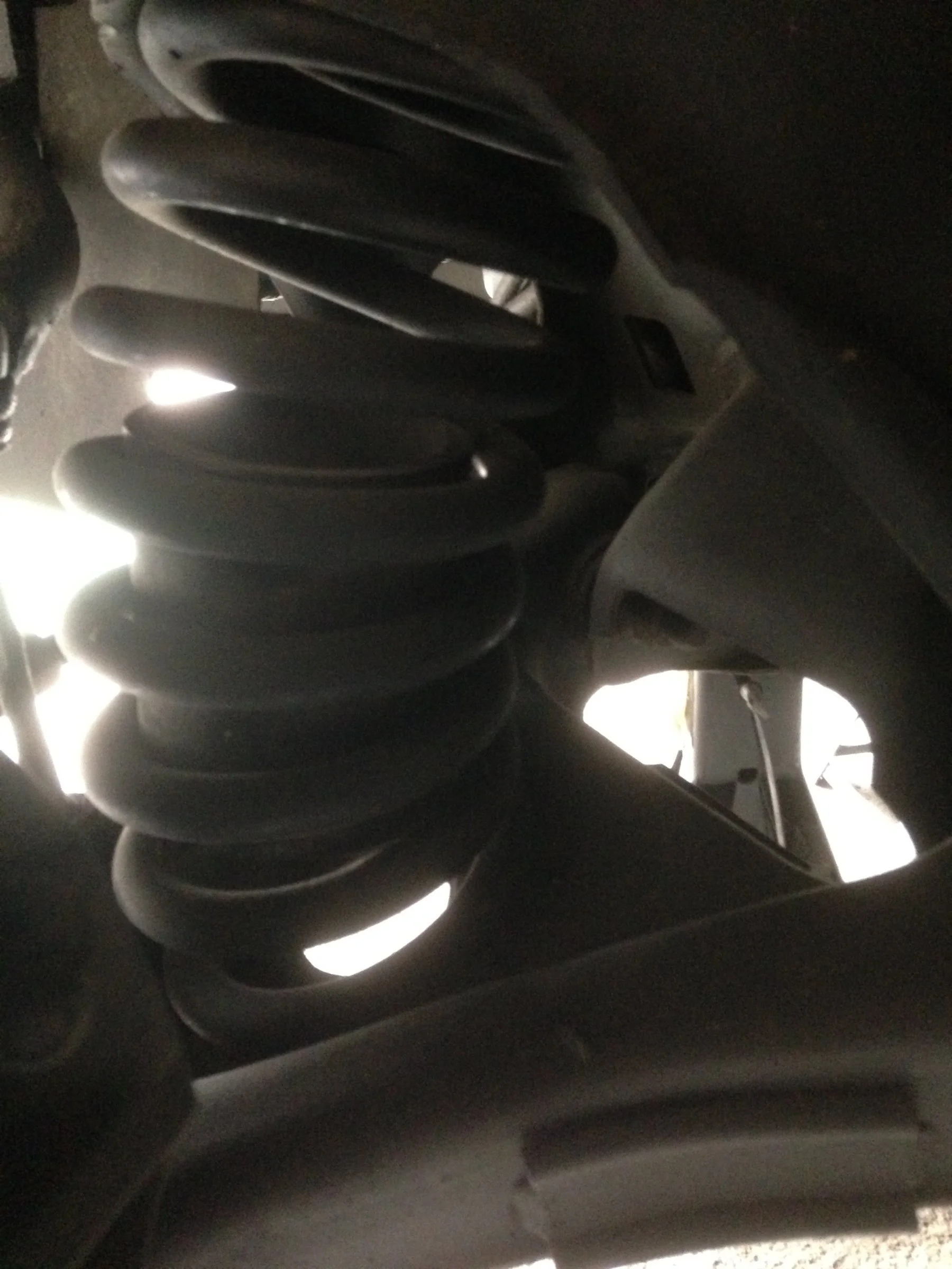

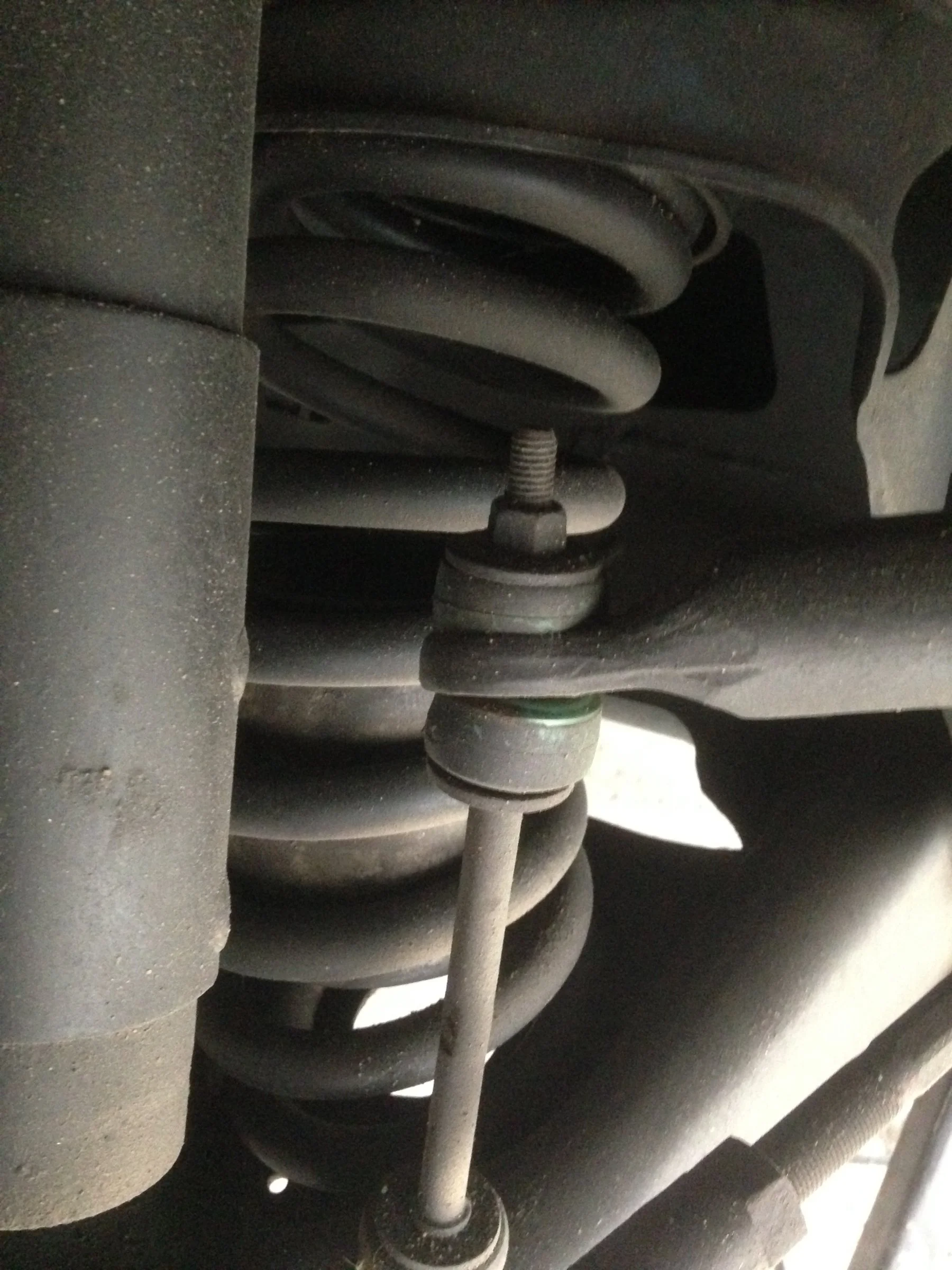

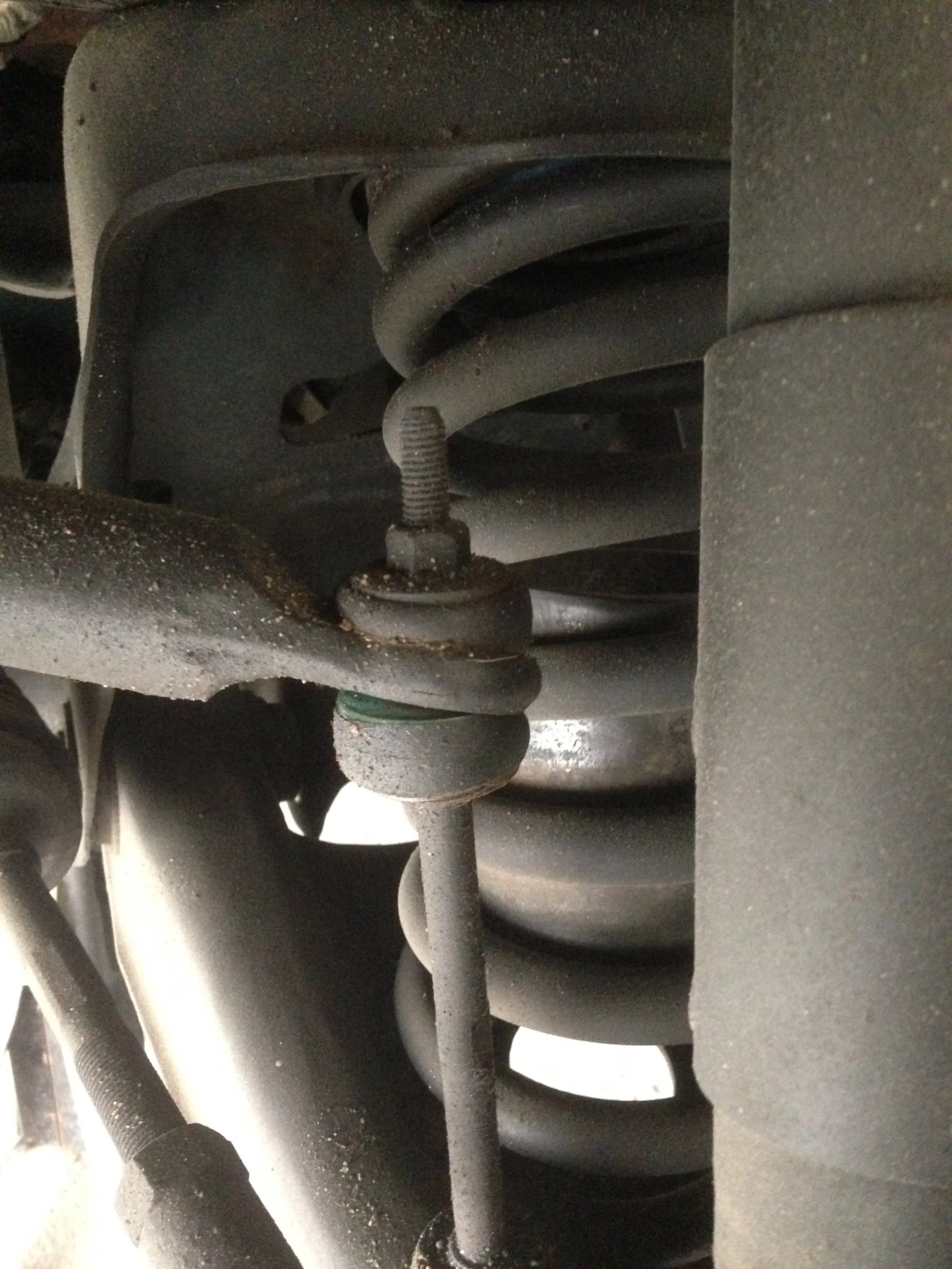

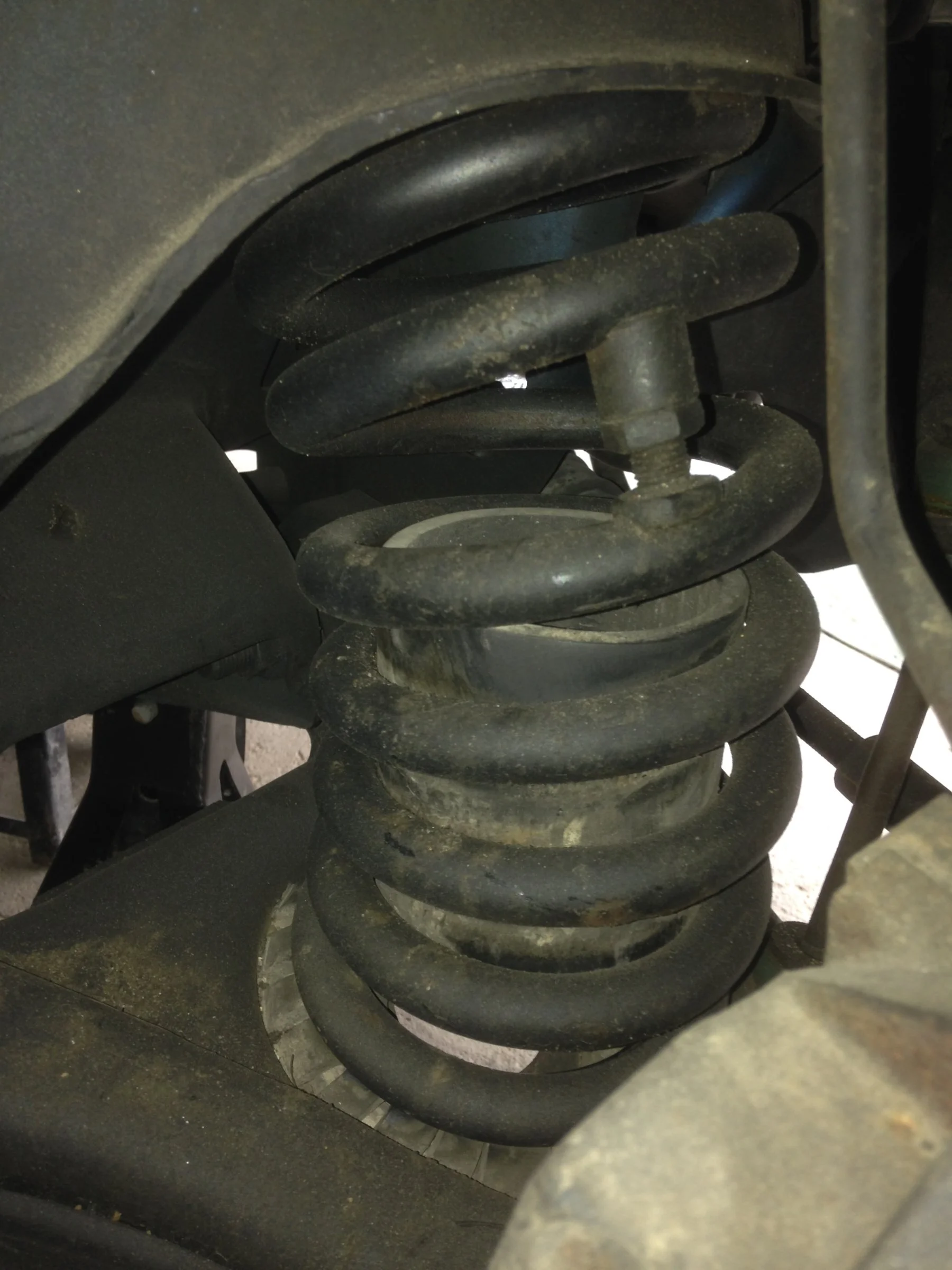

Hi guys. I have the new springs, struts and ball joints. I got the car up in the air and wheels off. Then I noticed a couple things that seem strange, at least to me. There seems to be something in the spring. It is soft and just sort of in there. I wasn't too worried about what that was, but then the second thing I noticed has me confused. It is only on the passenger side and it looks like some sort of threaded connection between two of the coils. I tried to get a picture of it as best I could.
Is this normal and stock, and if so what is the purpose? It is in the third picture

The little rubber "bag" in the spring is just there to reduce NVH from what I've heard and you don't need to worry about reusing it.
I see the other thing you are talking about and have no clue what that is. Looks like something you would use to jack a truck up. Definitely could make it ride like crap.

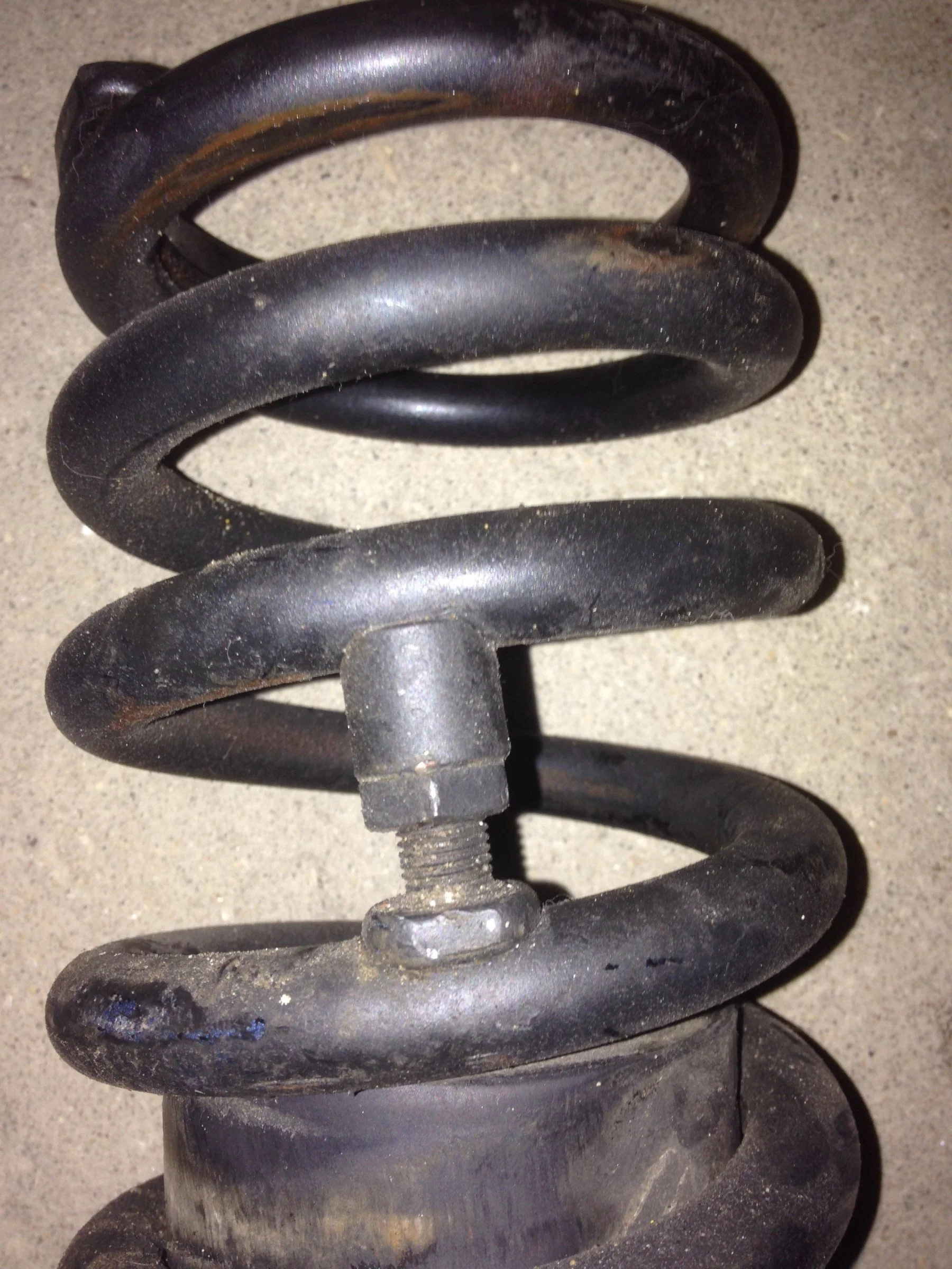

That's an old style spring spacer...used to raise the suspension. I haven't seen those in a long long time.
That would cause some harsh riding for sure. It'll also making the car feel unstable with it being on only one side.
The rubber round piece inside the spring is factory...should be in both sides. Doesn't really make a difference if removed though.

Ok, good to know. Strange that this spacer thing is on the car at all, especially only on one side. If it isn't supposed to be there then I will get them out and not worry about it. But before I can even get there I have to get the stubborn bolt of the top of the strut. It looks like there is a notch in the top to stop it from spinning while you wrench it off but I'm not having much luck. I worry about cranking on it too hard. It feels like I am going to rip the rubber piece in there.

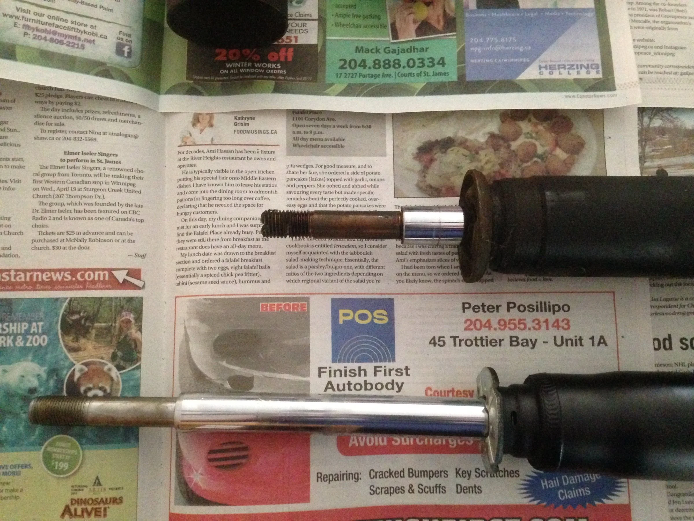

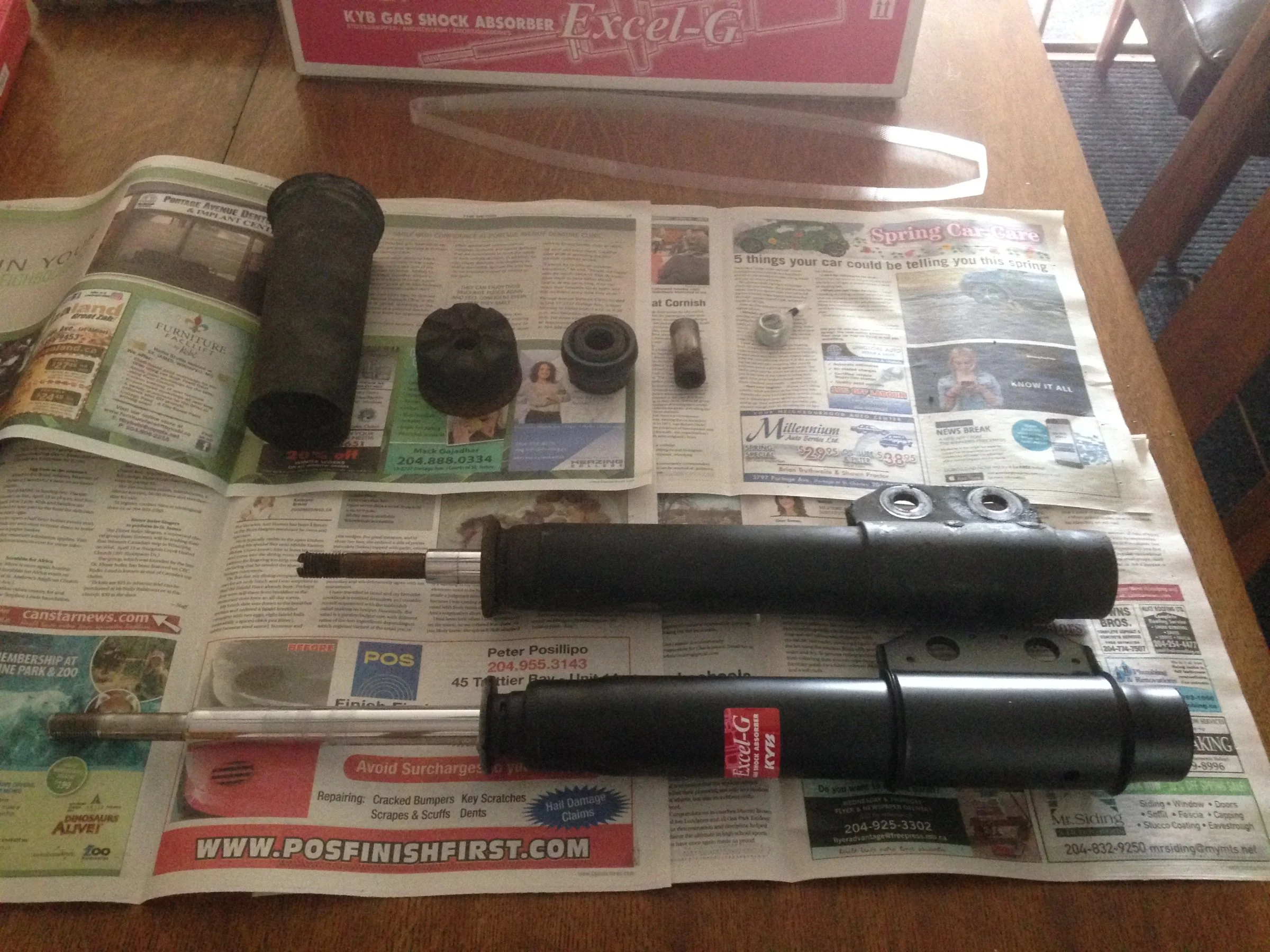

Well, I got the first strut out and I think it is dead, lol. I pushed it down to see how long it took to come back up and how freely it moved. It isn't seized and did move, it just never came back up. It came back slowly about a half inch, then just stopped. So I think this combined with the strange spring situation is likely what was causing such a harsh ride. I am looking forward to the test drive after the new ball joints, springs and struts, it is probably going to feel like a new car.

To keep from spinning the old struts you can put a pair of five grips on the shaft. Don't do that with the new ones unless its way near the top. If you put grooves in the shaft it'll eat the rubber seal in the strut.
Your ride is going to be 10 times better.

Between that spring spacer and the blown struts, car should ride much better

I finally got the car out today to see how it drives after all the work. It is so smooth now! Just what I was looking for. I after fighting with the spring to get them out, I thought installing them would be easier - not even close. Even with the terrible roads we have here I was wishing I had just got the lowering springs. Same for the ball joint. I had the press and thought that would be easy but it kept going in at an angle.
Now that it is all done and has the feel I was looking for it was all worth it, but during the time of handling loaded springs and wrestling them into place it sure didn't seem like it would be, lol.
I do think that the springs stiffened over time. Blown struts like it had I don't think would have made it ride like it did. Other cars I had with bad struts or shocks was really bouncy because you are basically riding on springs, but this felt like a rock solid link between the wheel and car. I'm sure that weird spacer thing that was put in on the passenger side didn't help anything either, speaking of which, here are a couple more pictures of it out of the car. I have never seen anything like it, but I assume it was some home made adjustment, just not sure why you would only do it to one side. In the second picture you can see that it sort of makes the spring bow out a bit so it was for sure applying constant pressure.
