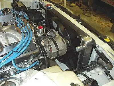

A Mark VIII, Ramcharger, or large Spal fan electric fan. This way you can have FULL cooling when you need it. My new 393 stroker has never been up to the N in Normal yet. I will raise the fan cut in temp to 180, once it has about 500 miles on it. Running 160 Tstat and 170 fan cut in during breakin.

wow thats really nice man...i dont have the money for electric and and the new alternator tho...i just alot on the hd clutch and blade!! EVERYONE told me it moves ALOT more air when its fresh...so i dunno...it even feels like it does up front...i just dont understand why the temp is raising so much..
