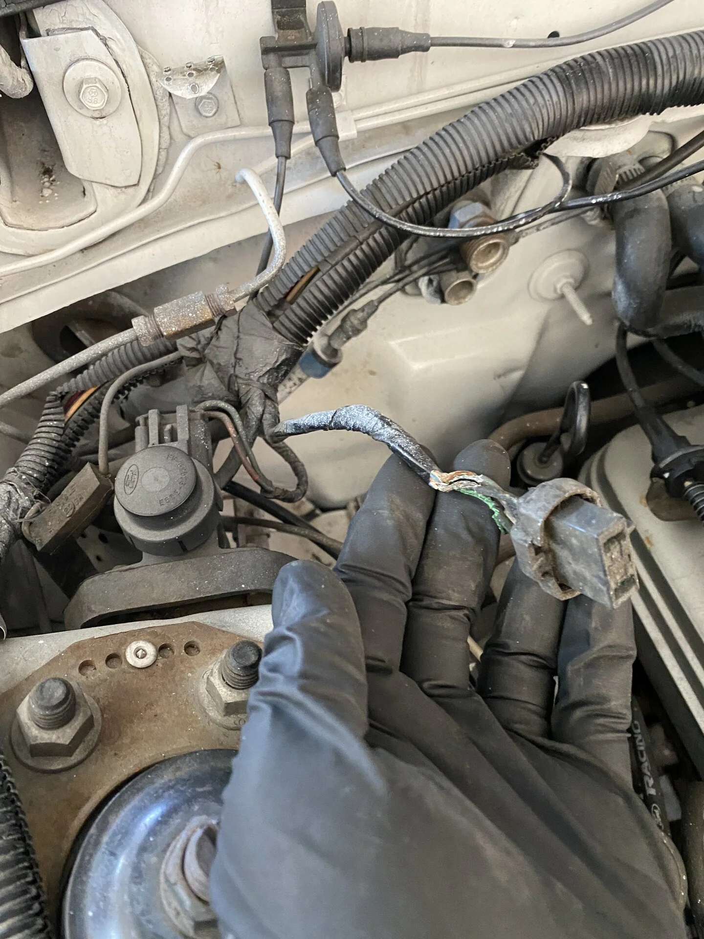

Ok pulled koeo codes and got a 85. I need to replace the entire canister as this one is 1/2 hooked up and looks in pretty bad shape. There is no return nor purge valve. Should I ignore it for now? Also since there is no valve there is no wiring. I attached a picture of a connector, is this the connector for the valve? Disregard that the wires are missing shielding, I’m going to fix that also.

85 - (O) Canister Purge Solenoid failure (Doesn't have one so nothing I can do at this time. Will it be ok without?)

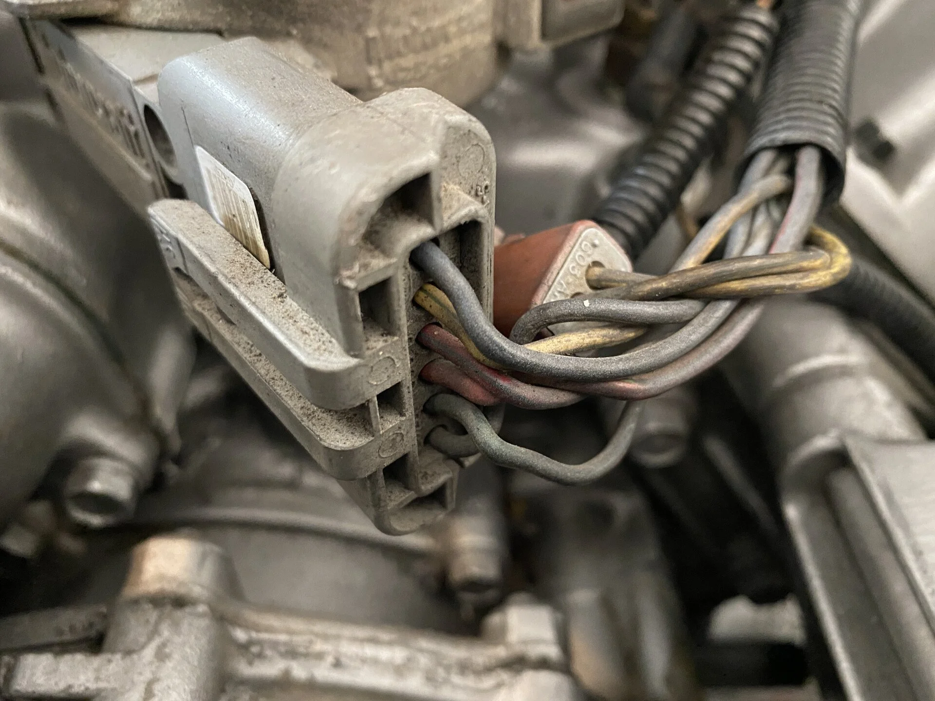

Disclaimer ; this is ( if ) the wiring to and from the distributor is in good condition. Meaning no bare wires and securely connected to the TFI. These cars are getting old.

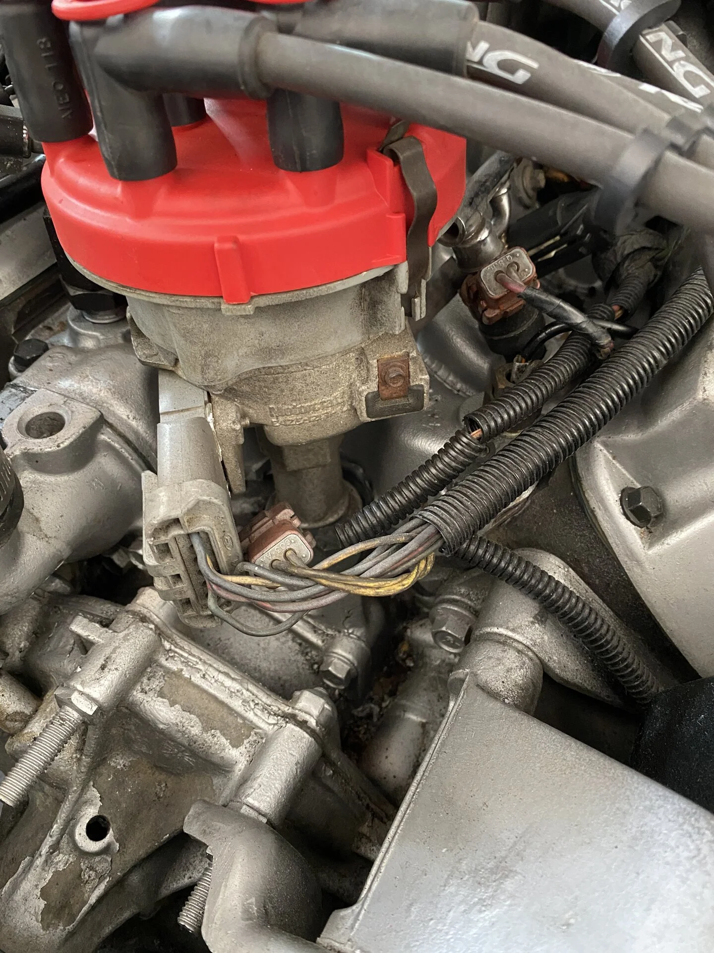

Take a few pictures from different angles all around the engine bay. People here have hawk eyes ( me not included ) and can help see things you may not notice.

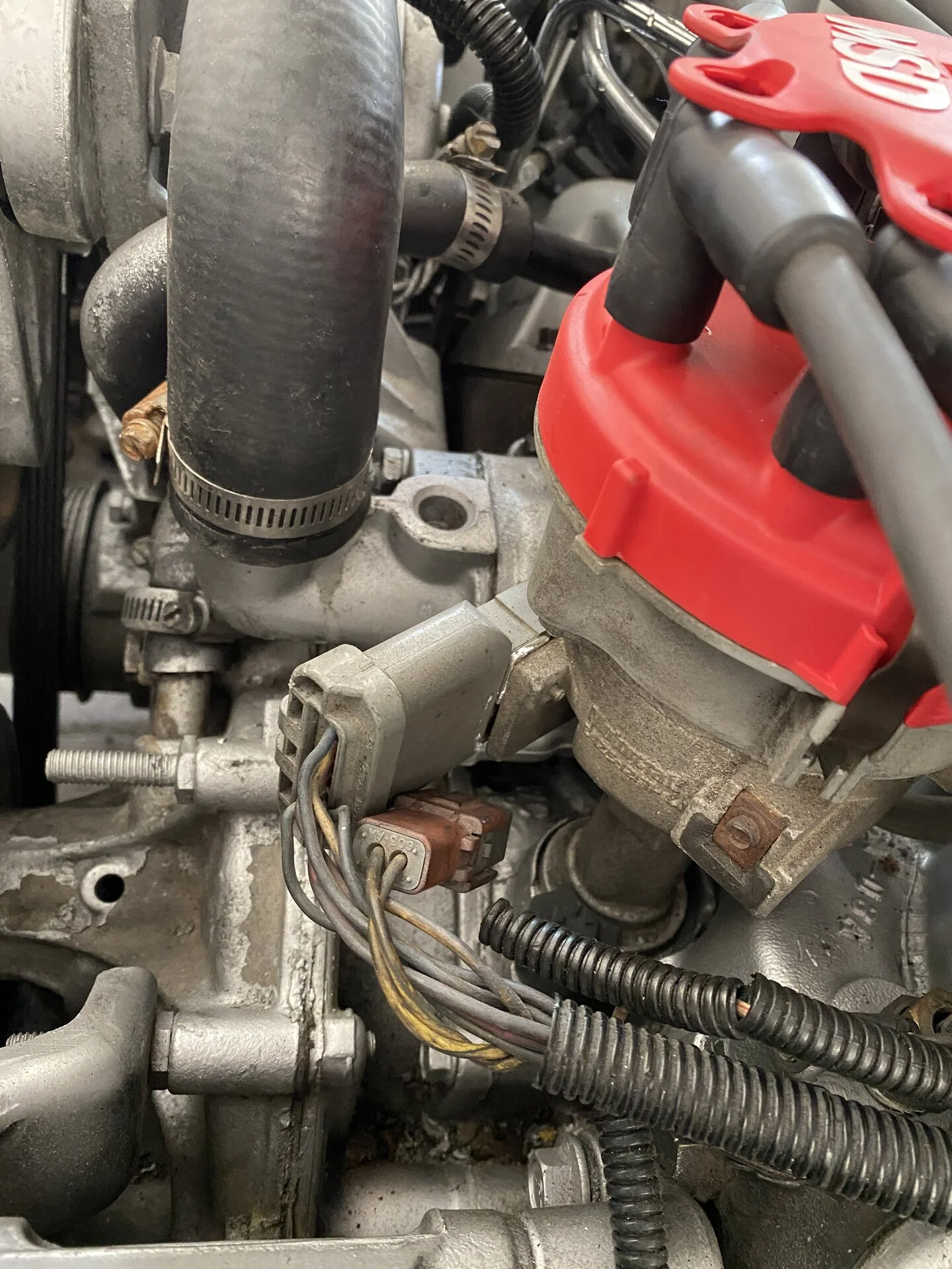

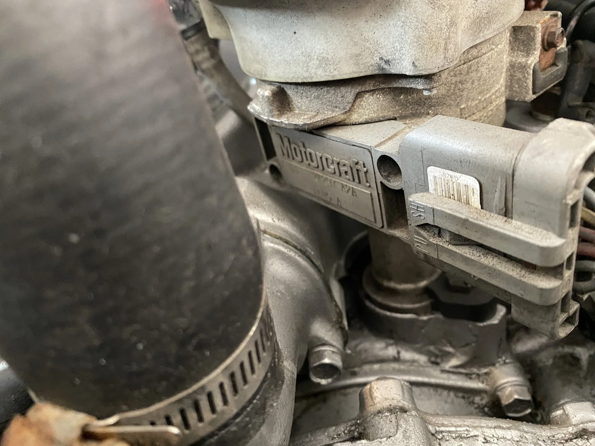

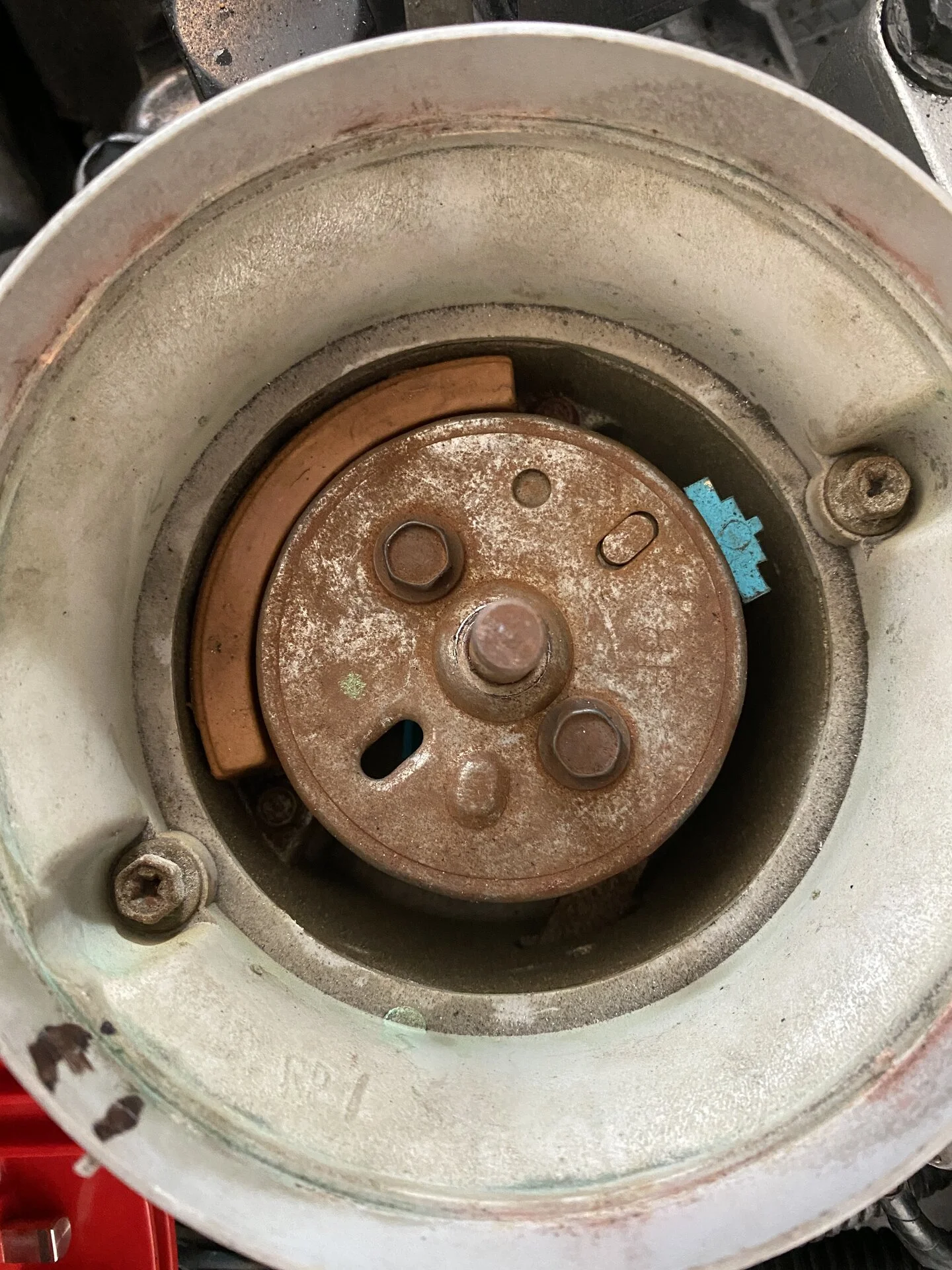

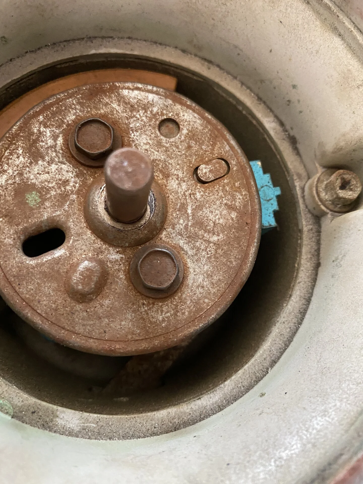

Here are some picture of the distributor. Upon further inspection I think I’m just going to replace it, it looks old if not original lol. Sucks that I just replaced the cap and rotor. Didn’t even think to look at the tfi or anything else. The wires do look good tho. Let me know if y’all see something I don’t.
And thanks for the help! This is my first restoration and have never really gone deeper than a standard tune up on a car so I’m still learning.
I've always had the best luck replacing ignition parts with genuine Motorcraft parts, especially TFIs.
If it were me I would pull that factory distributor , replace the guts with Motorcraft parts and reinstall.
You could have a local shop press off / on the gear for you , there is a roll pin that needs to be removed
and reinstalled as well.
I've gotten all the parts in the past from rock auto.
These cars tend to not like aftermarket ignition parts in my experience.
Just to add , that rusty disc in your pictures with the tabs hanging off it is you're shutter wheel.
When I built my 393w I had to run a non-oem distributor, I replaced all the internals with Motorcraft parts
except the shutter wheel.
I chased a intermittent miss for months only to find out it was being caused by the aftermarket shutter wheel.
Turns out the aftermarket shutter had tabs and spacing slightly different from factory , enough to create an issue.

So you got me thinking tonight. I switched back to the stock distributor cap and rotor just to test it. I researched issues with the 5.0 and MSD and found a ton of problems. I'll take her for a spin tomorrow. If it works, it works; if not, what do you think is the best route? I can't find a full Motorcraft replacement but can find a Duralast, Accel, Spectra, or a Cardone rebuilt. I've never heard of the last 2. The Cardone says they are rebuilt using OEM specs, but I would still have to get a TFI separate. I've already called all of the salvage yards within 50 miles and they don't have any Foxbodys so there goes that idea.
