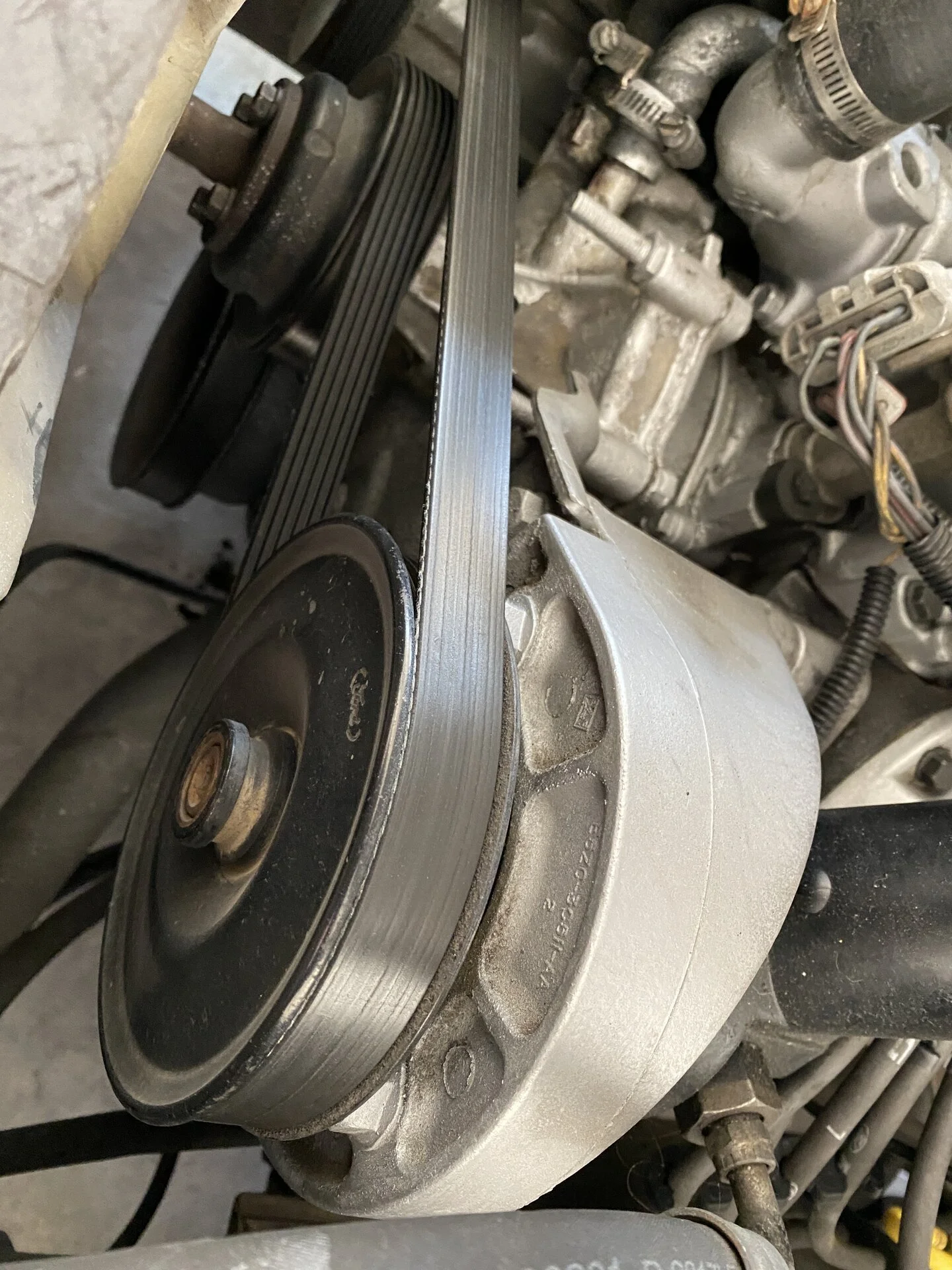

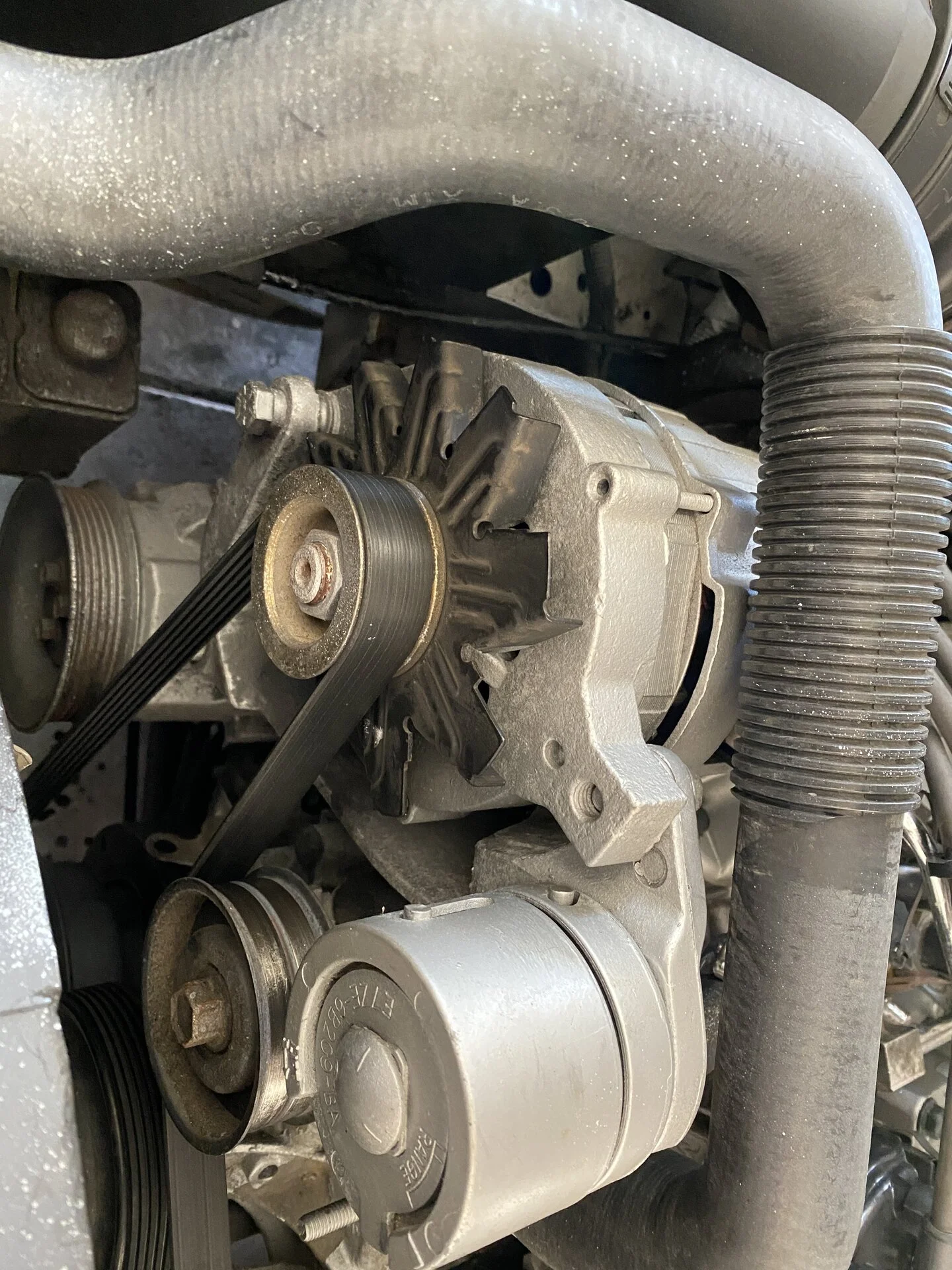

1) The belt has the Smog Pump bypassed and the A/C completely taken off. It's a bit odd because the setup looks like the factory setup without A/C saying that the power steering pump is up top, but I have A/C controls on the interior and the threaded nipples on the firewall. I'll post pictures of the belt routing so yall can see what I'm talking about.

That is a factory AC delete from Ford racing. It would be this kit that relocates the PS pump up higher
And your air pump is in place, so unless you are going to put cats back on the car at some point, that can all come off. It's not necessarily half-assed, as leaving it all plugged in like that is hurting nothing other than 5lbs of weight.

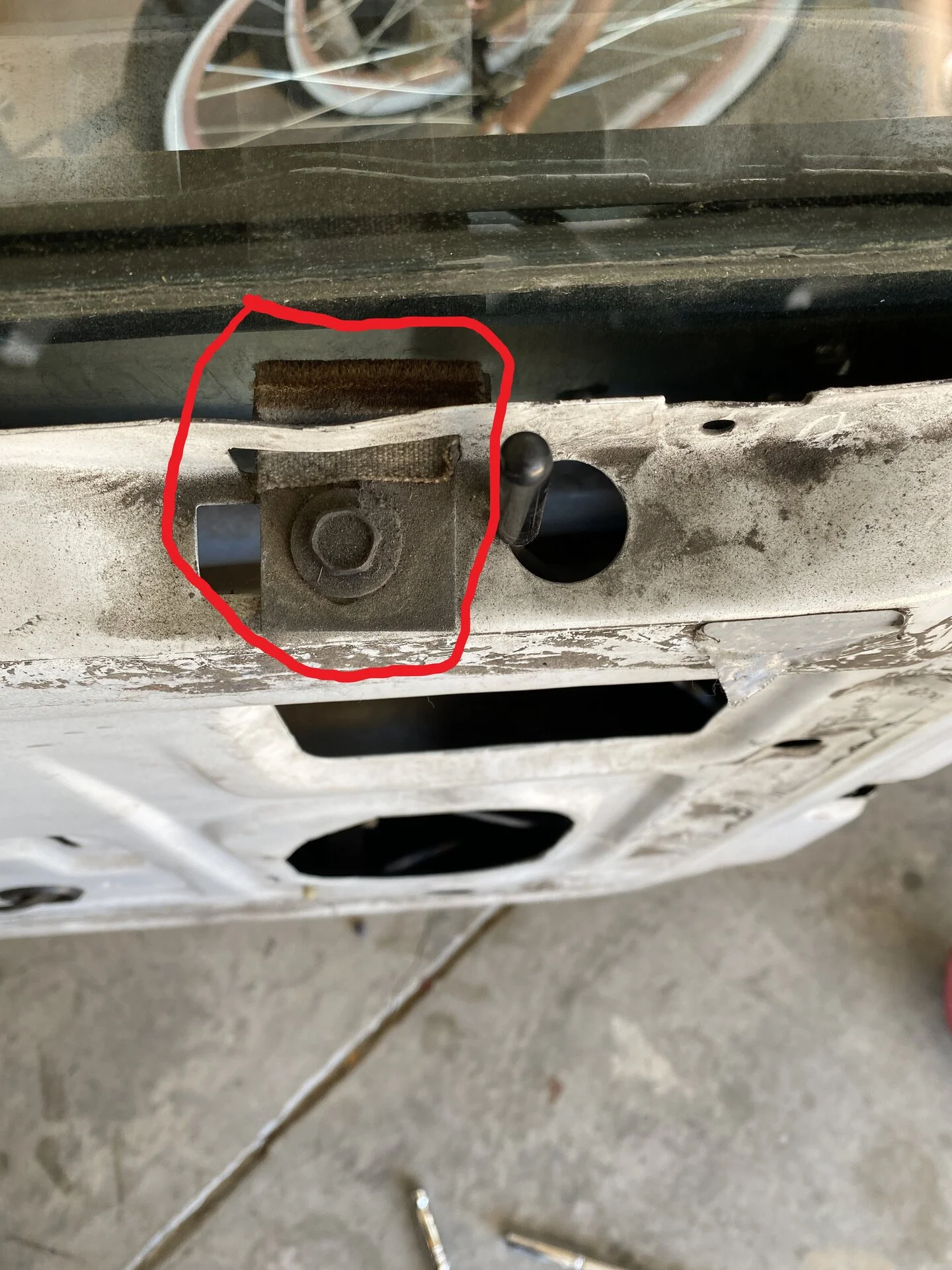

While replacing my mirrors I figured I would fix my window. My driver's side window is missing a part of the guide. I don't know what this is called and I can't find it on any of the restoration sites under windows or doors. The part I'm looking for is circled in red. The one on the driver's side is completely missing along with the bolt so I need to replace the whole thing. Please someone with a bit of experience chime in!
That piece I think is like a guide or anti rattle something or other, I'll look in my magic book later, it's a pretty standard piece not specific to mustangs, is there a salvage yard near you?.
Thanks! There is but they have to get the part themselves. Unfortunately, I don't have one within 50 miles that allows me to just pull what I want. Hopefully, I can find that part soon, running around in Alabama spring with no A/C and the windows up ain't good!
